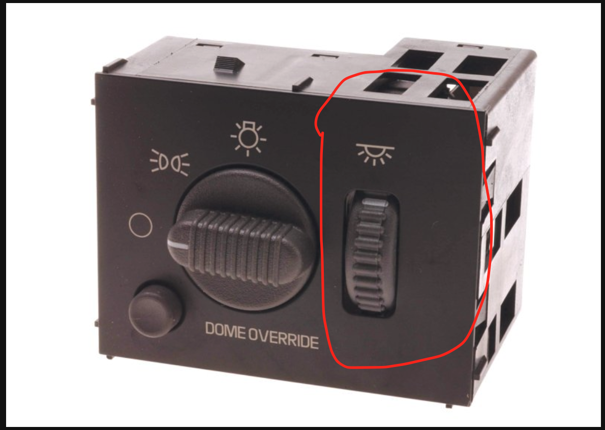

2002 Chevy Tahoe Z71. I just bought this SUV and noticed that the reading lights are out. I opened them up and no light bulbs. I replaced the bulbs and they lit up. It seemed to turn off and on using the button while the vehicle was in acc mode. Later I went somewhere and noticed that the lights stay on. I press the button and nothing. Has anyone run into this issue? It does turn off after a while when I shut off the truck.

Check the rotary dial on the dash to the left of the steering wheel. It may just be in the fully on position. Alternatively, it may have gone bad.

^^^ This first.
Or if they come on and stay on just when you shut off the truck, Retained Accessory Power (RAP) may be keeping them on. With the truck not running and the key out of the ignition, opening any door should turn off RAP. After closing the door the lights should extinguish within a minute.
Next time you go to shut it down leave/turn the radio on. Does the radio turn off when you open a door? If so, you're looking for a defective door latch, probably the driver's door.
