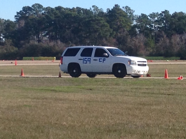

You can just see the two antennas on the roof of our Tahoe in this picture:
The truck had two plugged holes when we got it. Since they were cheap plastic plugs, I removed them and installed some stubby antennas. The one above the B-pillar is white, and the other one you can see if you follow the C-pillar up to the roof. It's black.
Yes, people do slow down when we pull onto the freeway.
the slowing down might be because of the markings? I plan on using a CB antenna in the rear, the other hole is plugged, but I am putting a "shark antenna on it. Probably with a GPS sensor in it or so, that way it finds GPS satelites easier.
I did notice driving mine that people are less likely to 'cut' in front of you or try to force themselves into your lane... maybe it is hard for them looking up to make eye contact or something like that *lol*

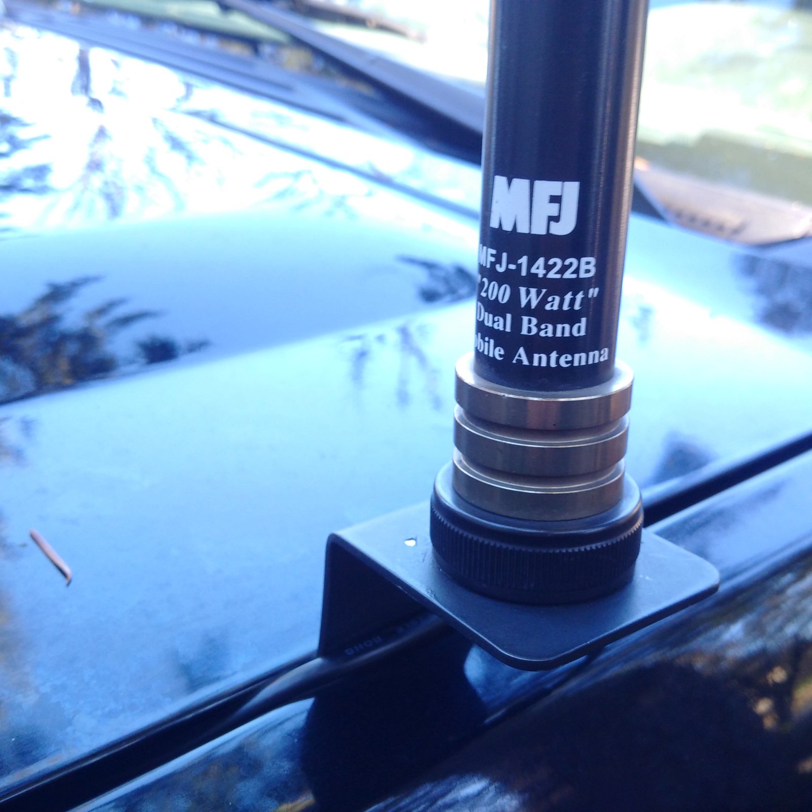

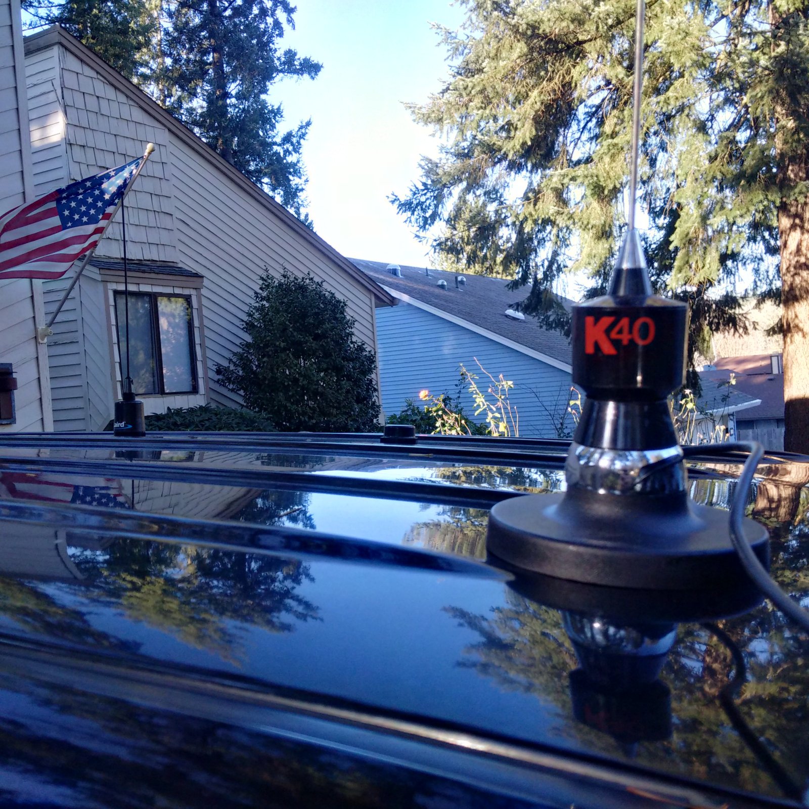

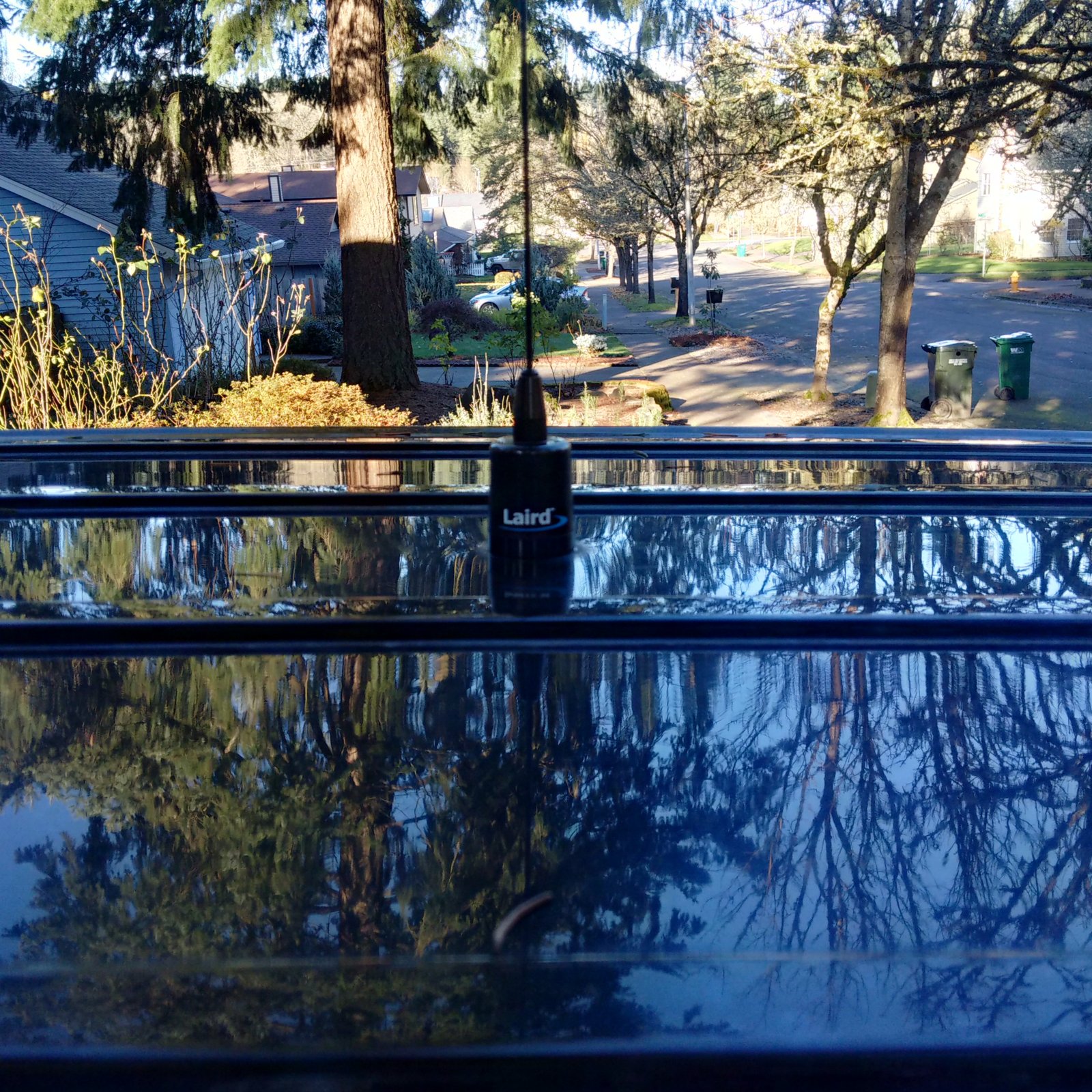

My K40 CB antenna. Laird GMRS antenna in the roof center and MFJ dual band on the fender.
View attachment 188240 View attachment 188241 View attachment 188242
Nice, I have seen that K40 antenna, I am looking at one like that. Looks like you'rs is a magnetic one? I want to use the hole in the roof and mount it there.

Yes, it's magnetic. I wouldn't mount the CB antenna to the roof though. Because of the length, if it hits something it can bend the roof metal and then you have another problem. If you want to cover the existing NMO mounts, you can get rain proof caps for them. They screw onto the NMO threads and make a tight seal. Cheap on ebay or at any ham or CB shop.
On that site I mentioned, further up, it says you can get a spring for avoiding exactly that problem. I would be a cleaner install though, run the coax and all that out of sight.
The markings are painters tape we used when auto crossing the truck at a local event. Otherwise the truck is all white. No idea WTF the picture is upside down on this forum. It’s okay on othe4 lists.
I don't see it upside down, on my computer it seems right.
If you decide to go that route, there are plenty of options with the mount. You can use a straight NMO mount and get a PL-259 adapter. Then just add your spring and antenna. To get the proper wave length antenna on the roof though it's going to be pretty long. The spring may be only so effective due to the total weight of the antenna set up. Unfortunately, these Tahoe bumpers aren't really set up to easily take an antenna mount. A 4' 1/4 wave firestick on the front fender or a 102" trailer hitch mounted antenna would be a better option. The roof isn't well suited for anything beyond HF or VHF antennas. But go crazy.

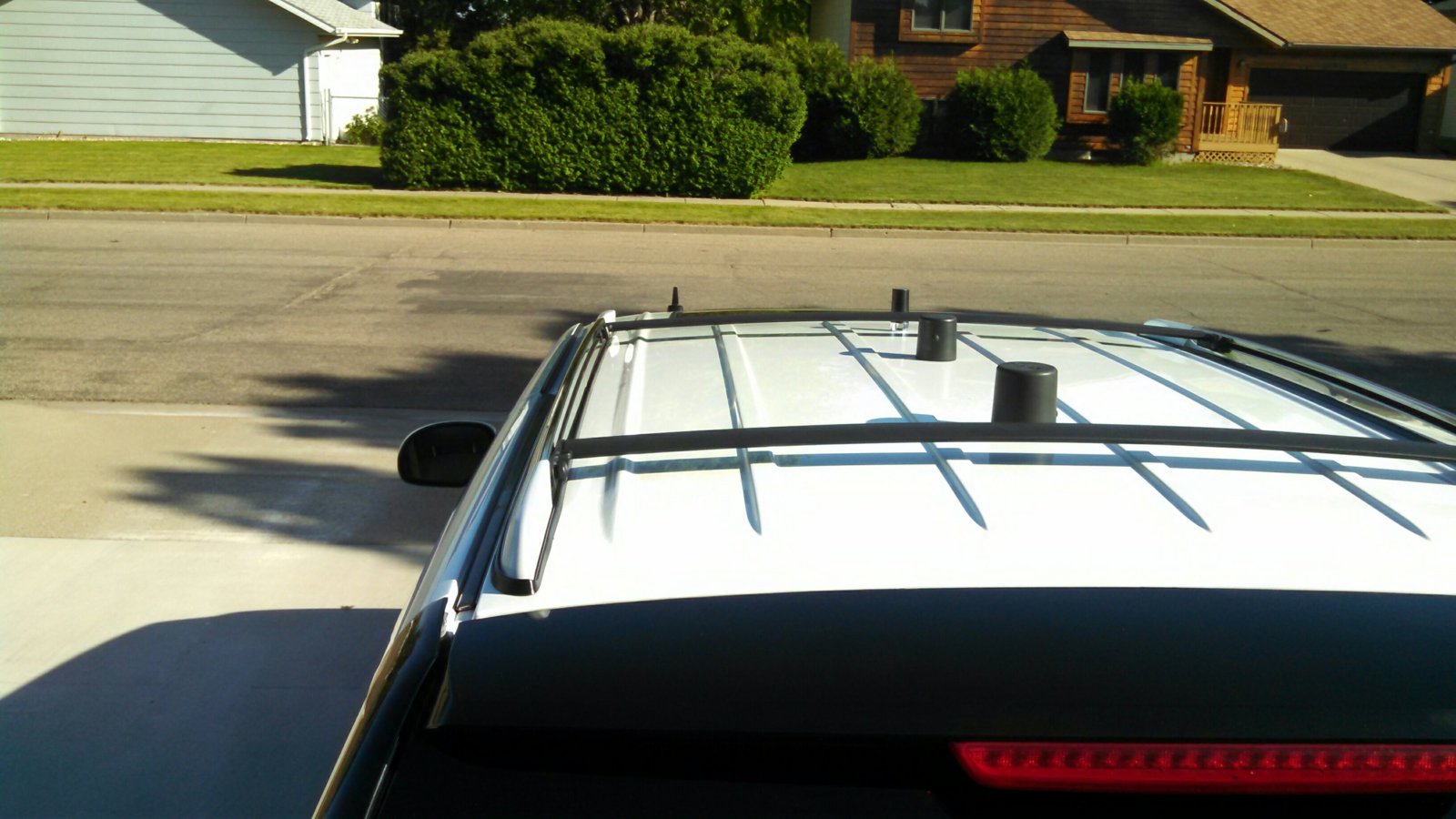

Here's the roof of my Yukon with the 3 low profile antenna installed. These allow me to go into the garage without making a racket and messing up the antennas.
The front one is a 430-450, the middle for 222 and the back is tunable from 140-160.
There a little pricey but work pretty well.

I have a Laird GMRS NMO on top. It performs quite well.
I like that Laird CB 27. 49" whip in your link. Did you put that on top or elsewhere?
