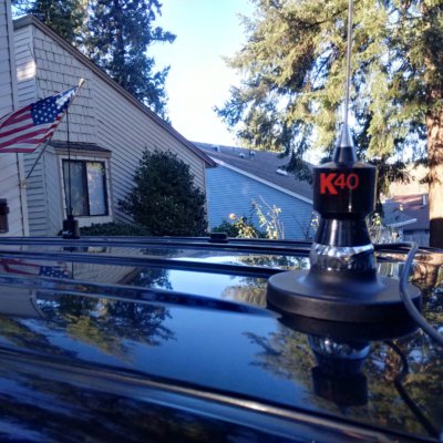

My CB is third on the list after my ham and GMRS. I use it occasionally so i didn't want a third permanently mounted antenna.
So I bought a K40 signal kicker magnetic mount which I just keep in the back. I ran the coax thru the rear side panel and under the seats to the front of the console. The K40 will put out like crazy with its 48" whip. Do a search. Wilson 1000 is similar and performs well also.
