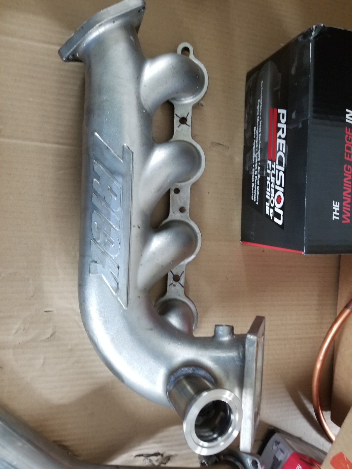

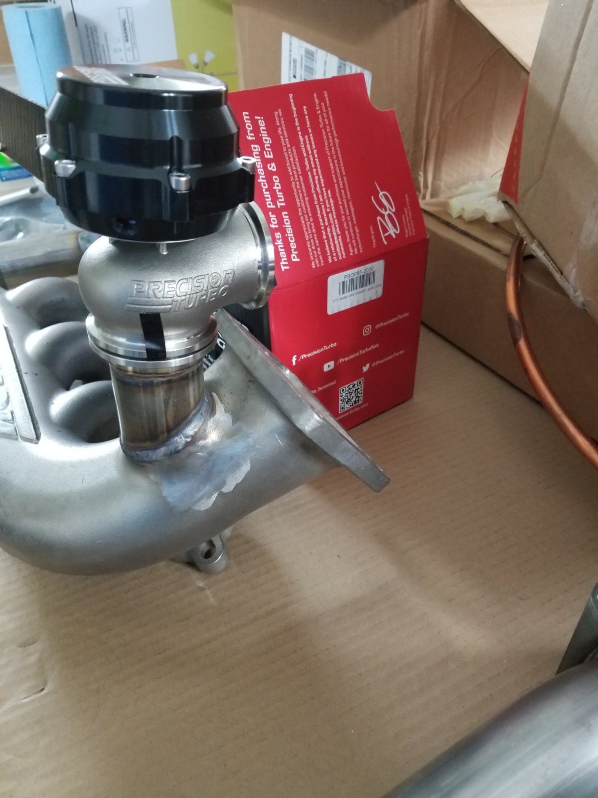

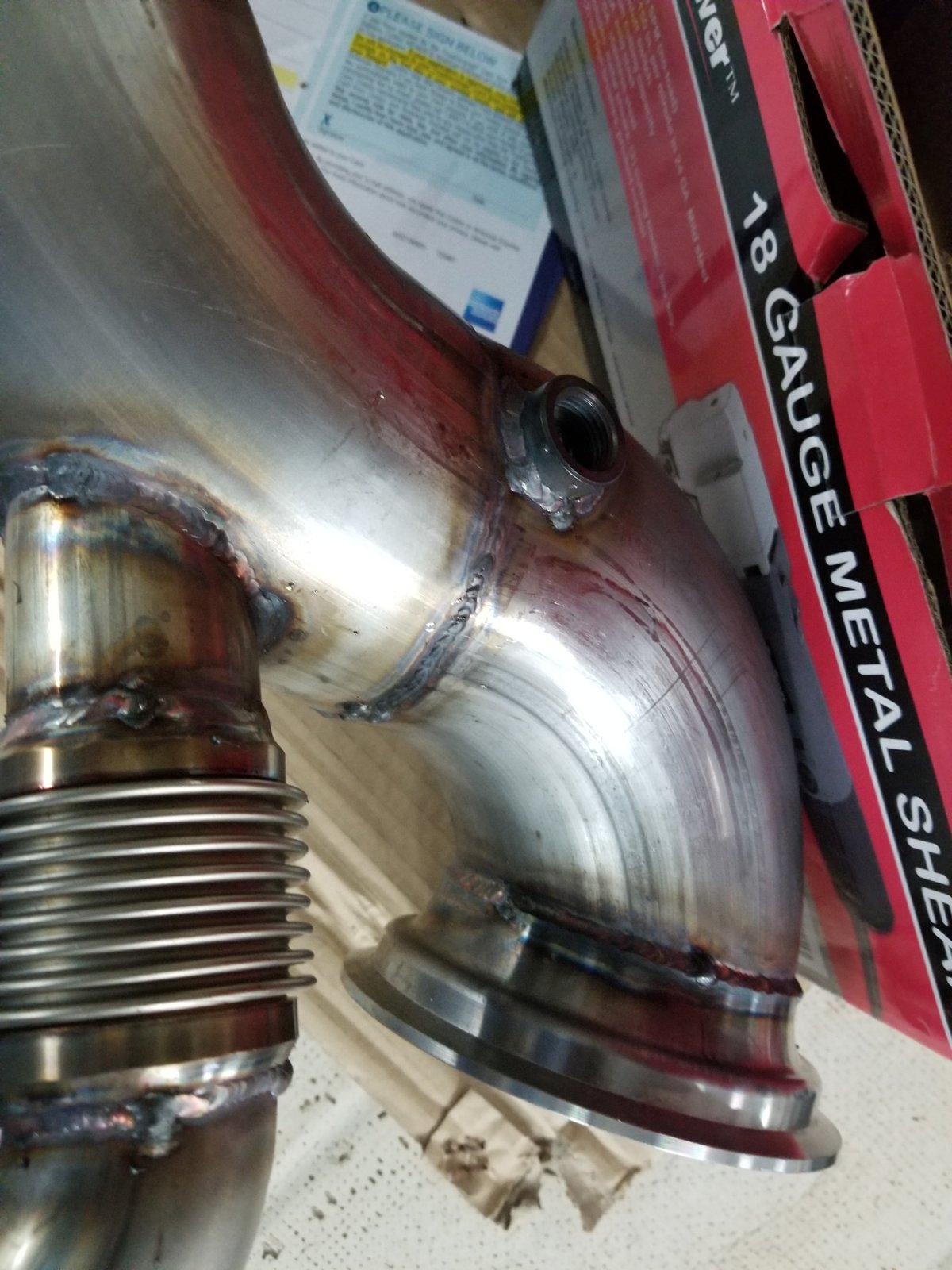

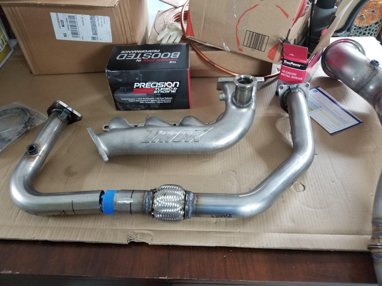

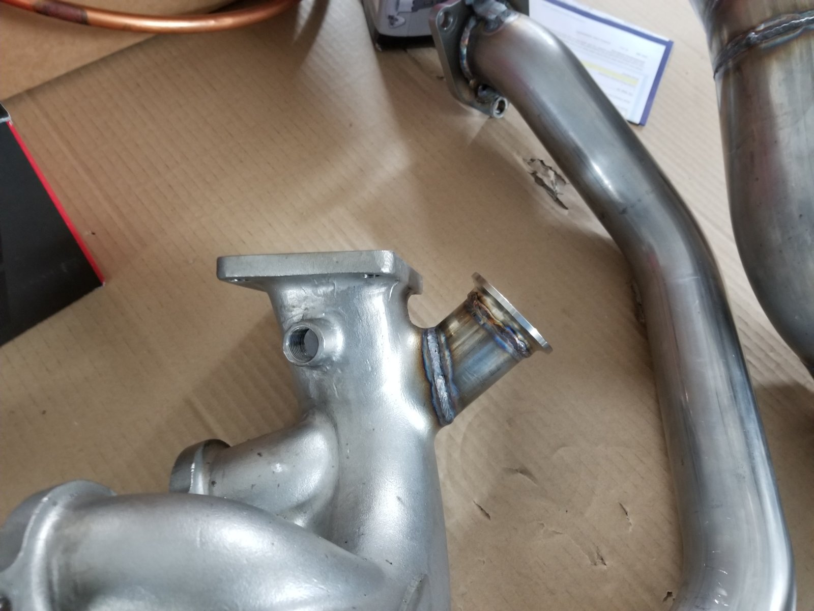

    cam stall longtube tune denali! mechanically deleted the AFM/DOD- kept the VVT , replaced lifters, pushrods, springs, and installed the VVT limiter. Reassembled with headstuds and ls9 gaskets in case i get an itch for some boost later on, probably overkill but had to replace them anyway
    and it is soooo close. But ran into a little issue, header on the driver side hits the mounting tab for the front axle and the o2 sensor bung is pointed at the front driveshaft. A new engine mount may fix it, I only had a little flat prybar to try and coax it away from the mount, bigger prybar is at my office and will prob come home to take care of it. Passenger side fit good, just dont remember where o2 sensor was on it, but that side is pretty clear shouldnt be an issue wherever it is.
    ran most of the wiring harness back and plugged everything i could in.
    only things left are:
    fix the header, may throw a couple washers under the motor mount for temp
    put the coils on driver side
    put spark plugs back in
    mount the bracket for alt/power steering pump
    put the fans back in
    find the stupid e clip for the oil cooler line and hook them back to radiator
    change transmission filter and top off, check for any leaks with new cooler
    finish exhaust y-pipe
    fill coolant and oil
    load the tune from black bear
    put the front end back together if it actually runs

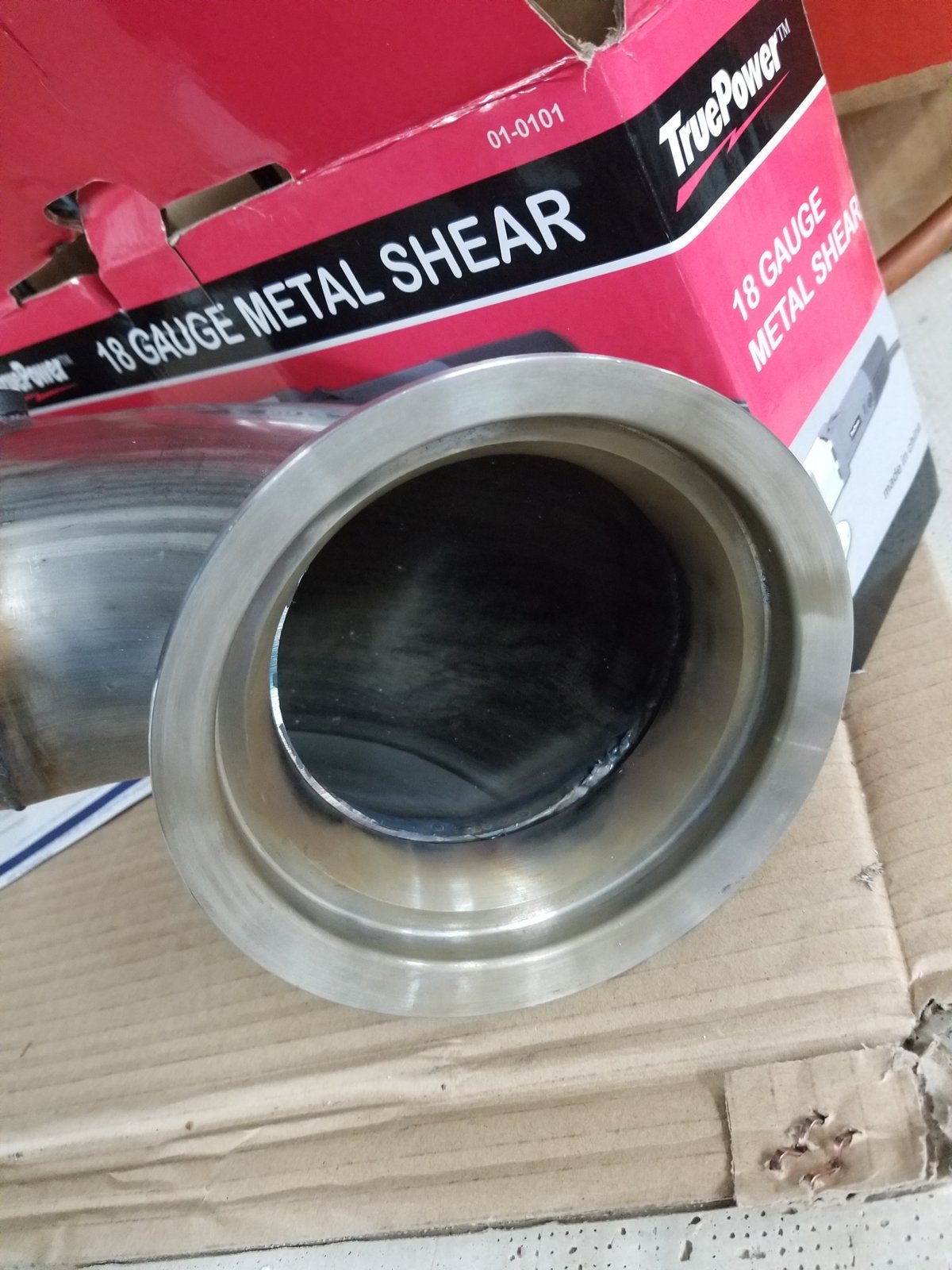

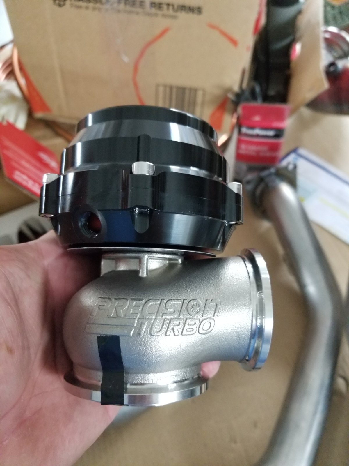

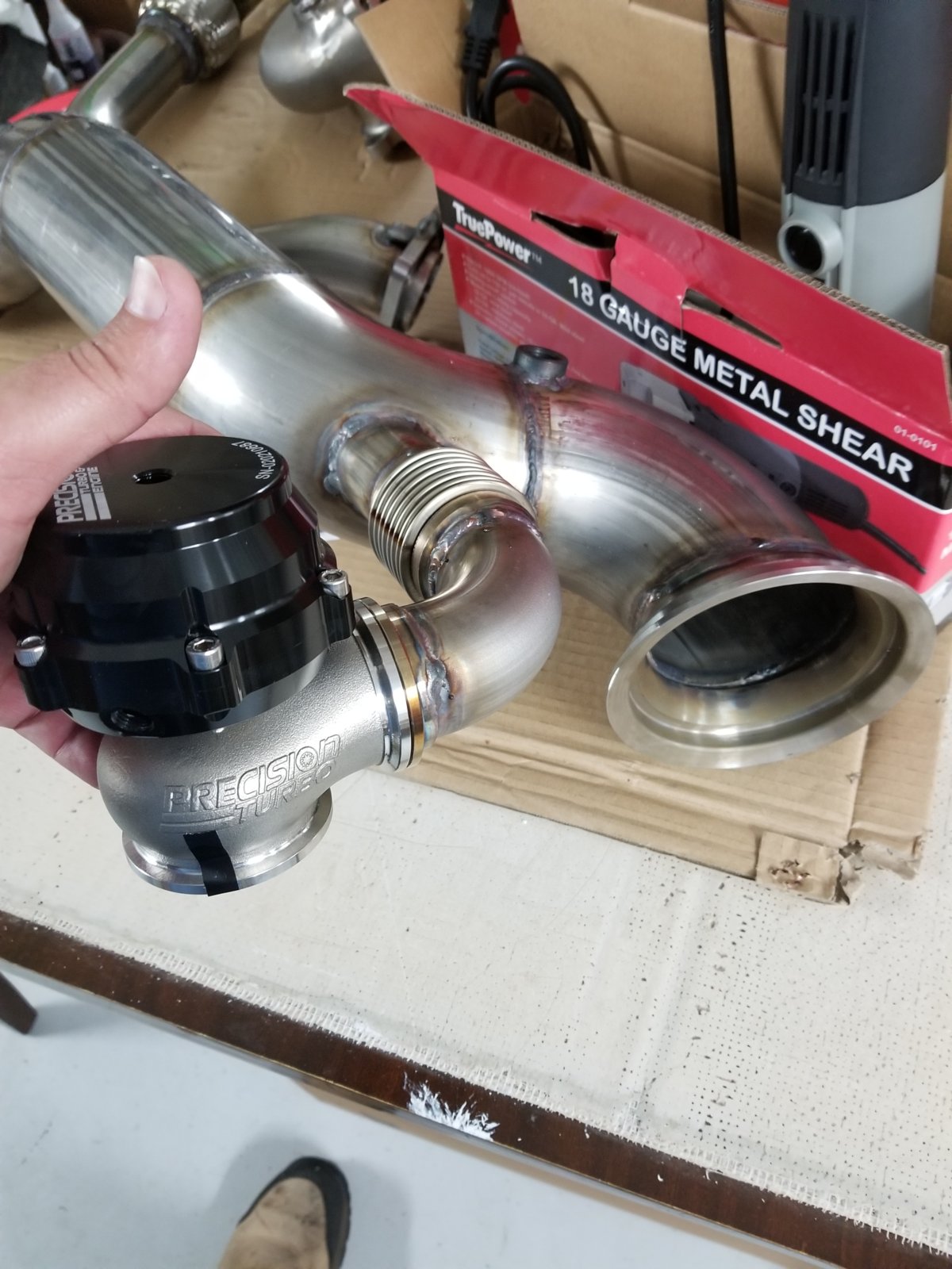

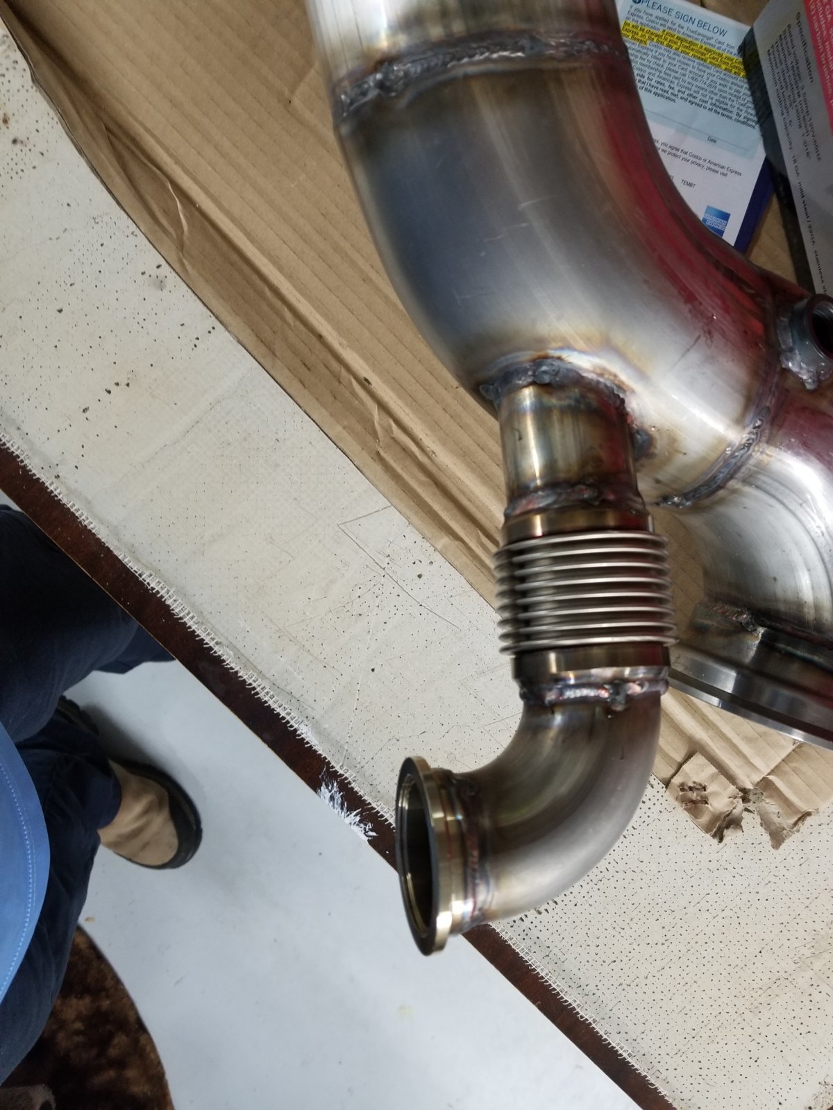

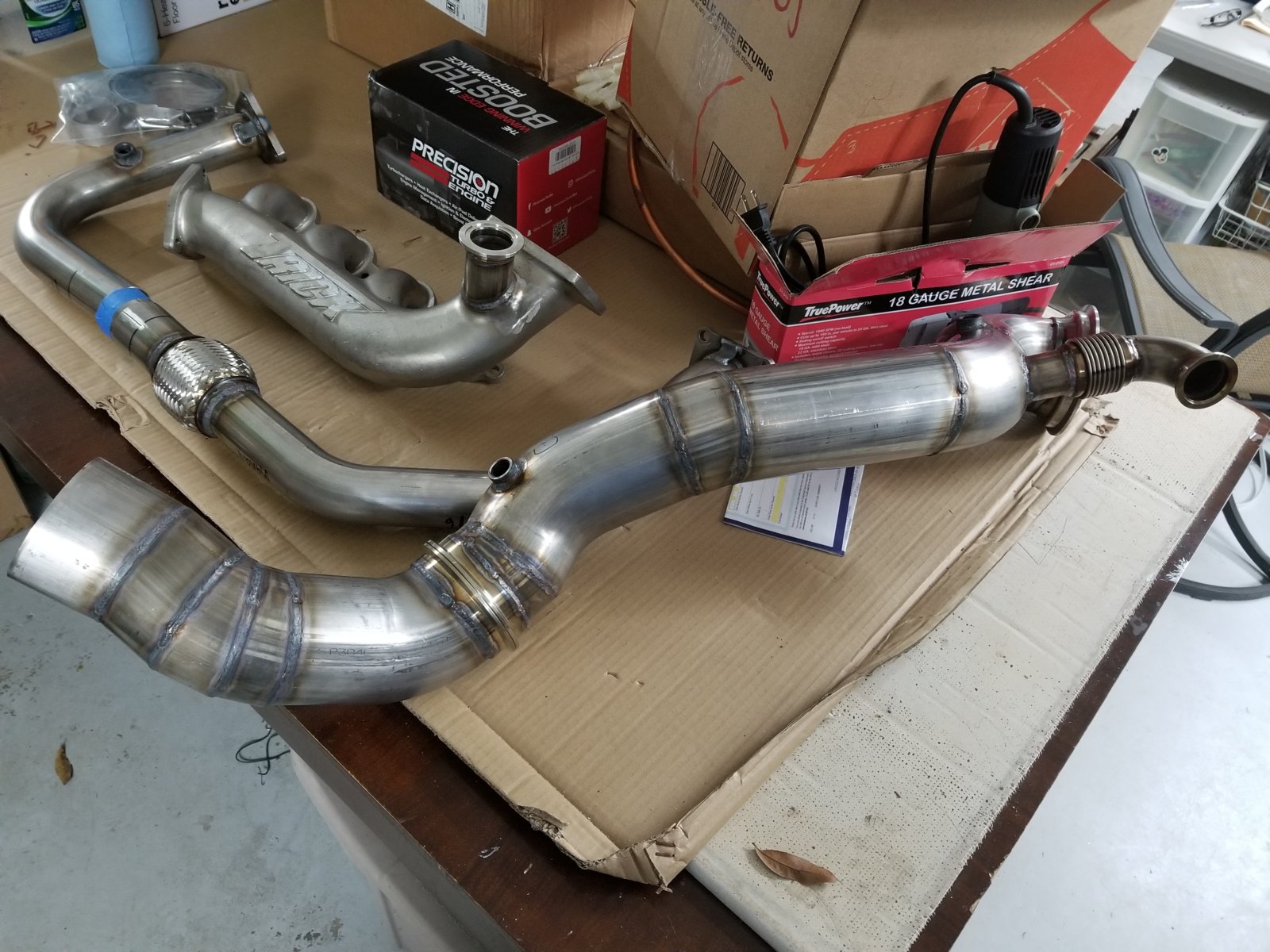

    20171025_205649.jpg 20171025_205605.jpg 20171025_205610.jpg 20171025_205625.jpg
