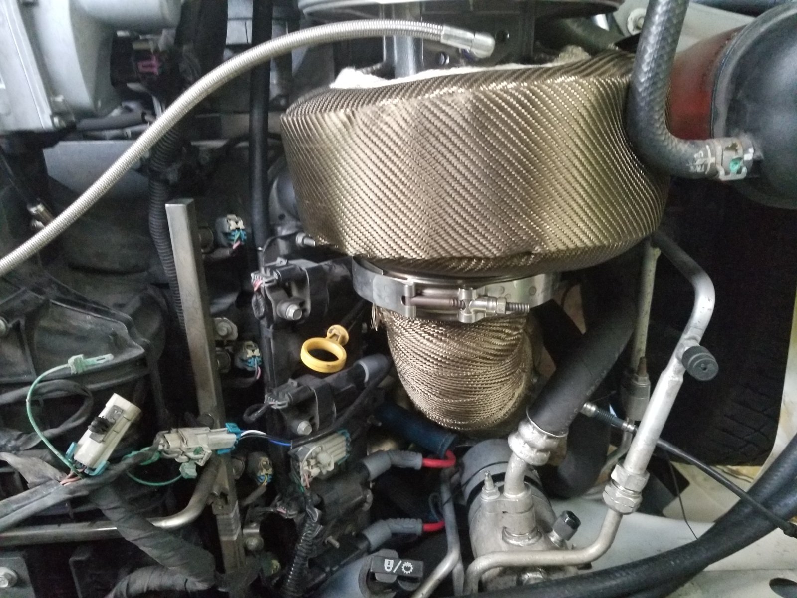

Not much done, got turbo to ic pipes on last night. Looked at oil return doesnt look like fun putting a hole in oil pan anywhere, I think I'm going to snake it down the side, takes it between ac compressor and exhaust manifold. I grabbed some heat sleeving http://designengineering.com/exhaust-sleeve-locking-ties-kit/ going to try with braided hose, may end up using hardline to do it though or an expensive flex hose (kevlar). If I can keep it atleast off the manifold I think itll be fine.

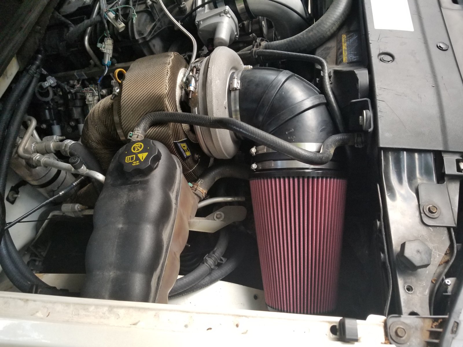

Was dark by then so I just putz around with the intake elbow, thought itd be awesome to use the airraid can to atleast to shield some heat for normal driving (remove filter for max air) so I cut out the box to accept 6" pipe nice n tight, looked good...went to see how it fit and the elbow doesnt even clear the fan shroud lol

yesterday- found a routing for the oil return i like, i need another 45* an hose fitting though (ordered will be here sunday), plumbed in the waste gate to turbo snout(had to drilled and tapped 1/8" npt) for push lock fittings, all pushlock on the w/g and bov. still need to drill/tap manifold for the bov reference. was making sure oil pan gasket showed up before i started taking off oil pan, thought i ordered it a while ago but i guess i didnt so i ordered earlier this week. also couldnt figure out a good place to put the trucool 40k cooler back in that would get a lot of air flow so i ordered: https://derale.com/product-footer/f...unt2013-10-28-09-53-271226240719/13740-detail should fit on the driverside on the frame rail right next to the transmission, ordered cooler block, -6an fittings and hose- should all be here sunday
today - oil pan gasket showed up, pulled pan off - it sucked about as much as i figured it was going to. where i wanted to place the oil return, on our trucks, the oil pickup tube runs down that side of the pan not the middle like i assumed. i dropped the return down as low as i could on the pan and am going to try a threaded fitting in the pan (1/2 npt), cleaned pan used some gm thread sealer (same used for oil pressure gauge). it was real close to the bottom of the pan, like cutting threads into floor of the pan :lol: but it tightened up good, letting the sealant sit for a day or two before i put oil in it anyway. if it leaks i'll get it welded in the same spot.

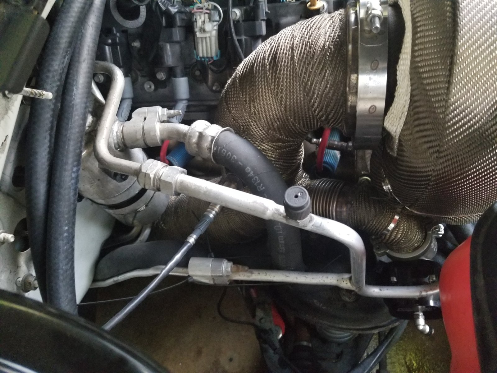

-i made the oil drain work with a straight fitting, probably is a little better - the 45* just allowed some error.
-pulled the trans cooler lines to the radiator out, cut them off and just looped them together so i could start and check for leaks. fully planned on working on leaks the rest of the day but were none (yet!) - all the stuff for, and the new, trans cooler should be here tomorrow

Tranny cooler turned into mess...block for 6l80 to 6an fittings goes straight out into the front driveshaft, so I need to work with the stock block, I just slid some hose over the ends and halfassed it in there.

Turned the 90 for intake down a little seems to work

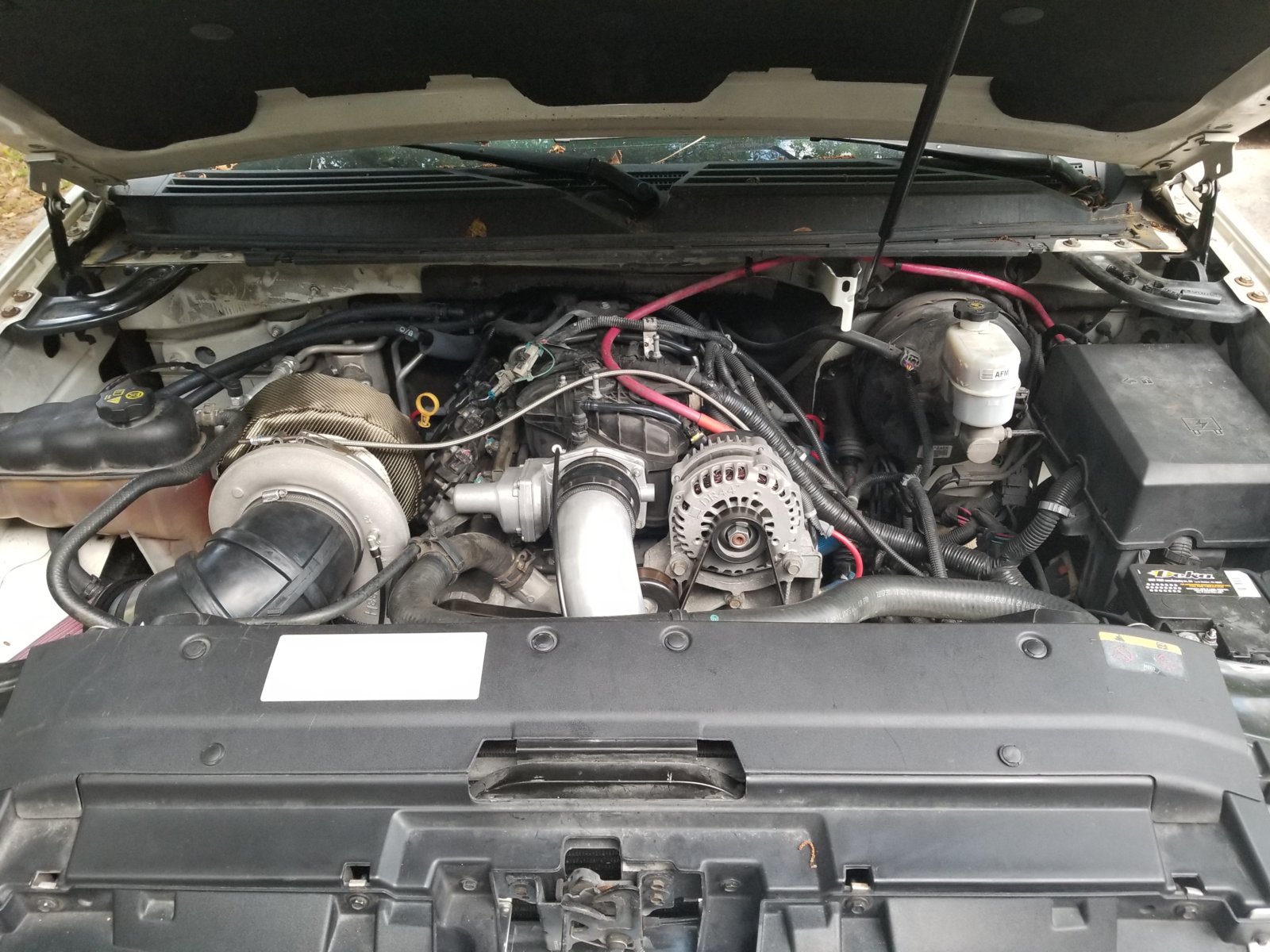

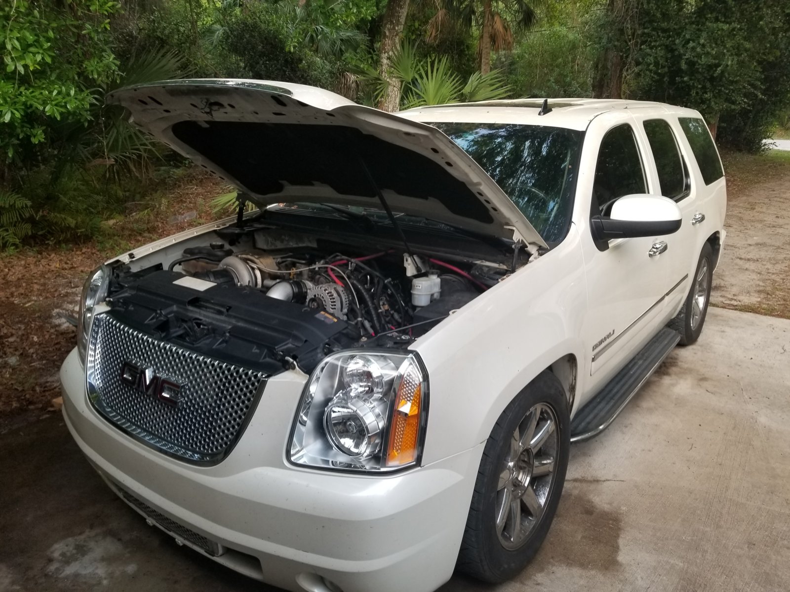

Couple random pics, tied exhaust back in
