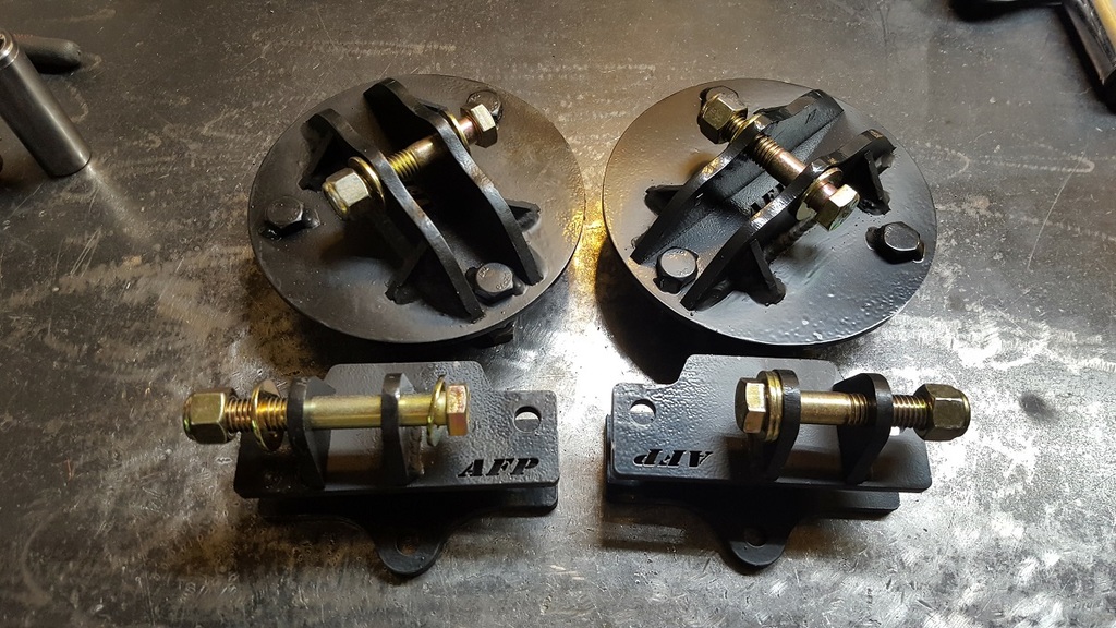

where "AFP" is written thats the top plate they sandwich the control arm where the stock shock mounts
I was just going to suggest mounting them below the control arm... it gives you about 2" of drop but it is very important to use Grade 9 bolts...

these mount a spherical bearing no flipping
with the spring i have i should be able to set ride height about an inch to the fender and still have plenty not to bottom out
