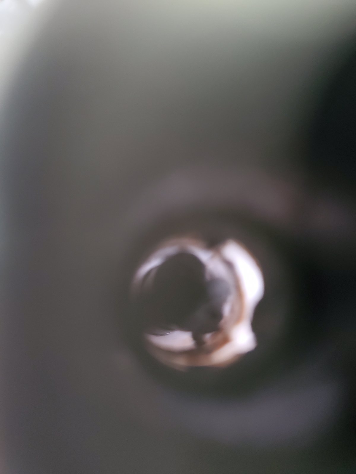

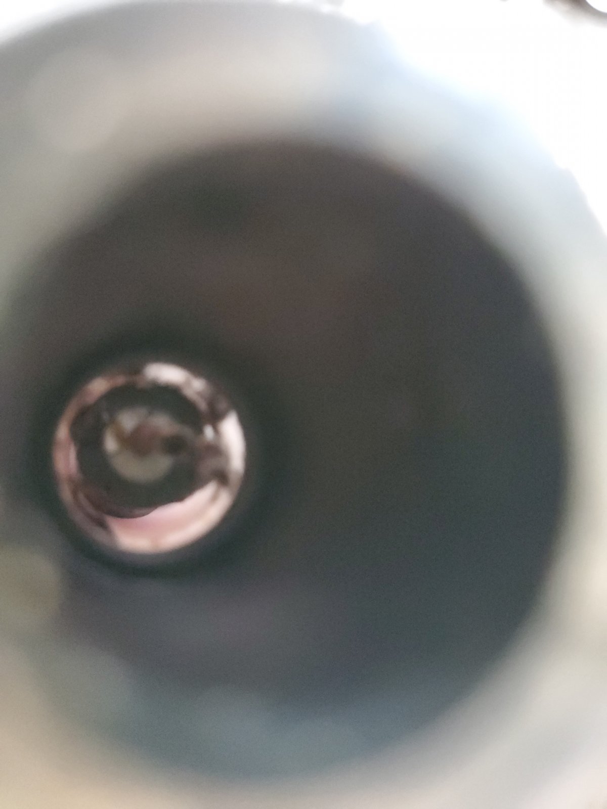

another thing id like to ***** about... accell ceramic cut to length plug wires. maybe i got a bad batch or something but the premade side that goes on the sparkplug, i had 3 of them that pulled the piece out of the insulator i even greased the things too. they were on there for like 2 months if that.
happened before and summit immediately sent out another kit and i was supposed to send back the other ones but now i need the two full kits just to get a single set out of.

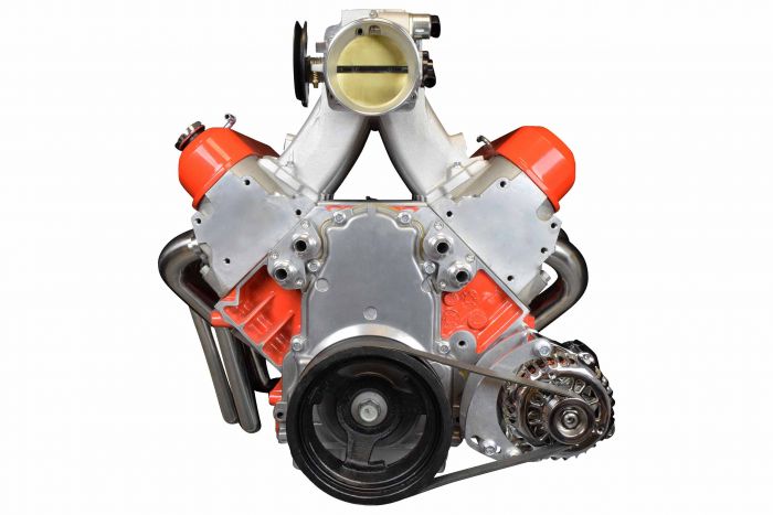

i went through everything and put a plan together to delete EVERYTHING, mount the alternator low with short belt, the bracket to work with truck balancer (and keep ac!) is only like $65/15 bux for a belt. this would eliminate the powersteering pump (see below)

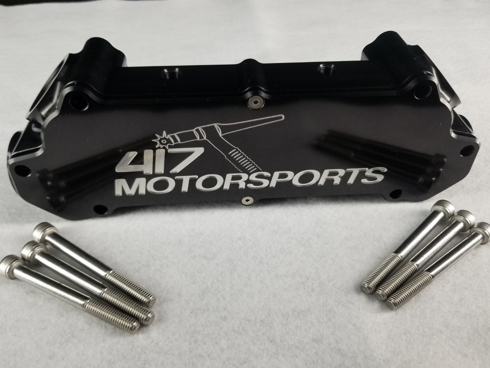

meziere 55gpm remount mount water pump, 417 motorsports water manifold...bmw has an oem PWM controlled electric water pump about 50gpm iirc. this could be achieved a lot cheaper but would like to have very good quality pump, there are other pieces that can mount in place of the water manifold but with this i could keep the heaters in the loop, steam ports into the top, clean install, minimal amount of fittings to leak.

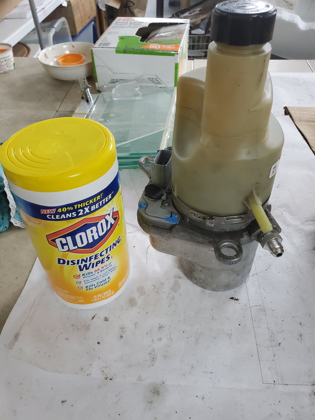

brakes - would either go back to vacuum booster OR volvo/ford have an electric power steering pump that does the same thing as above with no input reference it has a default pressure that works fine these can be had for about $100. these pumps are oem quality i've heard of people using them for power steering rack AND hydroboost brakes so no doubt they would be adequate. i may go this route first if the hydraulic rack will work with the lower alternator mount and see how it does. as little as this thing gets driven and usually only when nice out i might delete the ABS block/pump

Volvo electric power steering(eps) unit. Seeing the size of this thing really no doubt it'll run steering rack and hydroboost. got all the correct fittings for the hydroboost unit to use an lines - will use combo of ptfe and stainless hard lines. eps uses a 16mm x 1.5 thread like the hydroboost but where the o-ring seats in it is pretty big, i had some neoprene orings from injectors that worked perfectly but i need to make sure they're ok with power steering fluid may need to get viton or epr
