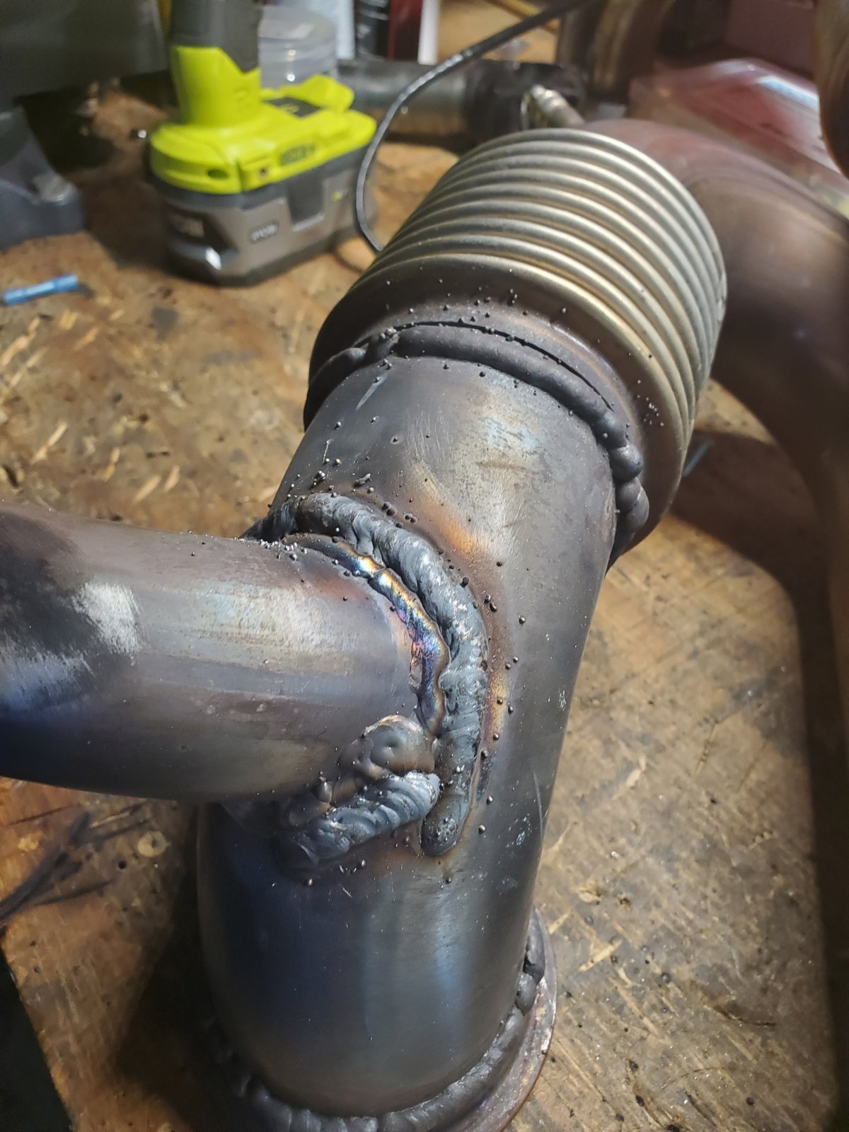

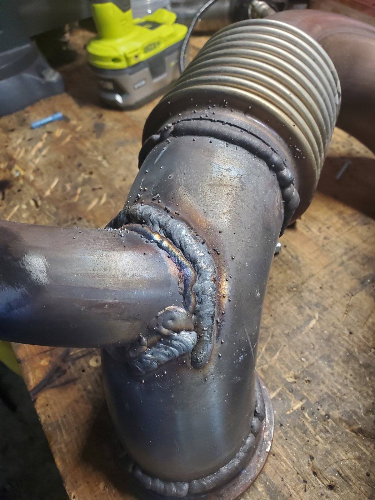

also...one of my wastegate tubes has broken (separated cause ****** weld job?) halfway off the merge pipe lol. i made two runs last night first one did 141mph, second one was like 137mph... i didnt think much of it but the second run shouldve been better and now i guess i know why

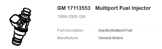

I checked out both those sites earlier, can’t find the ones he’s looking at, 17113553. They show as AC Delco OE for 99-07 4.8, 5.3, 6.0 Chevrolet when I Google that number.

Hmm. GMPARTSGIANT shows 1999-2000:
At any rate, IIRC in the post that @Tonyrodz had the person had already bought from the returned Amazon site. The price is too good to be true, IMHO.

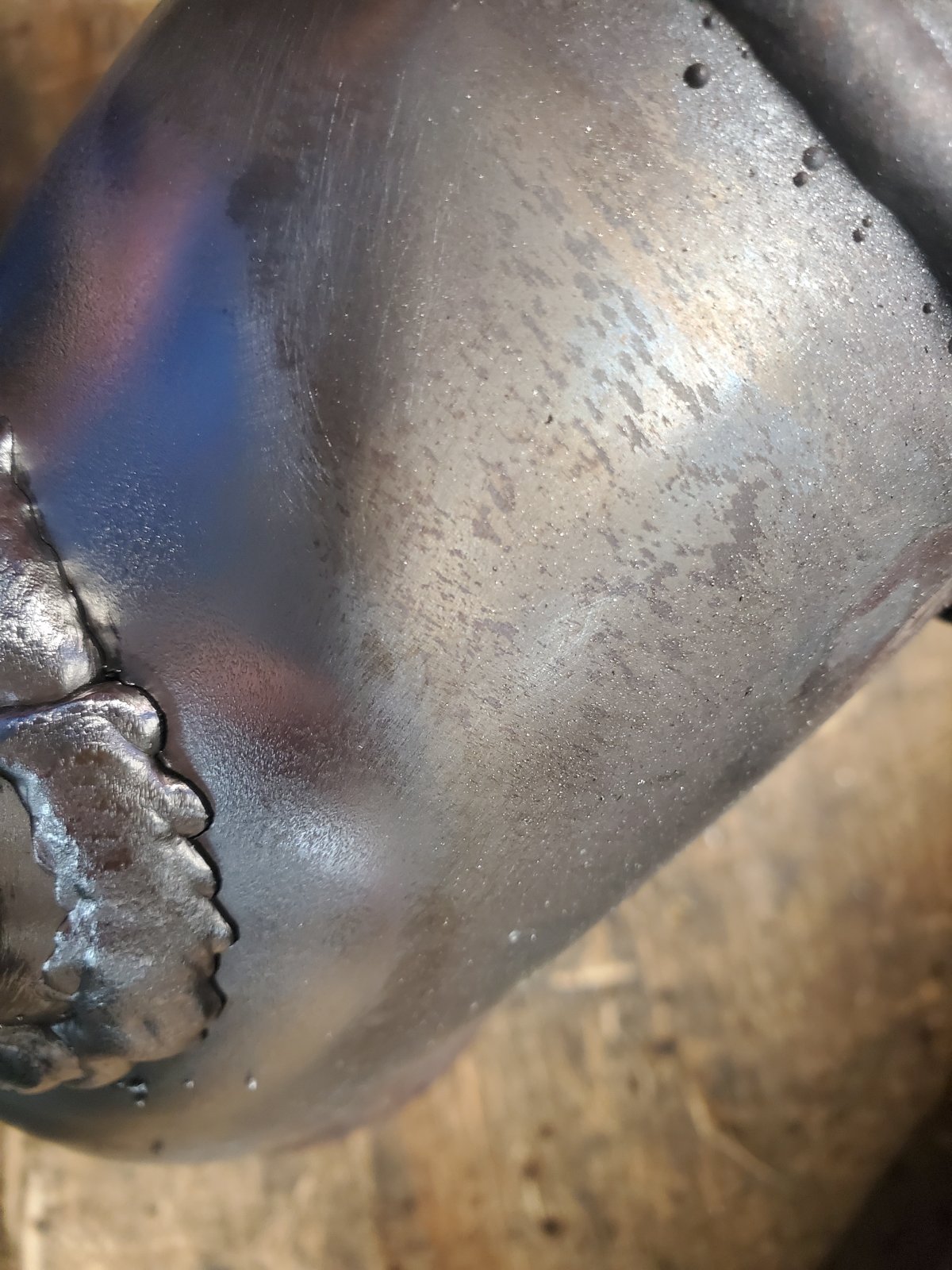

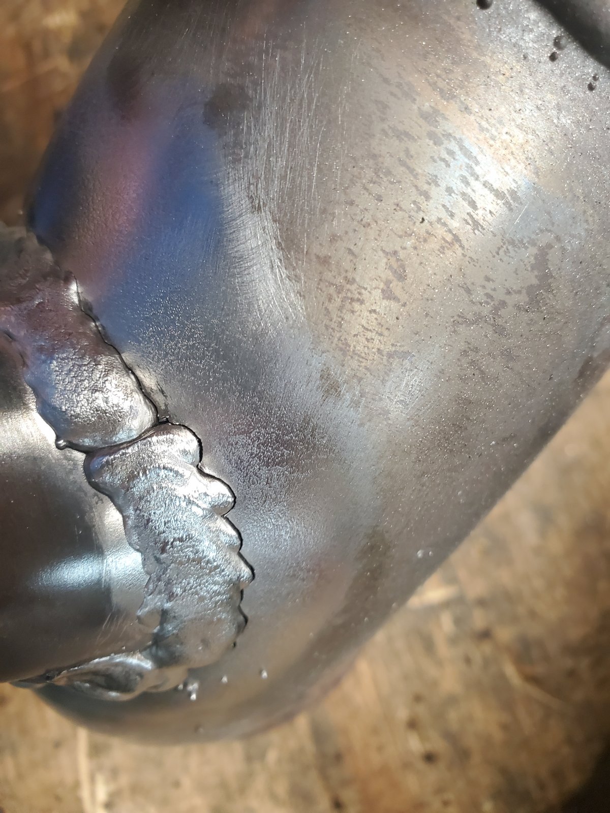

Was going to leave it cause I want to redo it back into downpipe...but figured I would atleast lay a thick bead on it to keep it moving inn the mean time
some of my best lookin welds broke off, so im back to layin the nasties down :rofl:
