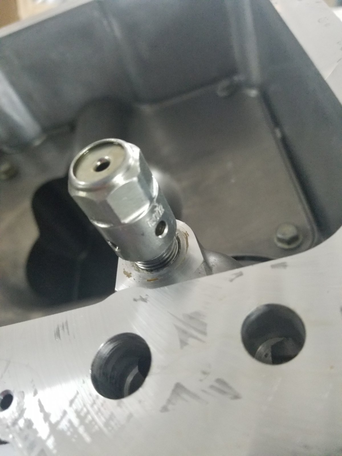

As for oil pressure now...I beat it pretty bad, after afm delete the towers are left open and just the valley cover has orings but not much support to seal up well (going to tap plugs into each) . Oring on pickup tube looked great and was tight but it's an easy swap why not. I removed the oil galley plug right after the oil pump on side of block and have 4an line going to turbo, it's a thrust bearing style so it should restrict oil flow and allow pressure to build no problem. Plugging pressure relief in pan, and only other major place ol pressure could drop is the cam retaining plate.

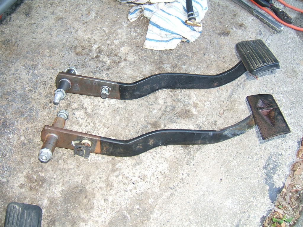

since i'm saving so much money ghetto building this bih...went ahead and ordered (what i hope is) everything i need to go hydroboost. I am not really to sure if this stuff is what i need but its as close to what it should be lol, ive seen a few swaps in gmt900 trucks using 2008-2016 hydroboost parts so hopefully everything will fall right into place. @swathdiver to confirm :anitoof:
pedal - i grabbed off ebay junk yard from a 2012 2500 yukon , 100bux for complete pedal assembly, wasnt sure if i needed something special cause it has adjustable pedals (one i grabbed came with adjustable pedal assembly).

the pivot point is higher - if the throw is to far it can damage the master cyl. aside from that i did not know, mine is attached to the entire adjustable pedal assembly if i dont need it even better. a lot of the parts are interchangable but usually run into little niche problems since there isnt much info available

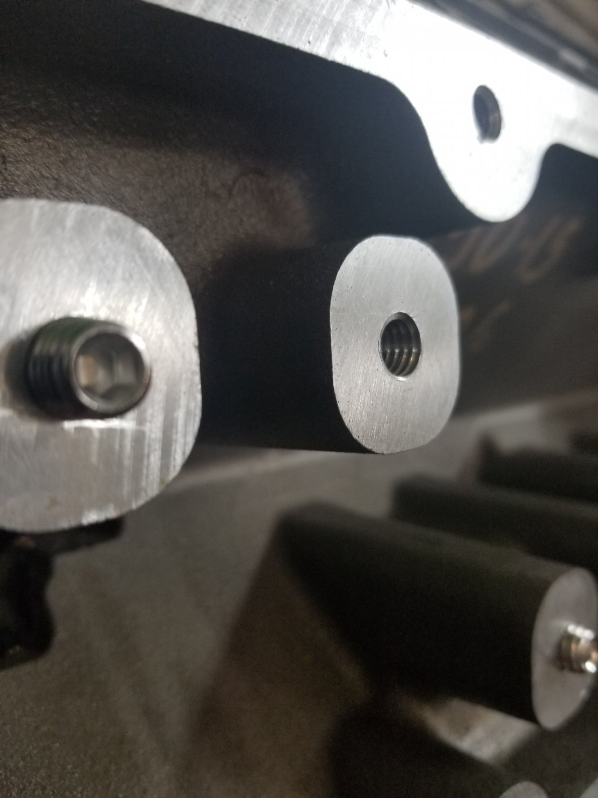

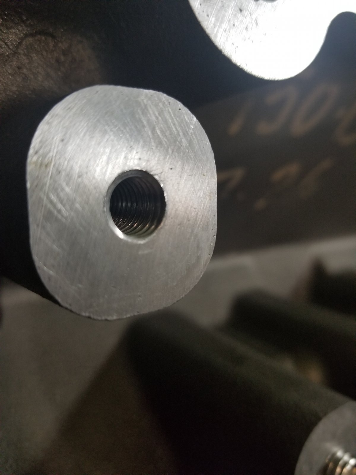

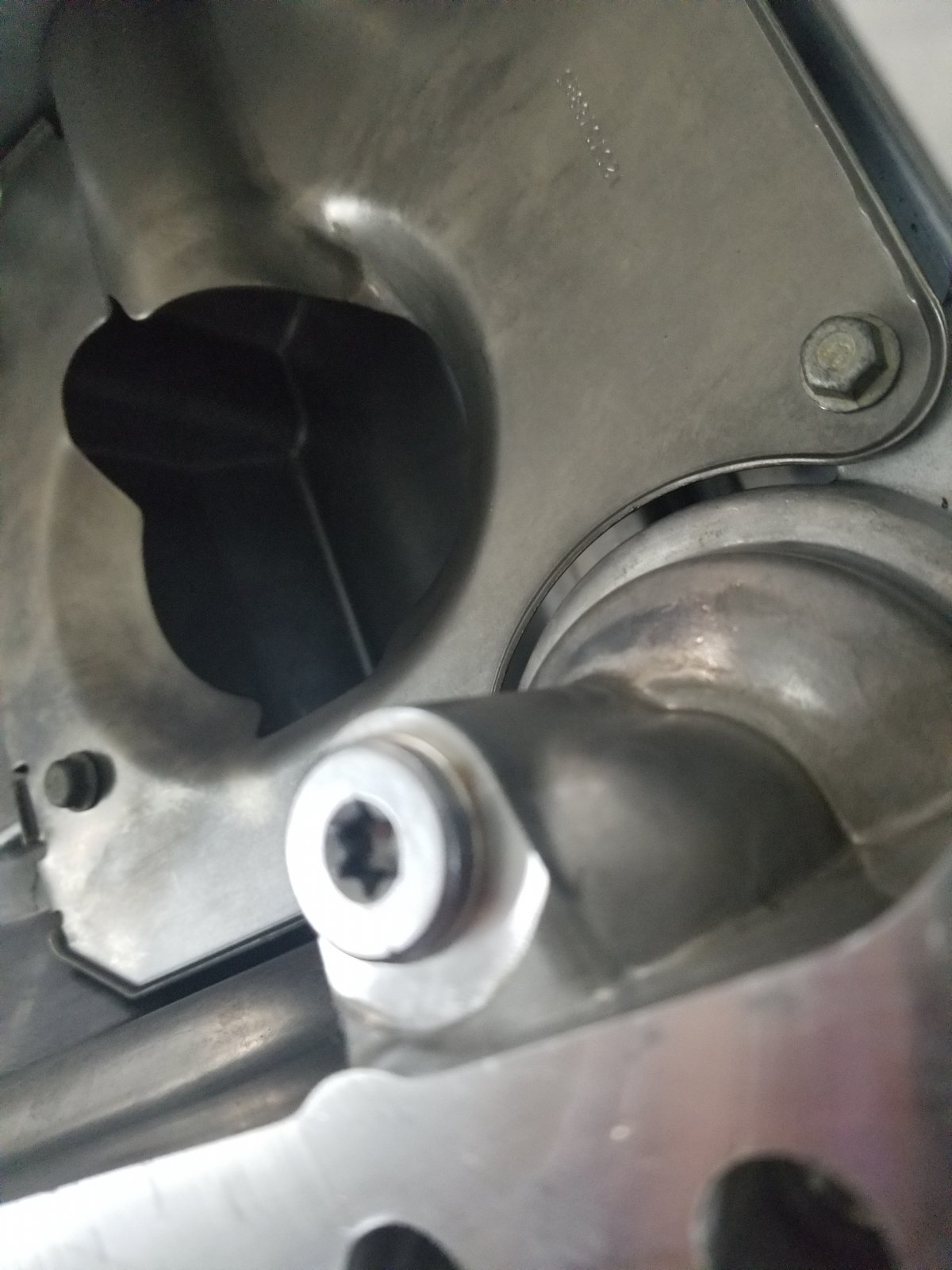

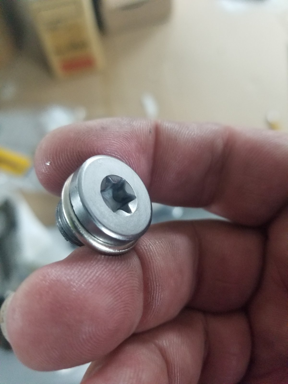

Pluggin holes
Lifter towers I wasnt too sure what I wanted to do. I tapped them out to 3/8, they were already drilled real close to 5/16 so that or 10mm was about the smallest option. Next on top of the set screws I wanted to use a thread sealer but was weary of it getting out of the threads, over applying, etc and didnt want it loose in engine. So I used some ultra black rtv on top of the set screw to make a little plug that will be trapped between the set screw and cover

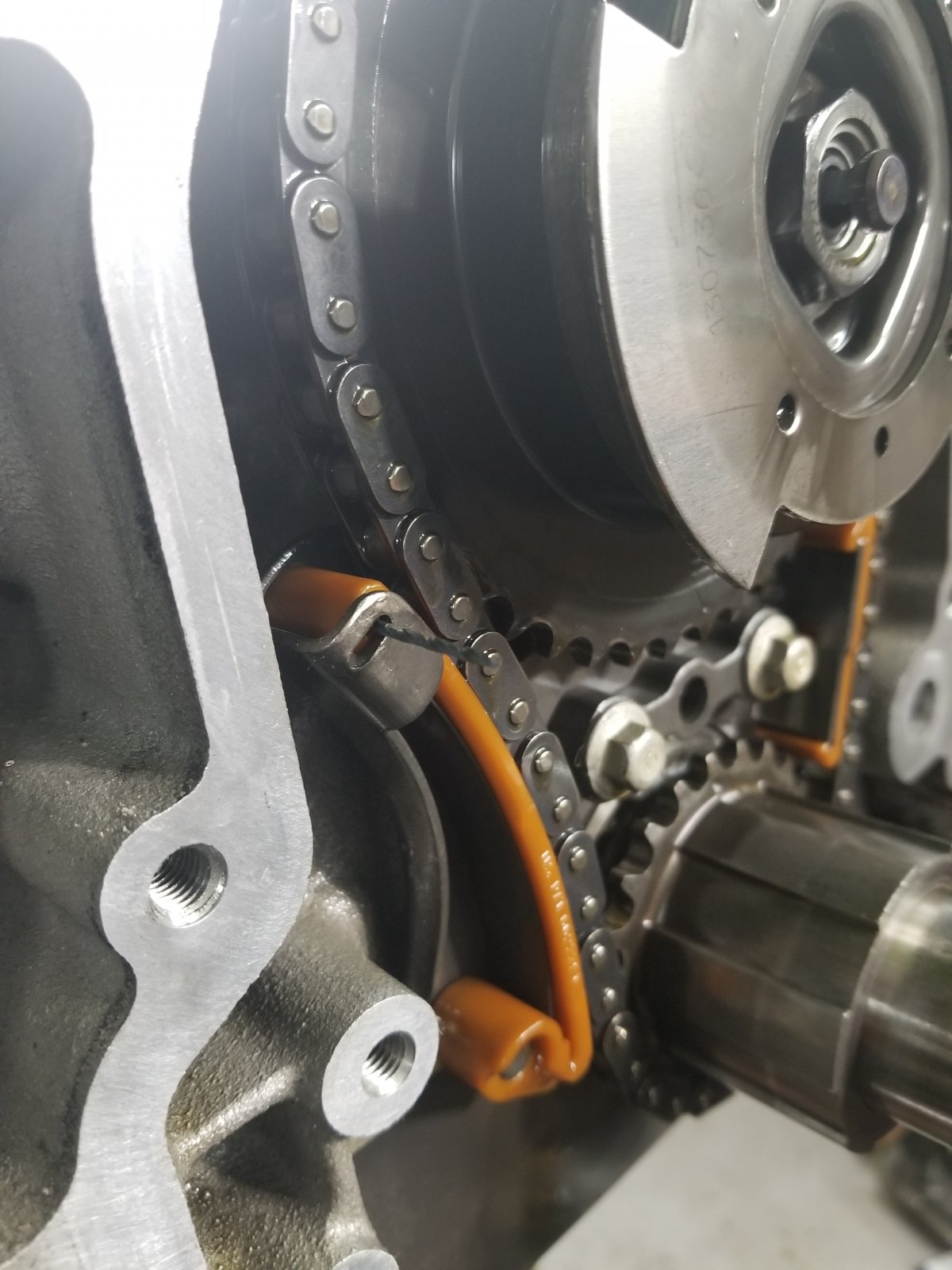

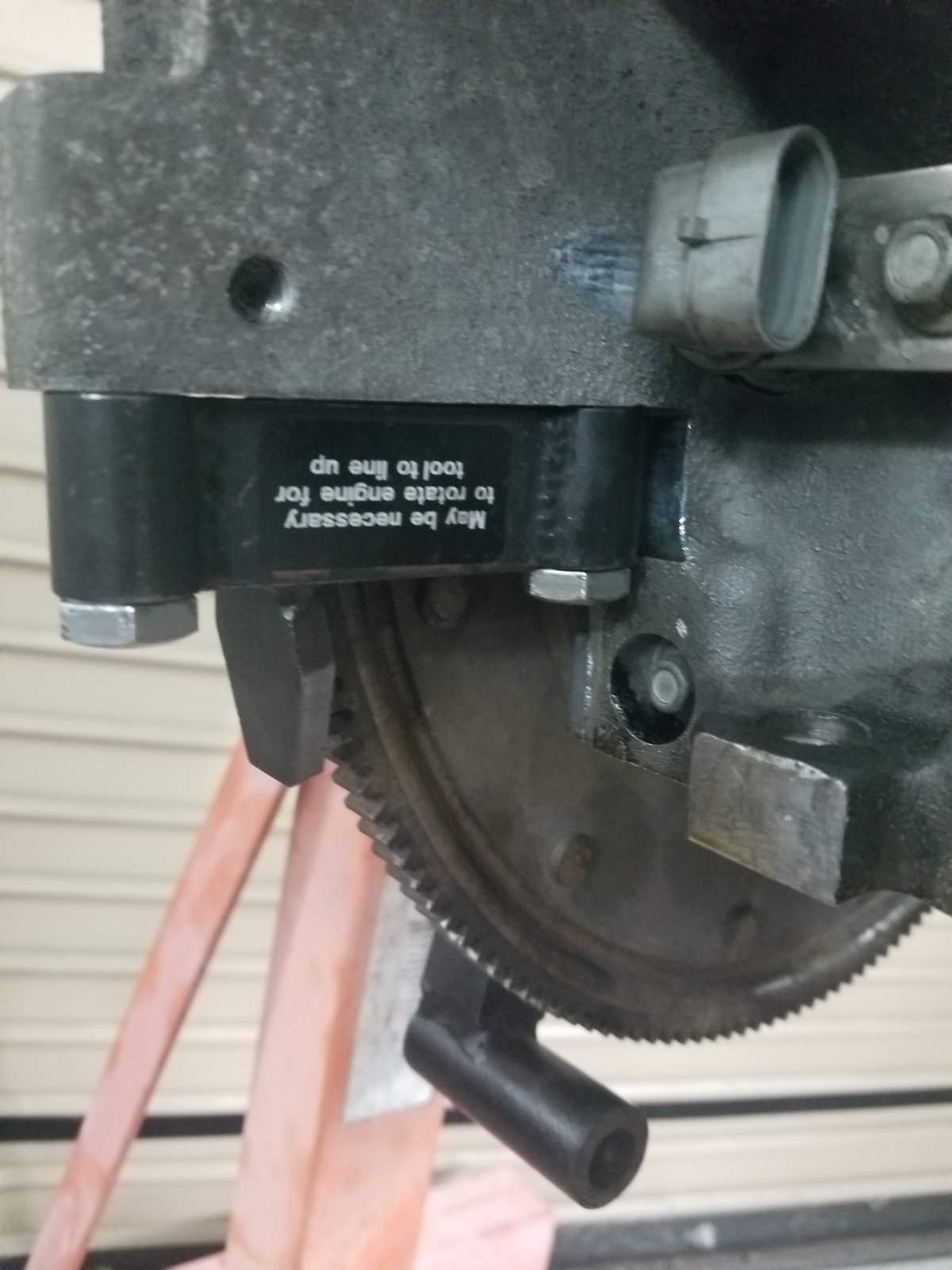

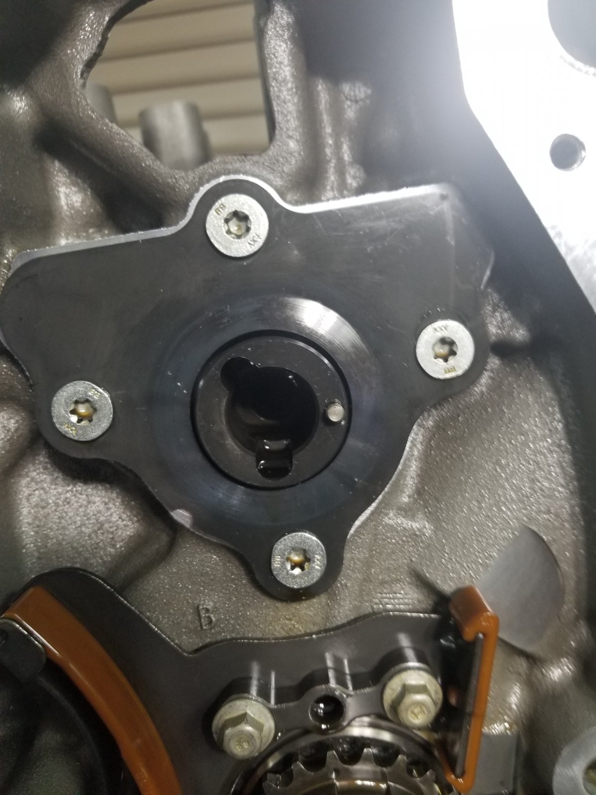

Line up yer dots, I have a flex plate lock I throw on it at the point, pull tensioner back and put pin (small drill bit) in and take it off. And of course why would all the bolts come back out easy
Hmmm unusual rub on the cam plate? Not to sure why.

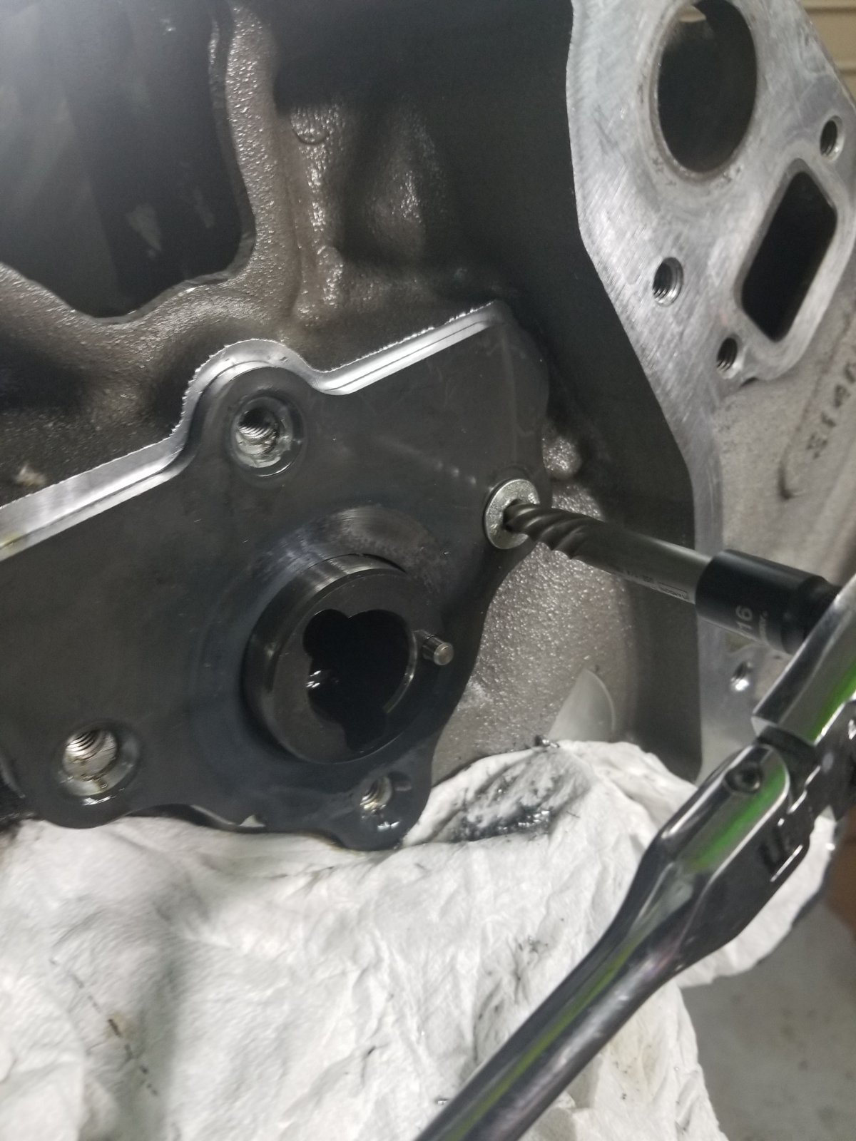

it is done.... i feel kinda dirty
there will be no pics for plausible deniability when i blow it apart :anitoof:
I will take some more after engine is all buttoned up and ready to go back in, the cam retaining plate didn't come with new screws and cant exactly reuse my old ones. so i need to jump up in morning and go find some. without them i can't throw on timing chain/gears, oil pump, front cover etc.... i could put the heads on but would need to put in the lifters/trays first, if i need to slide cam in/out or rotate just going to be something else deal with so im callin it a night

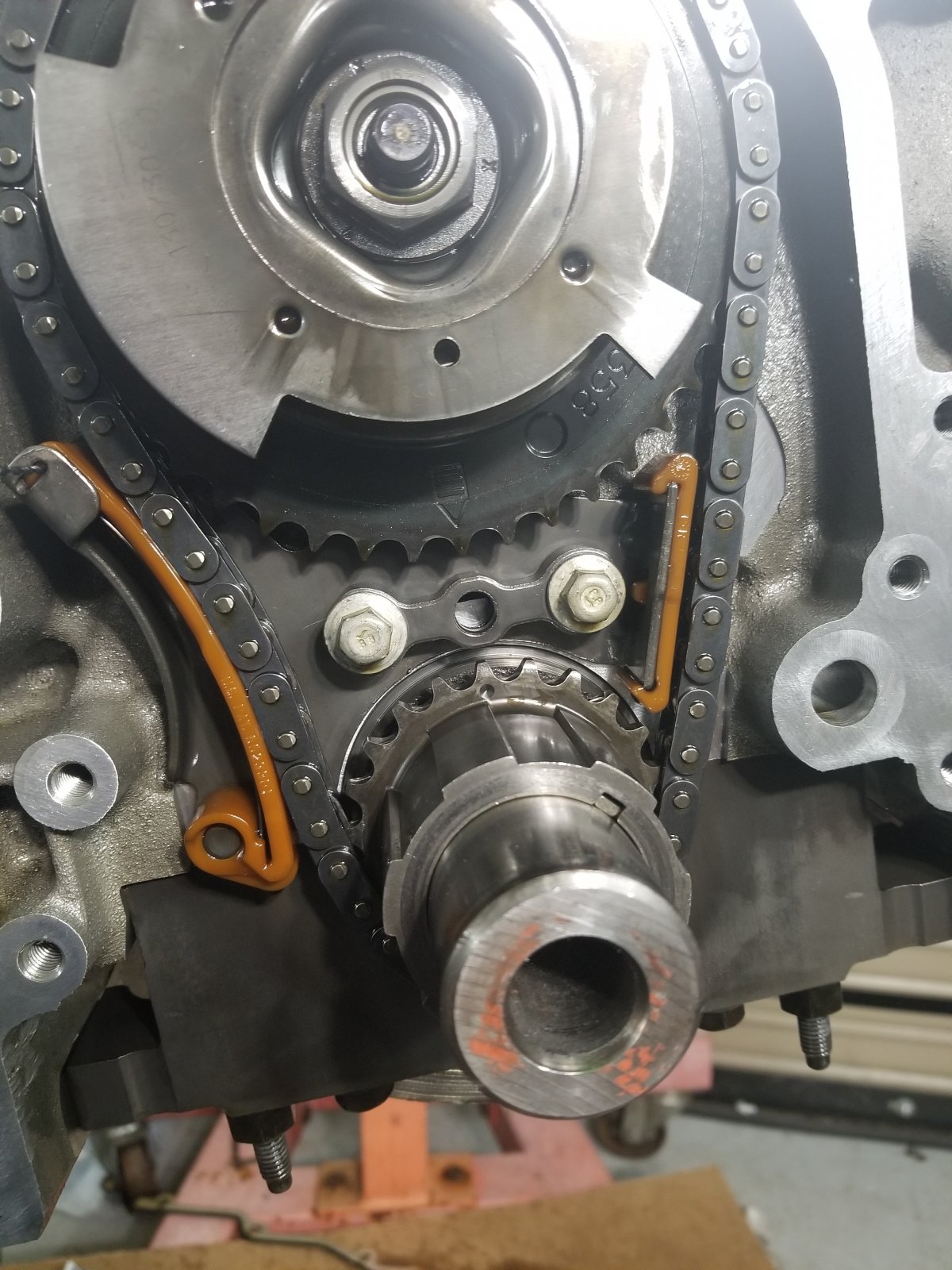

Are you changing timing chain tensioner? Just wondering when I was doing VVT delete my kit came with old style tensioner as on the pic.
but after installing it we noticed much play in the chain, so went back to original one.

mine makes so much noise anyway :Big Laugh:
you mean tensioner 1 or 2 of the ones you posted? the top one i wouldnt even call it a tensioner it just keeps the slack from going in
i'm putting back on the spring loaded one
Chrismnj
Sep 17, 2015
1,227
2,121
NJ
Picture 1 on my friends truck making noise, I went with picture 2 no chain noise for me
