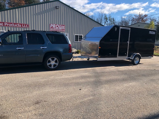

I was towing my tailer so i was using more gas also!
