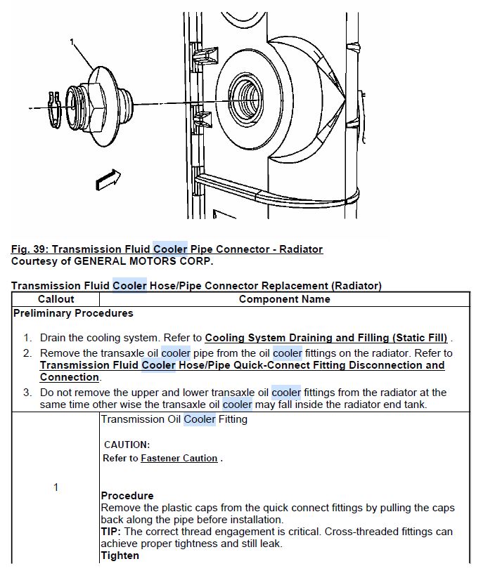

Replacing my 2013 Tahoe with a Spectra Premium CU2370 radiator. I have the oil and trans cooler lines. Anyone know if the replacement fittings for the lines have a torque value?

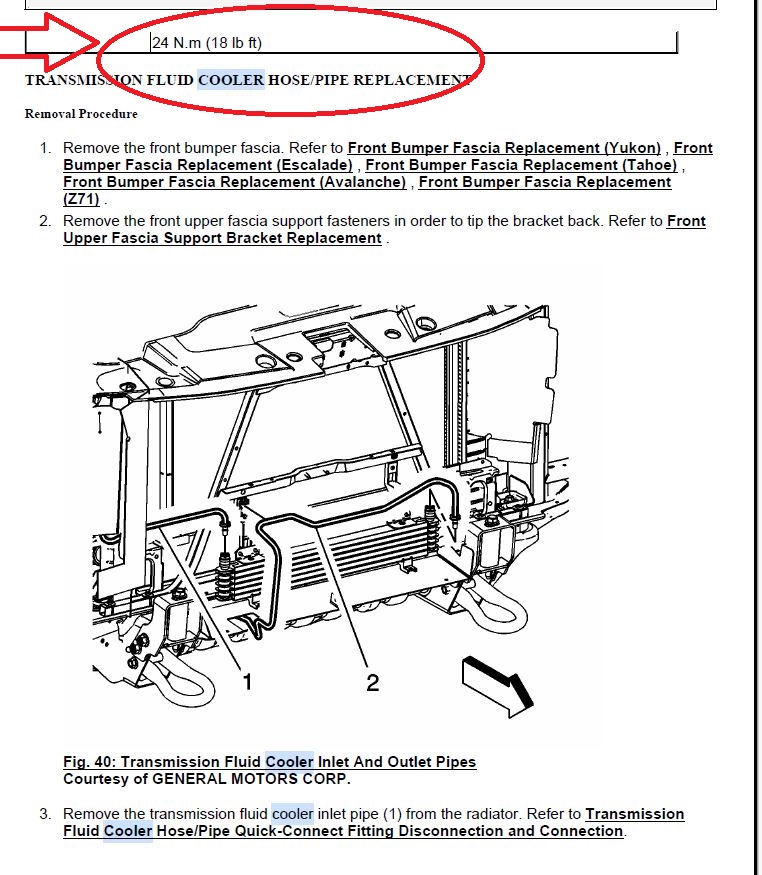

FOUND IT 18FT LBS, i guessed correctly, oil lines should be the same or very similar
