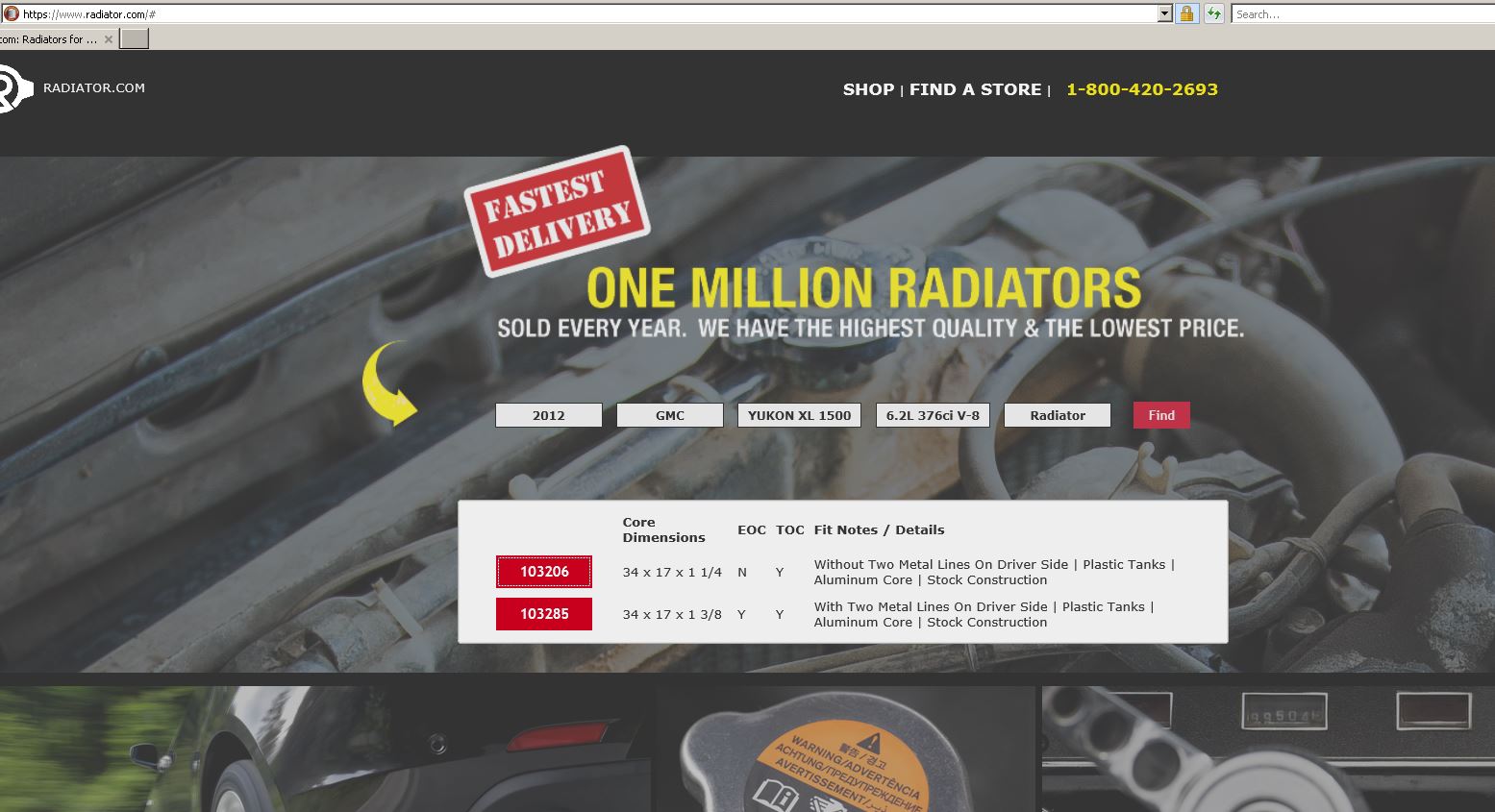

Thanks, thought I had looked at Denso but they had no reviews so wasn't sure how well they stack up against OEM. That one isn't the correct model, it lacks the trans/engine cooler, looks like this one is:

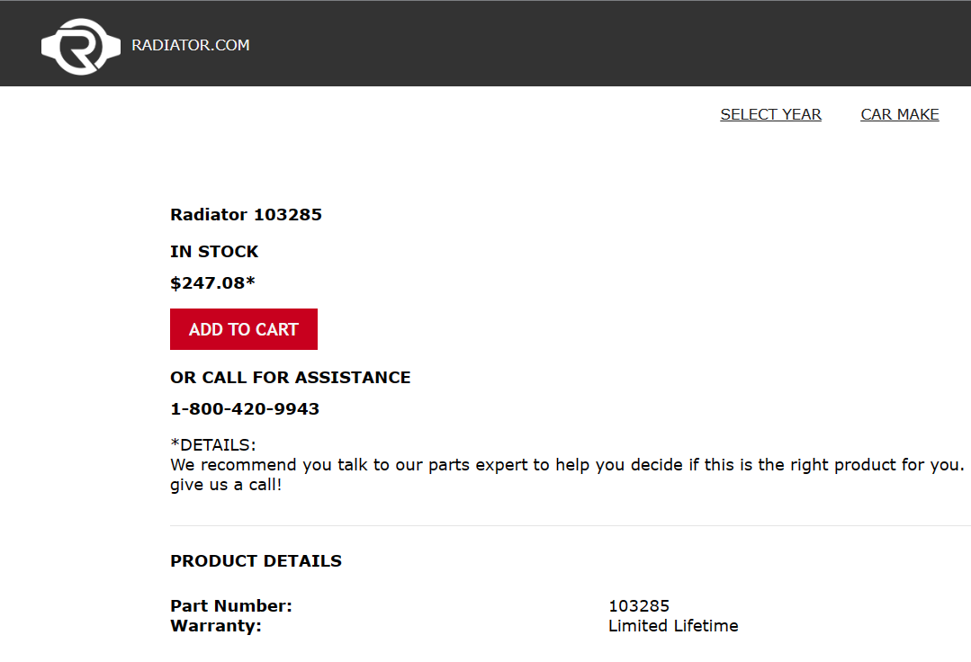

Looks like it's the 103285 for the 5.3L for $247, never heard of radiator.com before, are they their own brand?
