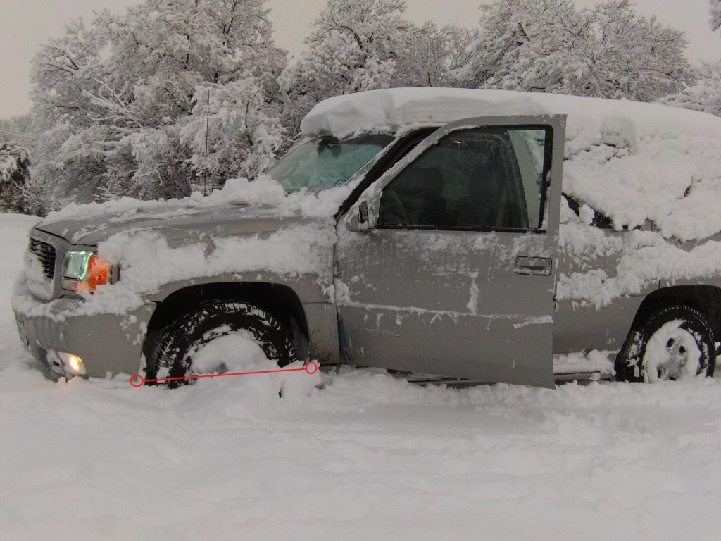

But since I already started a thread, can someone measure their wheel well so I can find out if my bumper makes my front wheel wells any smaller than what's on a regular obs. If any one wants to measure theirs from where I marked the pic I'd appreciate it.
