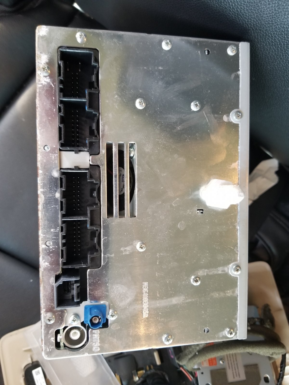

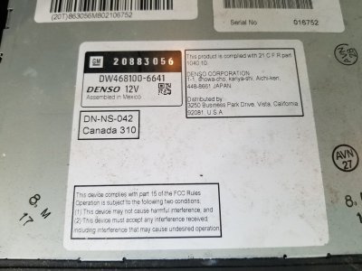

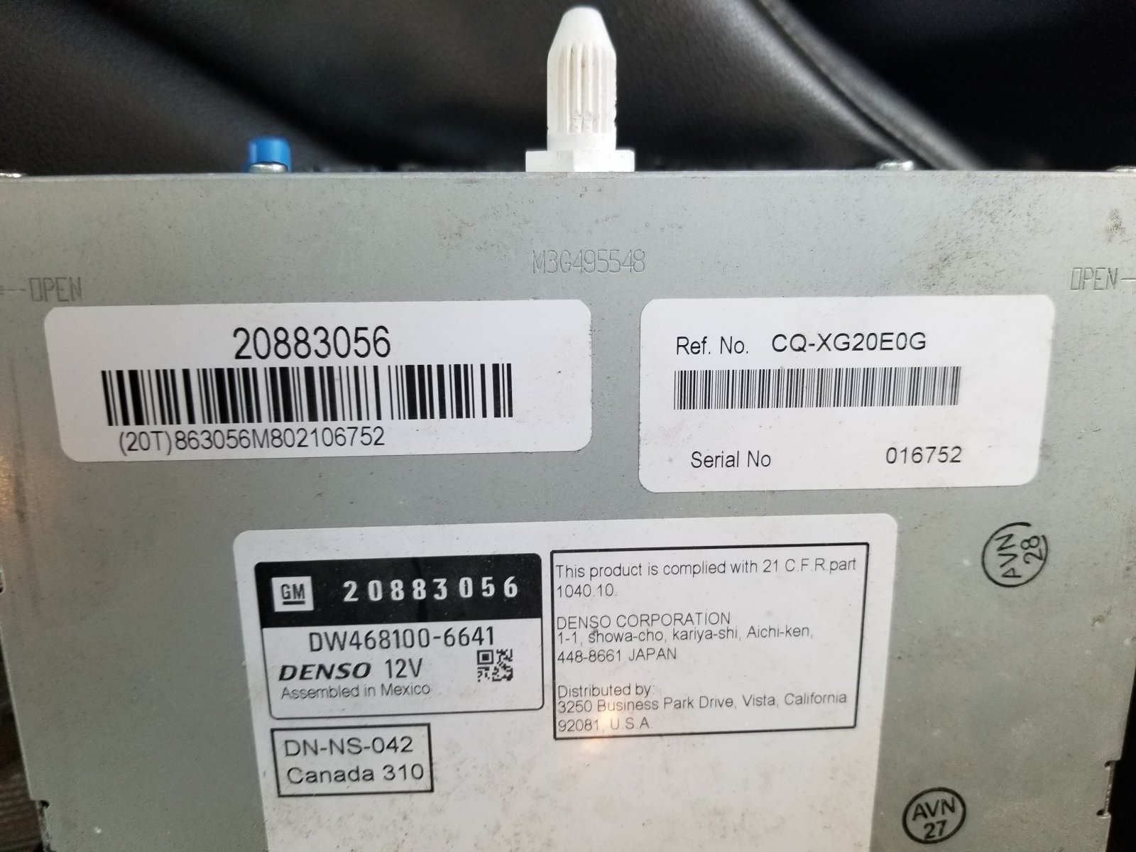

So I went to check out the radio and steering wheel and stuff. Steering wheel much too worn and he did not have all of the interior trim pieces I wanted. But I got the radio, GPS antenna and the upper console piece for $170. The donor did not have the extra entertainment stuff (fold down screens and such) but it looks like there is a mic in the upper console. And this radio has USB as well.
Need to find out where to get the speed sensor cable and usb cable.
Here are pics of my dusty radio
20190715_185834.jpg 20190715_185837.jpg 20190715_185849.jpg 20190715_185859.jpg 20190715_185912.jpg
45,016
Nice score! Especially since it doesn't have the RSE! PM member fiatdale. He might can help you out with the speed sensor harness. Greg at CPS might be able to as well.
