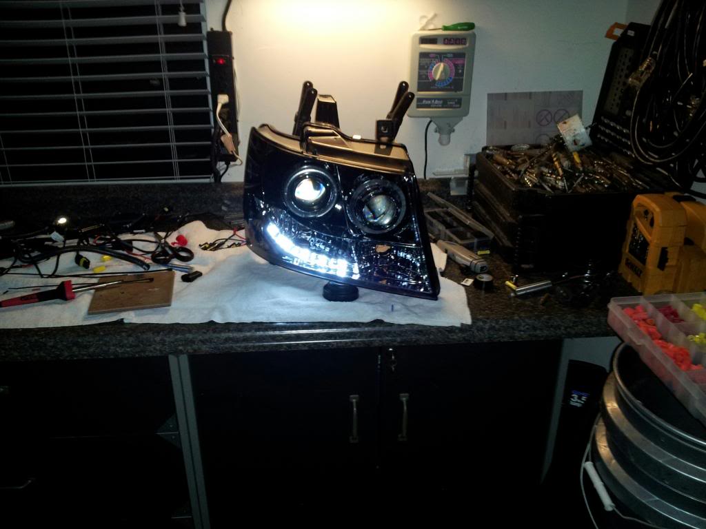

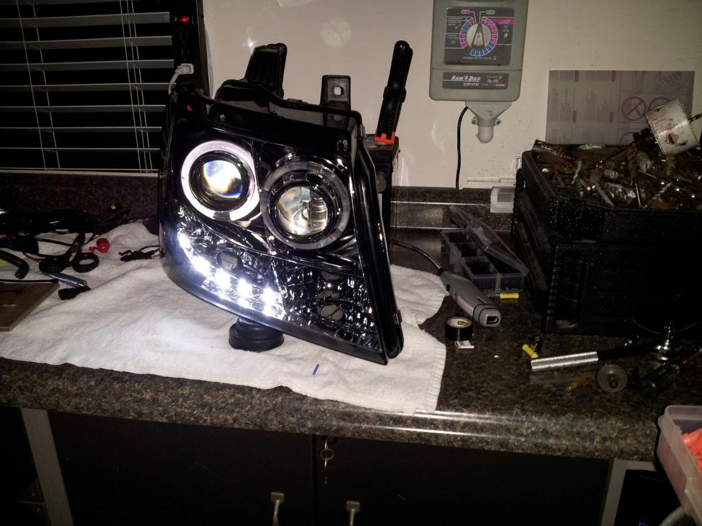

More progress pics
[/URL][/IMG]
Pic of original reflector with mounts cut out
[/URL][/IMG]
Flipped the original reflector mounts and test fit
[/URL][/IMG]
Level and ready for epoxy
[/URL][/IMG]
BOOM
[/URL][/IMG]
Everything fits in the housing, yay me!:greenchainsaw:

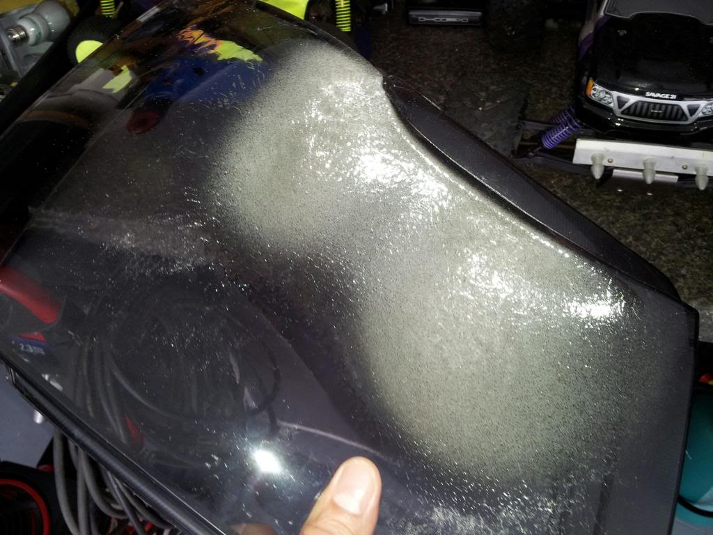

I put this in the oven without preheating and didn't lower the rack, I'm an idiot, replacement parts should be here this week.

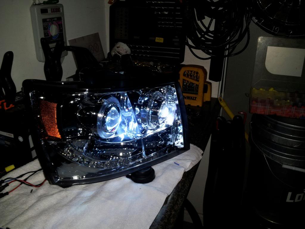

I know this is taking forever, hoping to install this weekend. You'll notice only one halo is operational, I had to modify it for the new projector, I think I'll delete the other as well, I replaced stock LED's also. I HAVE A WORKING HEADLIGHT, YAY ME!

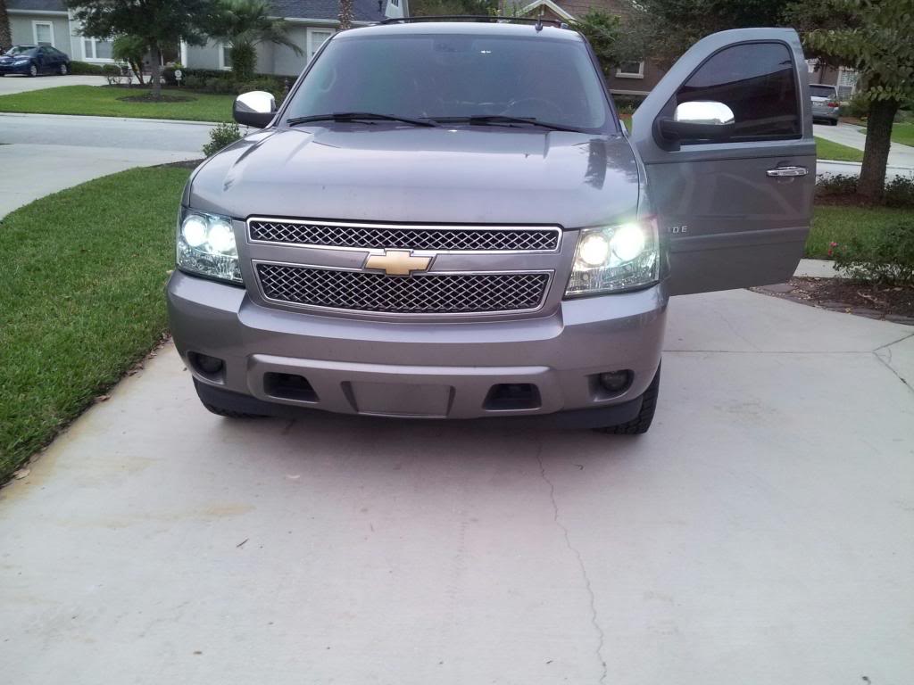

update
What I'm happy with after retrofit, overall looks, light output is ok, much better than prior to retrofit. I think I will replace bulbs with 5k soon(I have 6k now). I have some nice led fogs that are going behind the grill very soon. Got new shoes today too, 275/60R20, that's a +1 increase, fills the wheel well a little better.
Lower fogs will become DRL's, I'm using 2 amber LED's in each headlamp for turn signals.
My cutoff isn't as sharp as I'd like, adjusting them is a PITA
