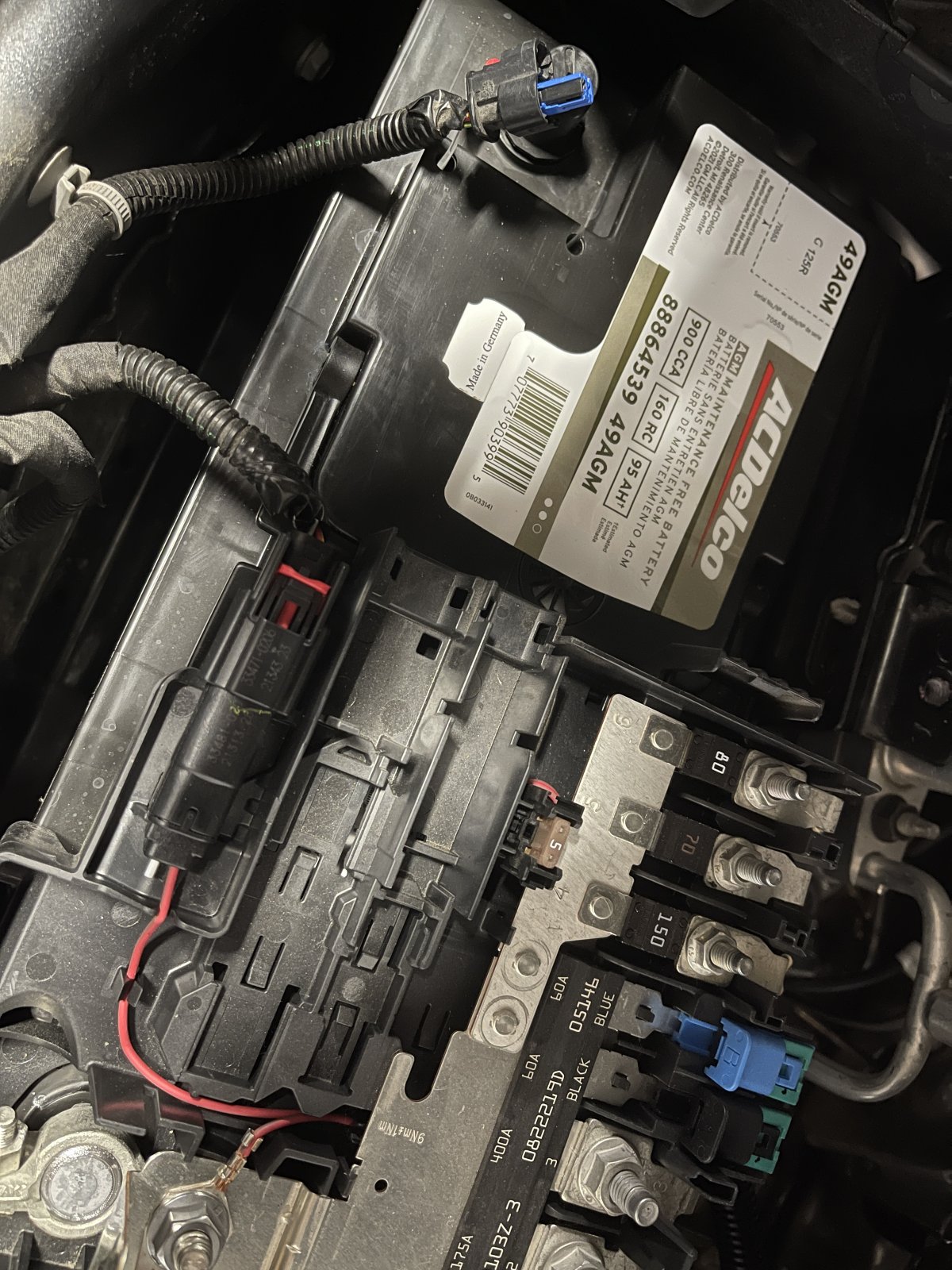

I just replaced my battery with an OEM (AC Delco). It had a “Made in Germany” sticker on it. The factory one was still “working” but I noticed my diesel cranking slower after sitting a couple of weeks and I’m a replace it before it breaks type of person.
Ordered it through the GM Parts Store and had it ready for pickup at the dealer. They’re running a 20% off promo right now and Visa card rebate so it was just under $200 for the battery.

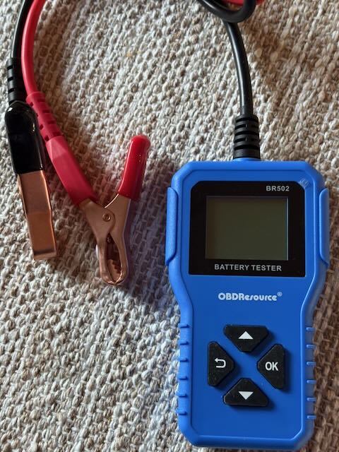

Make sure your battery is bad before you replace... and then if you go new.. test it. don't just pick up any old battery without a test.. below is a tester that determines cranking amps.. useful. $20. Amazon.
