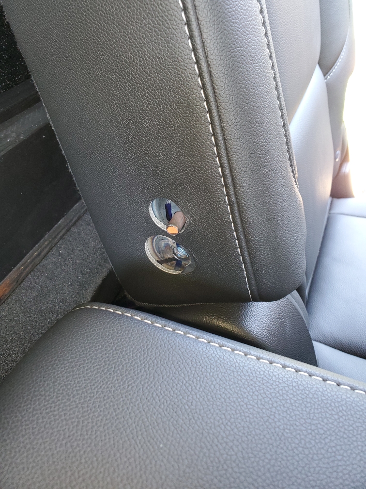

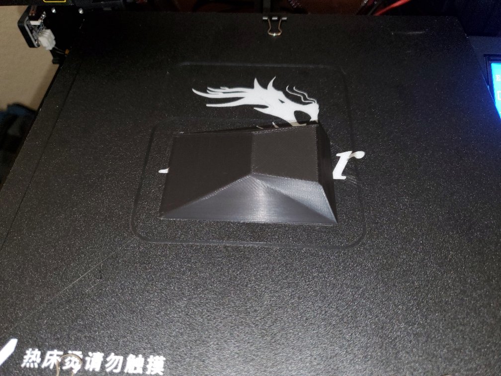

Thats a great view of front attachment, here is what I used for rear. A $20 amz seat bracket kit with a couple extra screw bracket thinggies I had left over from a aries nerf install kit (pic 2). You can see it all come together in 3rd pic behind red wire. Red wire feeds gang panel in console; it was fished under carpet/panels to driver side 3rd row power outlet - just pull up cupholder and solder it up under there. Used a 3d printer to fab covers for old armrest holes to finish up...

Could you make me 2 of those armrest covers ? And how much :)
