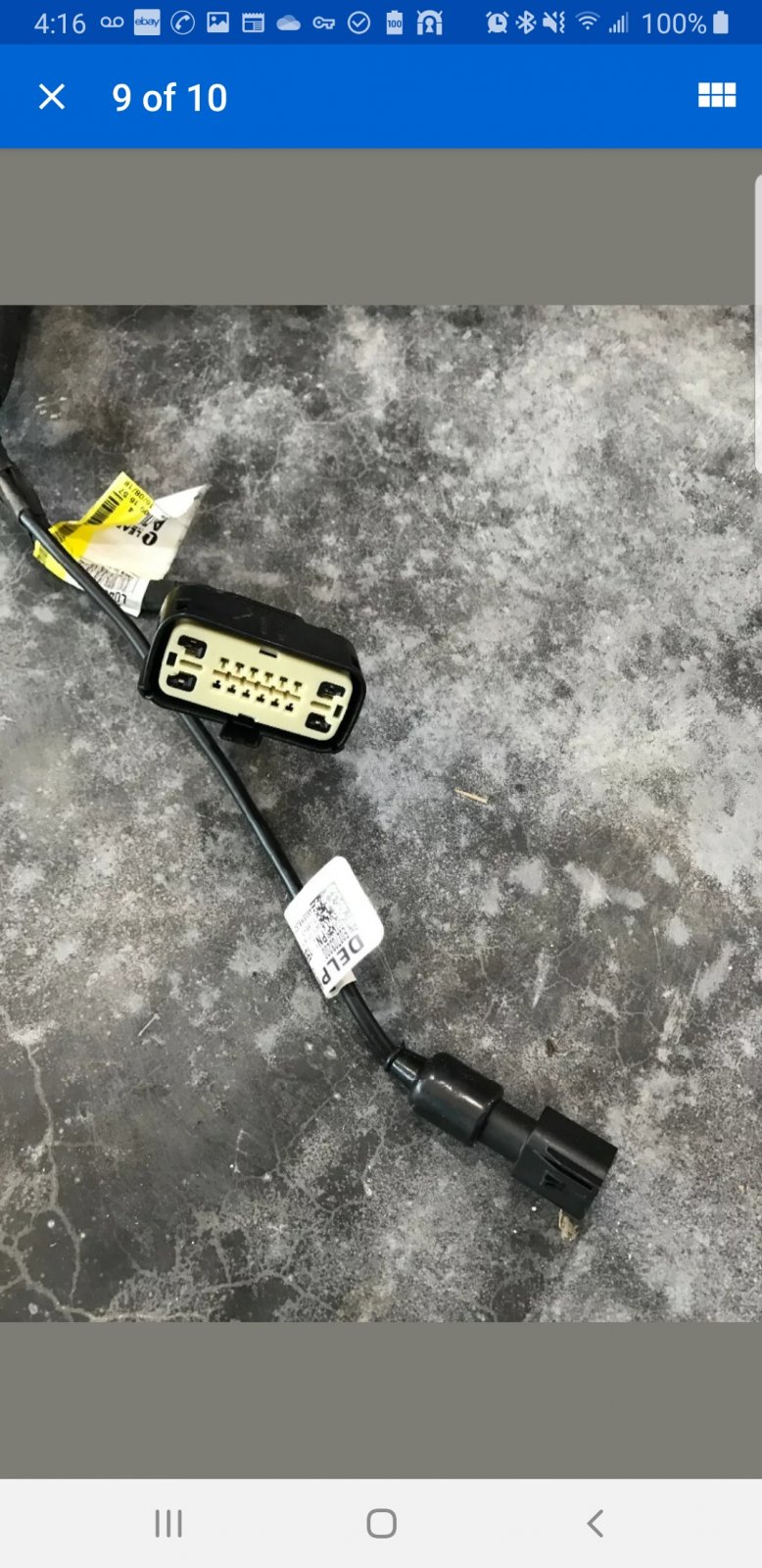

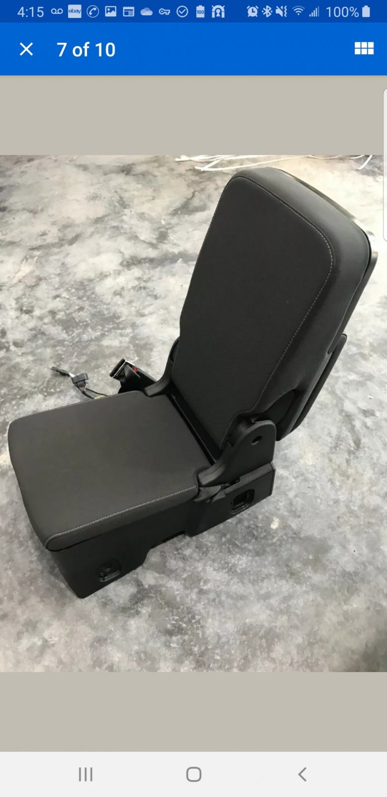

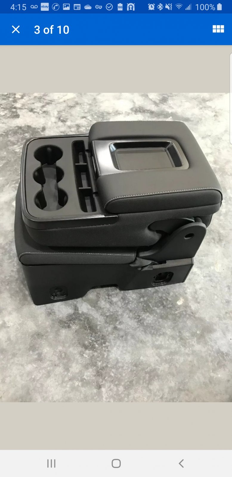

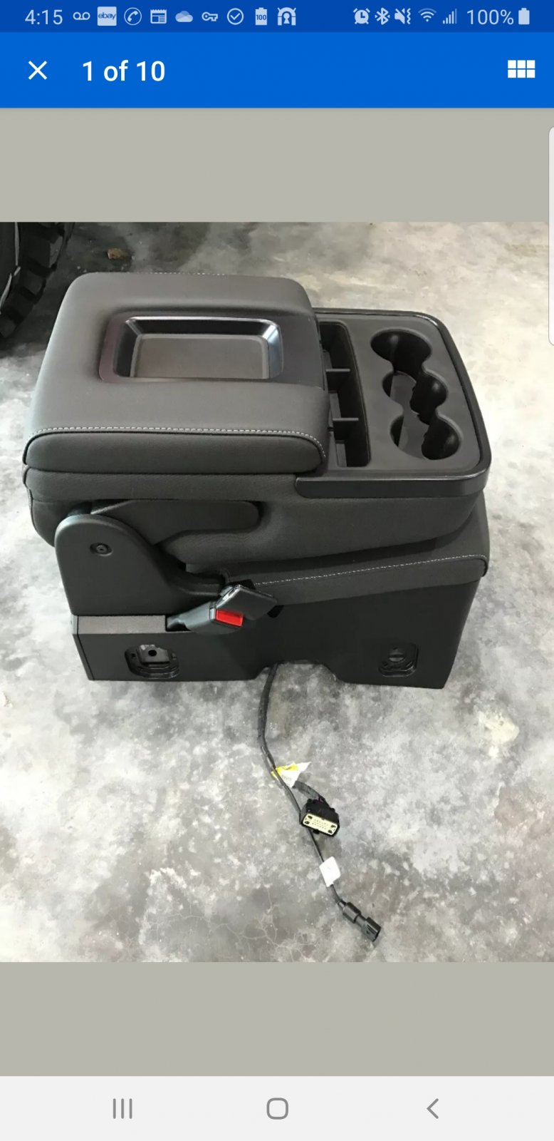

I am talking about the jump seat center console. Does the Sierra/Silverado fit in a Tahoe/Suburban? See pictures attached

It is same part for tahoe as silverado so it will bolt right up, but you have to replace everythng below rear ac on dash, and there will be no place for heated seat controls. Im actually gonna put one of these between my rear captains as an armrest option. Seating for 8 to boot...

The dash flows into the center console, and its full of switches and cubbies. When you turn that area into a place where 2 legs can go, you need to remove a lot of those panel pieces to make the space work. The pieces that make that happen are different from the ones that flow into the hard center console...

I'm looking for information on getting the wiring to work. It has a couple 12 power ports and 2 USB charging ports.
Anyone got a wiring schem or pin out for the plug handy?

I didnt use the wire harnesses, I just spliced a new high speed charger assembly into the rear seat power outlet by going under carpet. Had to take the jump seat apart, but it was pretty straight forward. At first, I just had it plugged in up top so I could remove the seat, but I decided to really bolt it down...
