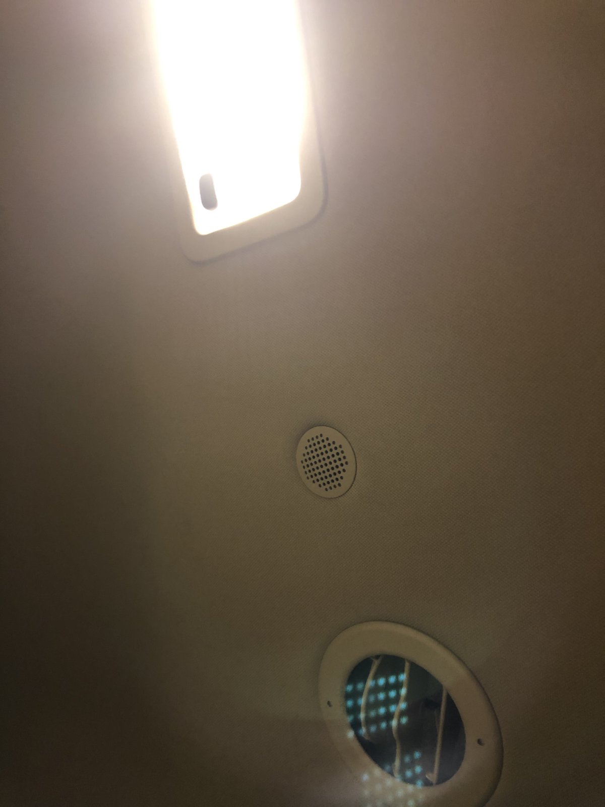

Sure it's not the little interior fan temp sensor thingy in the roof? They make an annoying buzz sometimes.
Did some more listening tonight, and sure enough that little thing was buzzing!̇ thank you!
Was relieved to find it, sorry for all the fuss, but thanks

I guess there’s one in the back of Tahoe too. That’s what it is!
You can replace them for about $20-$30 a piece OR I have heard of people blowing them out with compressed air.
I replaced both of mine and it got rid of an intermittent cooling problem I was having with the A/C.

Here is a pic of mine in the rear, right above and behind the 2nd row seats driver's side on my Tahoe LT.
