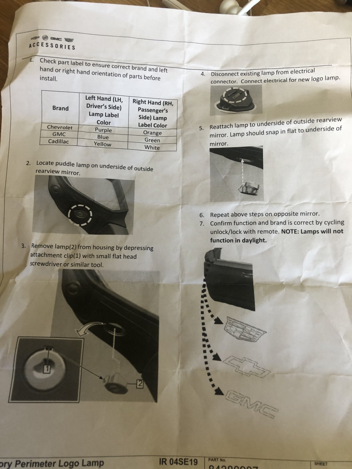

I just ordered the Bowtie led puddle lights. FYI... these are not standard on the high country as numerous articles online had led me to believe. Before I pay the dealer to install, it looks like these have a tab that requires a plastic trim tool to remove and should be fairly easy to install. I don't want to take my mirror apart.

Was kind of pain getting the clip pushed in the factory lights. and make sure that you install them on the proper side as I failed to RTFM the first time.

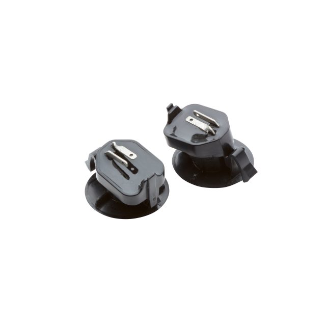

I just bought a set today. Hopefully I can get them in next week. I popped out the stock led light just to see how easy the removal and install would be. It was a piece of cake. All you need is a very tiny flat head screwdriver to push in the tab hole. Once it is pushed in the light tips right out with no problem. The set I got on Ebay was from GM Parts Direct. Total with tax and shipping was $100.69. I will post up pics of the install so folks can see how easy of an install it really is.
