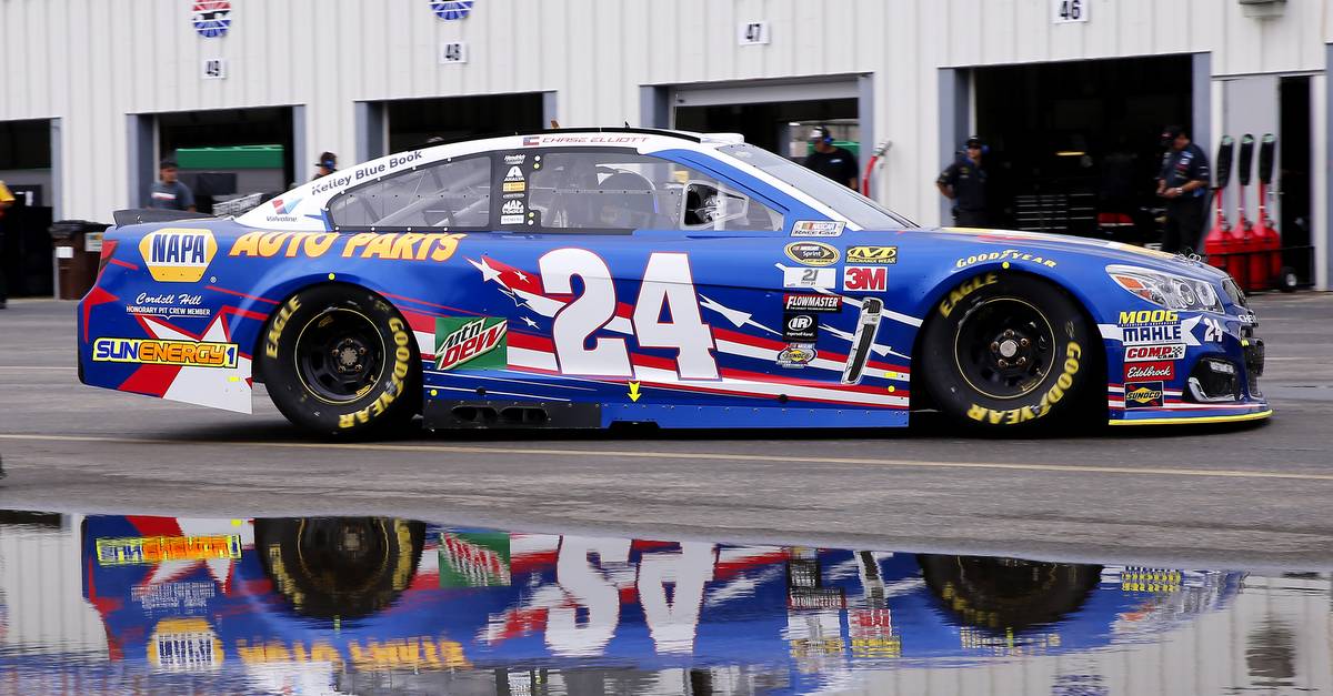

As you've discovered, our spares are on 17" rims. No problem for the brakes. The Police Tahoes are on 17" wheels all around.
Why the bigger wheels with shorter sidewall tires? IMO, the larger wheels and shorter sidewalls are probably a fad. Take a look at the wheels and tires on Nascar race cars. And on Indy cars. And on the Police Tahoes.
The 2016 Police Tahoes have P265/60R17 tires which work out to a 6.26 inch high sidewall. My 20 inch tires are 275/55R20 which works out to a 5.95 inch high sidewall. The Police Tahoes have a taller sidewall on a wheel with three inch less diameter.
I'm looking to replace my non-standard 20 inch wheels with as-delivered 18 inch wheels on my Tahoe when I buy new tires.
With your 2 inch lift you could go larger diameter tires on your 20 inch wheels.
FWIW and your off-road ride may vary. :)
