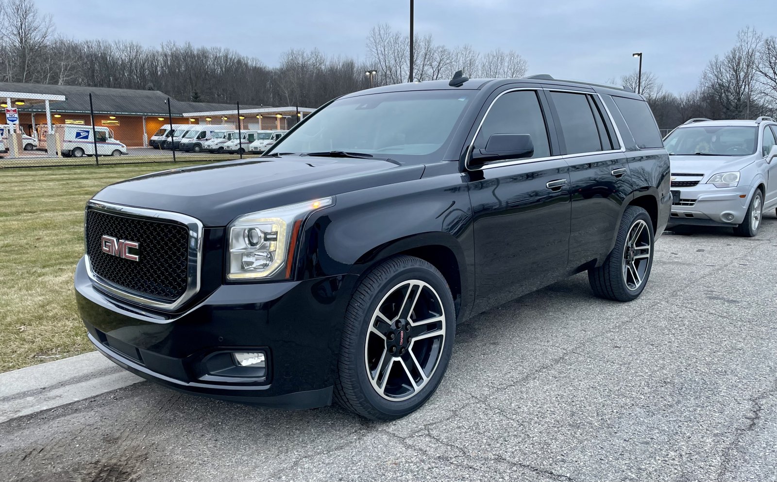

Just an update. Mostly cosmetic. I switched to 22” GMC Sierra wheels from the Carbon-22 package, black mesh grille insert, blacked-out fog bezels, and ditched the running boards. I like it-not as bling.
