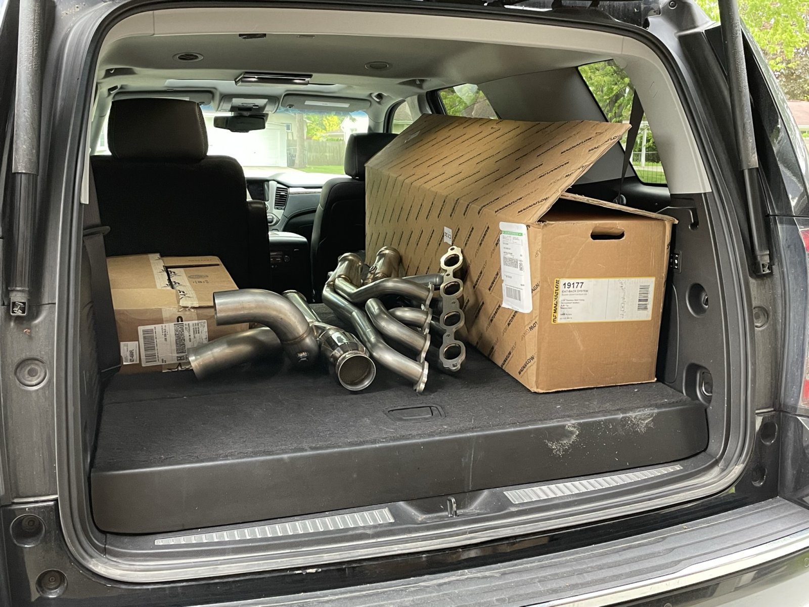

Hi all. A little intro-I just bought a 2016 Yukon Denali AWD. This is my third Yukon. My others were stock but this one I bought specifically to do some work on. My plan is to build a Yukon GT if GMC built one today. I’ve already installed a Texas Speed LT1 cam with AFM delete and phase limiter, beehive springs and new lifters/pushrods, TS stainless long tubes, Magnaflow 3.5” street exhaust, Corsa CAI, new Magride shocks and a MaxTrac 2/3 drop. I’ve also done some dechroming, scored some cheap OEM 22s and trimmed up the front lower balance.

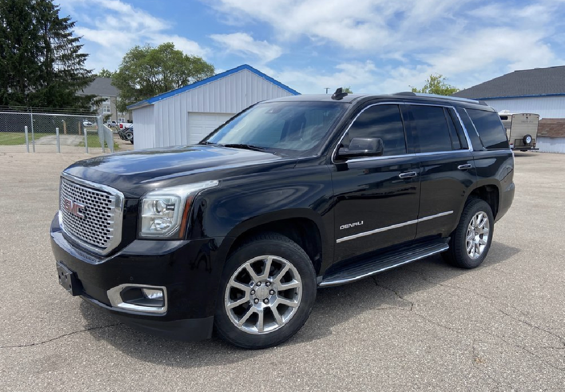

I looked forever for a truck with retractable boards but I couldn’t find one in my budget. I would like to remove these Dumbo-ear fixed running boards and replace them with just side skirts but they don’t exist. So I looked into trying to convert to factory retractable boards. I work at a GM dealership so there’s a chance I can get the parts and have access to the expertise to installed them. Then one day I was walking through the shop and I saw a set of rocker trim panels for a 2022 GMC Acadia. They looked close so I took some measurements. Looks like they will be almost a perfect fit! I grabbed a set that were being thrown away so my next step is to remove a running board and see how they actually mock up.

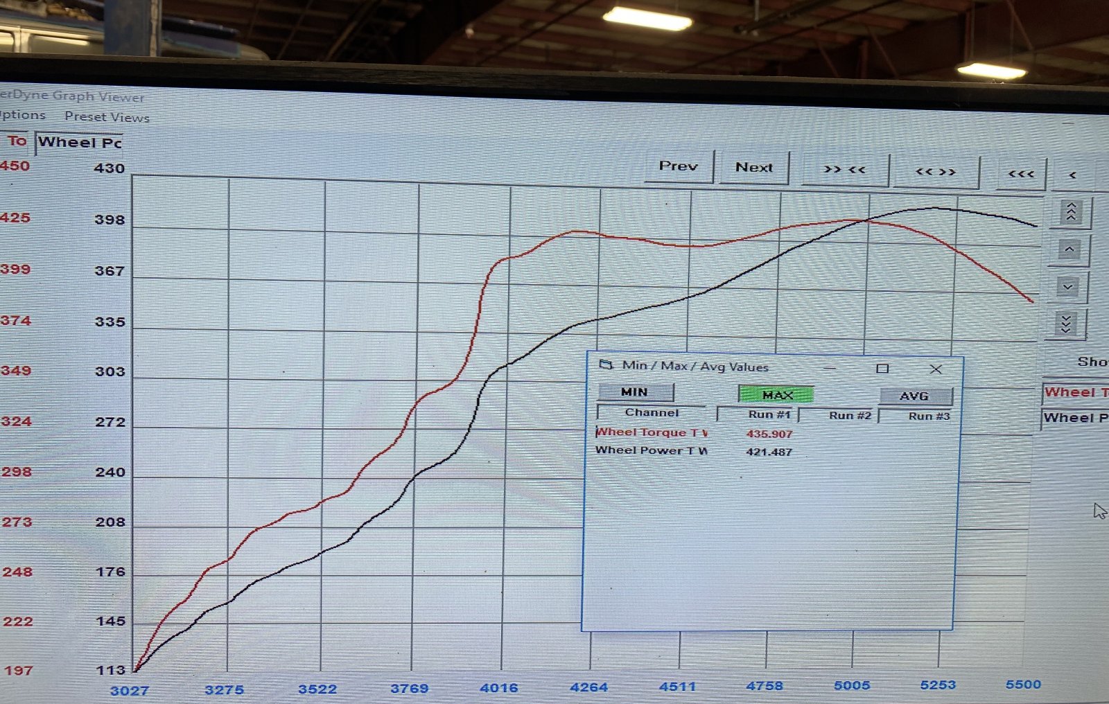

Just picked her up from the dyno shop. 421hp/435tq at the wheels. Trans shift points and converter lockup much improved! 0-60 in 3.9 seconds! However I think the next step is a little stall converter…
Shop estimated 530hp at the crank. Sound right? About 20% drivetrain loss?

On a chassis dyno, power is measured at the rear wheels. The drivetrain sees parasitic losses that reduce actual power numbers at the crank. Most people use a standard percentage of parasitic loss. I did some research on four-wheel-drive trucks and 20% seems to be an average number.
