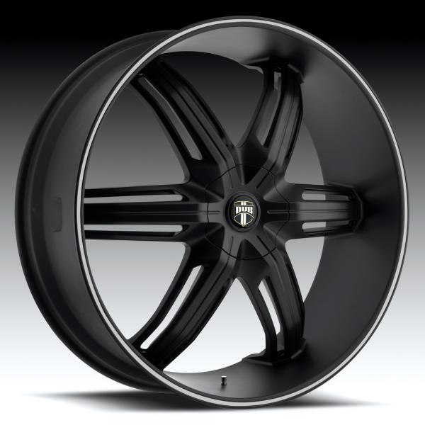

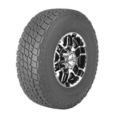

these are teh rims i am thinking of getting for the yuke.. 237 a piece for 18s that i want and thes nitto terra grapplers for 270 a piece free shipping on all of it.. 325/60-18. they should fit ok with the 3 inch body lift right.. they are 33 inches od
