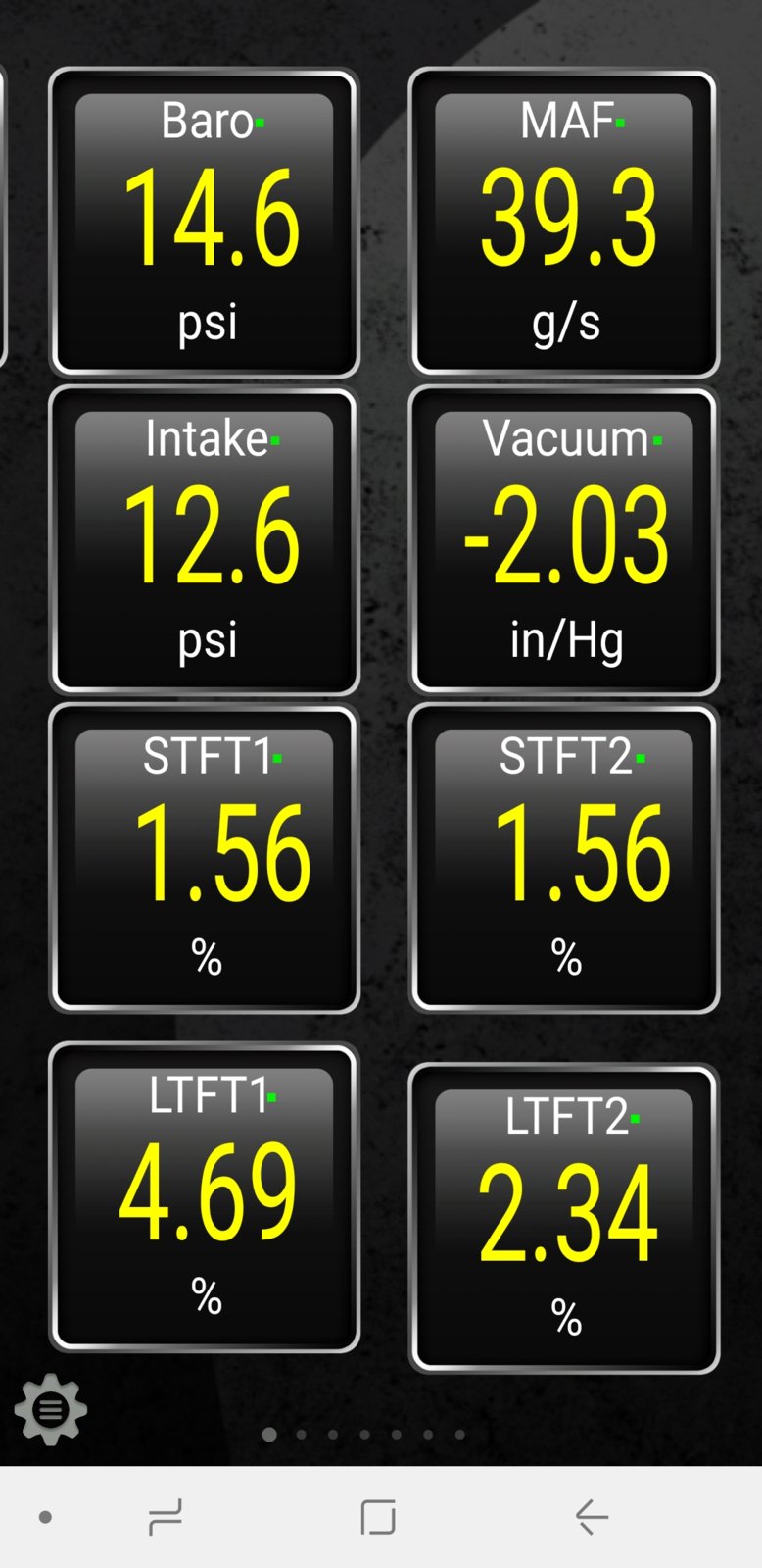

Some screen shots while cruising at 55mph
21,276
30,208
Seems to me you have a leak in your air intake between the throttle body and air cleaner. Assuming your engine temperature was over 140 in the above readout and idling, your MAF reading is right at the upper limit.

Those fuel trims are not showing lean, there is nothing that shows a problem with positive 4 percent fuel trims.
Was that log taken on flat ground at light throttle or going up an incline? If you were at light throttle on flat ground then there is a problem with the map sensor reporting properly. Your vac/pressure shows as just off wide open throttle in that log.
It is common to have a vac leak that shows low vac on the map reading from a vac hose or intake leak, but you would have big positive fuel trims to compensate if that were the case.
The correlation code comes from your Map reading reporting a certain kpa/psi while the Mass air flow sensor reports another, but when the computer compares the two numbers vs things like load and rpm, one or both shouldnt be reporting those numbers. It is sanity checks like that which keep cars from driving into walls if a throttle sticks for example.

Its easy to chase problems and find them while creating others. Huck the old map not maf, in and duplicate the driving condtion while loggin. We breath around 14 psi, unless you are under a slight load, you should not be seeing 2 inches of vacuum or near 14 psi.

Yes, i would like to see the psi/kpa at idle. Do me a favor and change your scanner config over the metric so i have an easier time with it and a little more resolution to what we are looking at. Your truck is showing near 100kpa at part throttle which is the same as having the throttle wide open. I would like to see it at idle to see if it is messed up on scale or something else.
Just keep in mind that those correlation codes happen when the map is where it should be while the maf is where it should be or visa versa.
This is a very simpe problem to sort out. You have it nailed down to verifying the reason why the map isnt reporting properly.
Unless you have a 260/270 cam in that thing, it wont run at 2 degrees vacuum at cruise. And if it was a vacuum leak at the manifold you would have nasty fuel trims to show for it.
Keep the same map, log the manifold vac signal. If it is above like 30kpa at idle for a stock tahoe, then you know the signal problem is liner.
