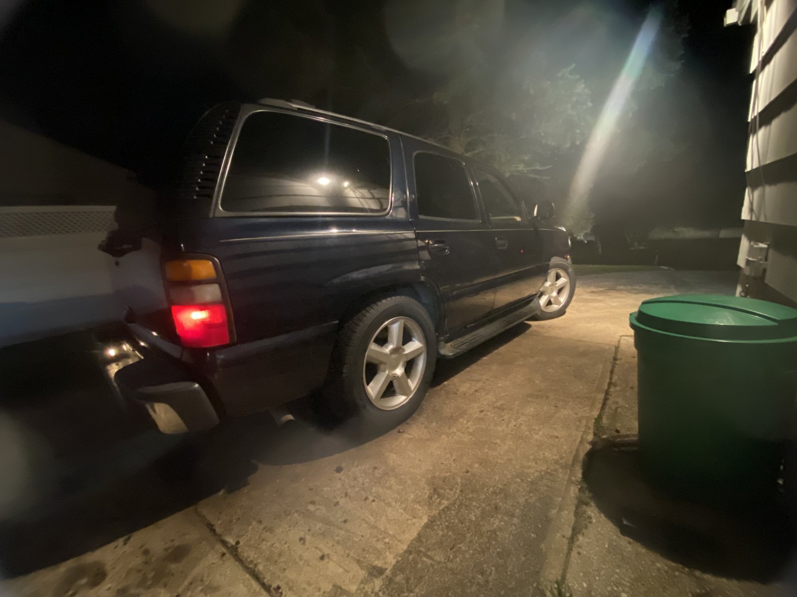

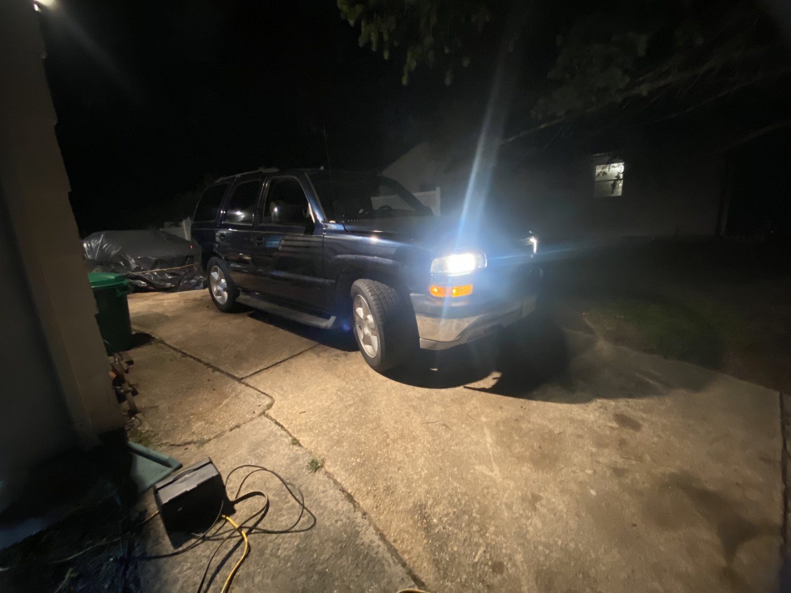

Here’s a few pictures of the truck. Going to get this thing aligned tomorrow and tear up some pavement.
45,011
Here’s a few pictures of the truck. Going to get this thing aligned tomorrow and tear up some pavement. View attachment 409403View attachment 409404
I've been MIA for a few days. Is it lower in the back? You have to put some miles on it to let the new springs settle. If it's squatting, you can adjust the front for free by turning the torsion bar adjusters. This is where measuring each corner comes in handy. GM vehicles are often lower on the driver side. Having the type of suspension yours has, you have the ability to easily fine-tune it side-to-side. If you're satisfied with the way it sits and have already gotten the alignment, disregard.
