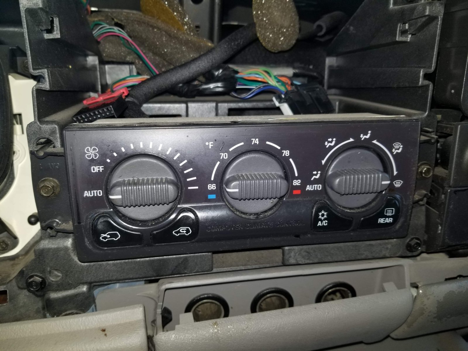

This is what my control panel looks like ...

ok so it has "auto" which means you should have temp sensors, have you checked those? they should have 5v power to them and they should have resistance that changes with heat applied, I would suspect that is either not getting a reading or something is shorted but that should give a code I would think. a tech2 should able to see those readings and what the temps are and what is desired.
does it have separate rear heat control?
seems weird that it would have auto / computer control and not take firmware
have tried looking for any tsb's that describe this problem?
just trying to help, not an expert!
