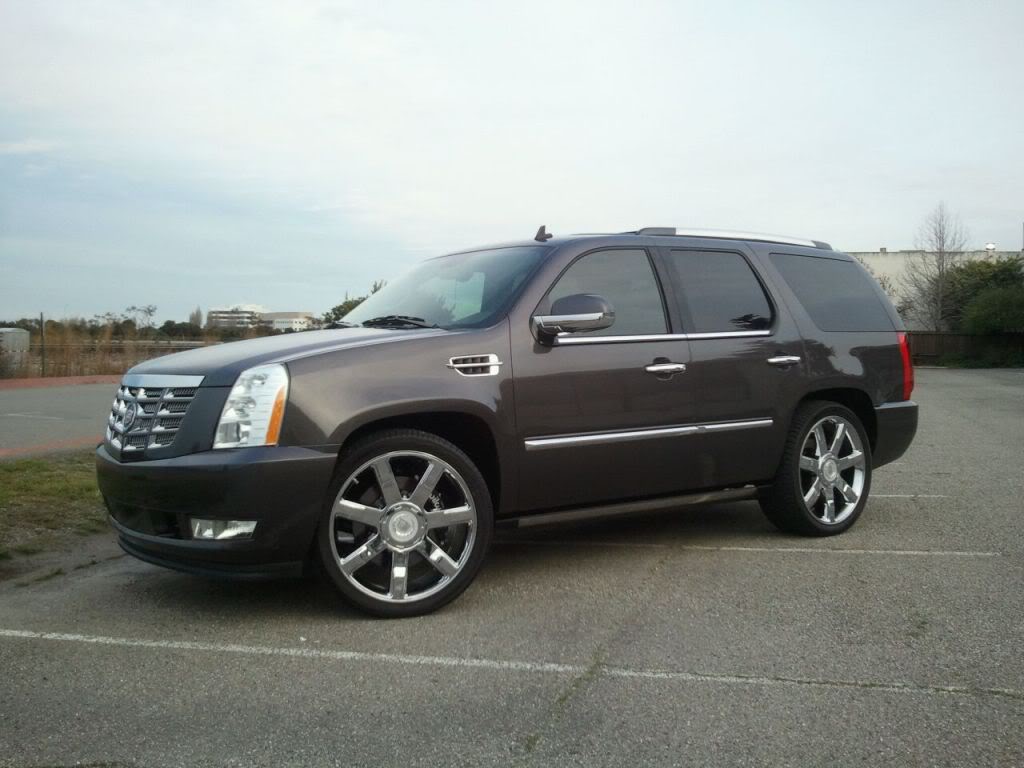

btw here is my truck on the 2/3-4 kit belltech
stock mine was a 26 3/4 and 27.5 rear
after drop 24.75 and 25
then today did my strut mod again with my custom rear springs
33 9/16 and 33 3/4 rear
