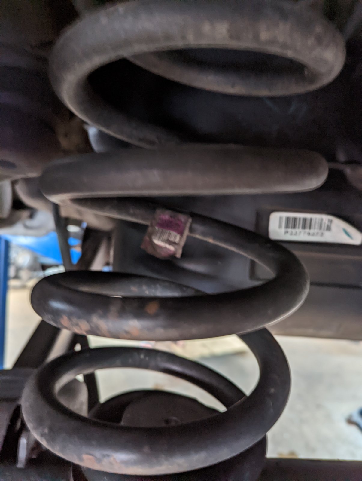

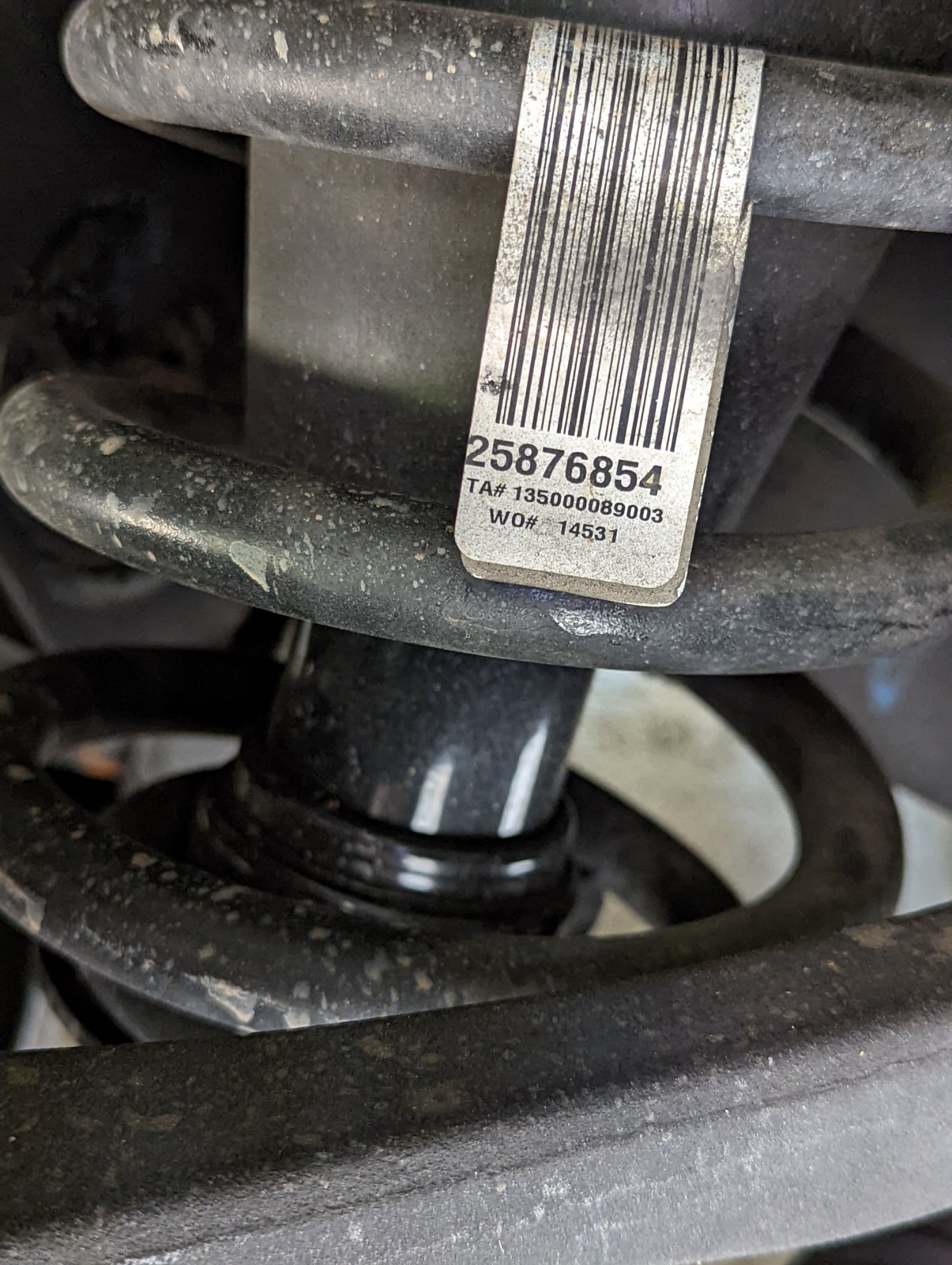

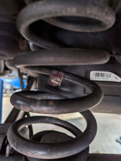

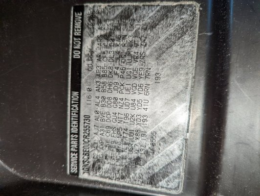

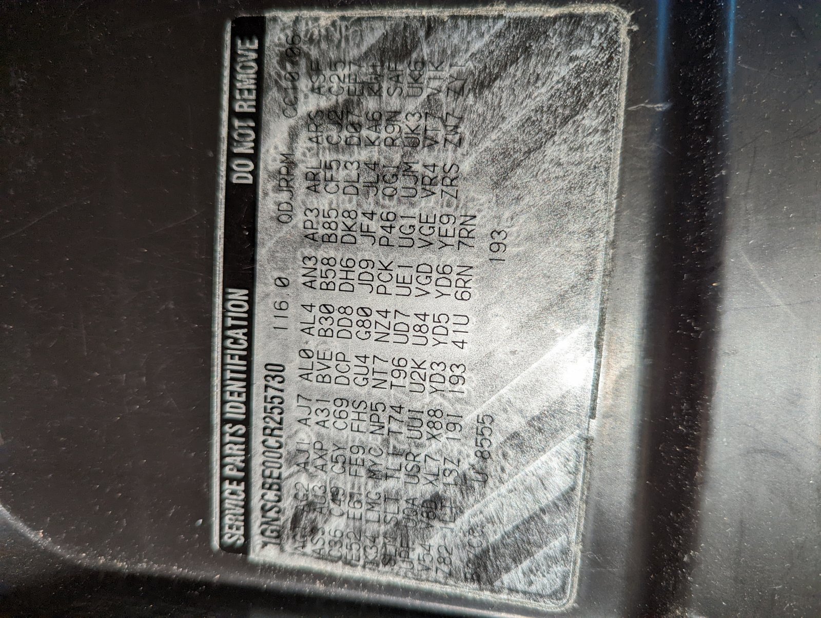

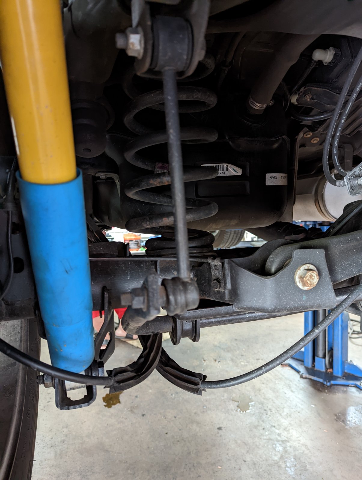

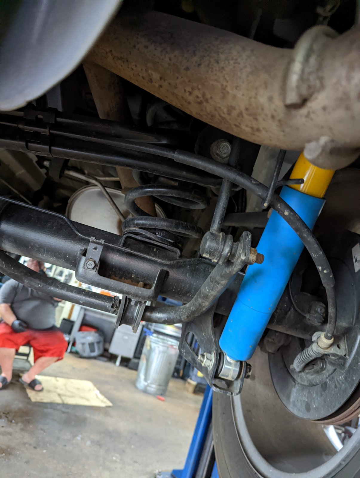

Well, after lots of driving and thinking on this issue I think my next move is to talk to Bilstein and find out what coils are made to work with the 4600's I have in the rear and the ACDelco front struts.
(ACDELCO 540615 (540-615) Strut).
I'm attaching pics of my codes and the springs currently installed. My assumption is they are original.
I love everything about this Tahoe except for its harsh ride over 40 mph.
My mechanic of 20 yrs drove it and said "I see what you mean but it ain't terrible". I agreed but it did not drive like this off the lot. I want a premium smooth ride.
Thoughts @swathdiver - @iamdub

On your front strut assemblies, what parts other than the shock was changed? Why don't you flip those upside rear shocks around and see how she rides?
Oh, what wheels and tires are you running? How old are the tires and what air pressure do you run in them?
These are trucks that were designed to haul a load. Without a load on, they do bounce around a little.
I had my spare out for about a month once and the ride was noticeably worse. On another occasion, I was carrying around about 75 pounds of junk all the way in the back for about a week and the ride was noticeably smoother.

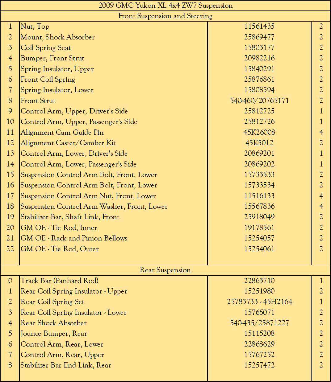

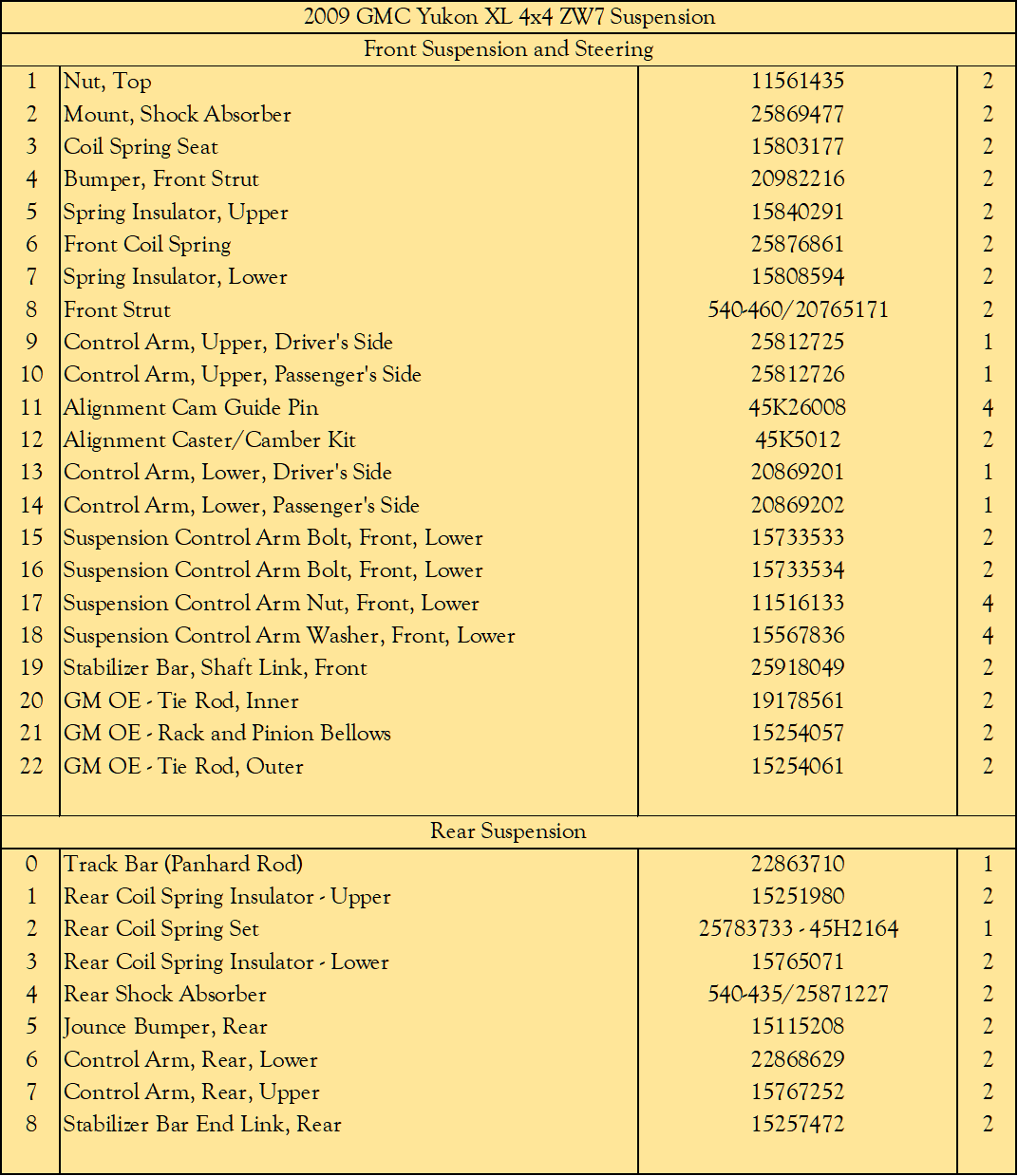

In the chart above, 1 through 8 make up the parts of the strut assembly. I foolishly re-used #2 on mine, they are still good but they will probably wear out soon and have to be replaced. #3 could probably have been used again but it did have some wear as well. #4 was falling apart and #5 and #7 were well worn. Some just stick a new shock in there, call it a day, and are happy as clams.
Is there anything about that mount (#2) that can make the strut feel really firm when it comes to absorbing shocks? My problem, and I believe it's the same for Mark, is that the slower up and down cycling is fine. It's the sudden, sharp upward jolts that aren't absorbed and are transferred to the frame, body and passengers. Like the compression is valved too stiff. I just don't see anything about it that'd affect the ride quality that much, assuming it was in "operable" condition and not completely worn out with lateral slack in it. I'd hate to make a $180+ gamble and get nothing more than clean, shiny metal bits.
