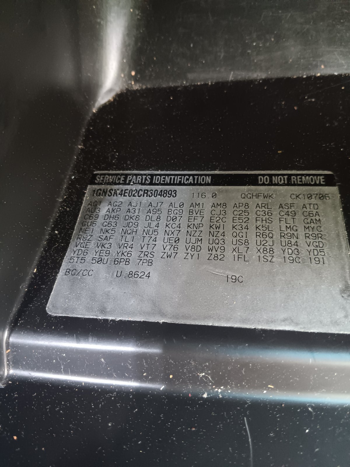

They (the garage) want to confirm what trim they're dealing with. Im attaching the glove compartment codes for reference.

We aren't seeing the picture, so please use the "Attach files" button at the bottom of your post, or drag a *.jpg or *.png or the like into the body of the post.
Sorry, I didn't realize it didn't upload, I have no idea why it won't but I'm working on it

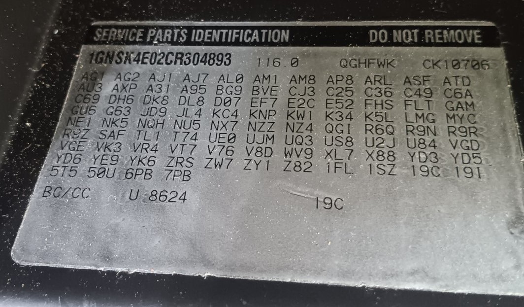

Ok, so I'm not crazy. Good to know.... I'm still wondering how the dealership determined it was a PPV, guess they didn't run the vin and just said "yup"

Hey y'all, thanks for the replies... I tried to post the RPO to as many as I could. I guess the dealership just looked at it and said "yeah, it's a PPV" Next step is installing a bigger capacity transmission pan and 3.73 gears (camper towing). My fluid temps get to 240°f and I know these trannys have a history of not being the greatest

... told by the previous owner and Hendrick Chevy that I have a 4x4 tow package PPV.
Apparently, according to the dealership, Chevy did in fact make PPV models with those options.
I was under the impression that 4x4 was automatically SSV.
Could swear remembering Chevy PPV press material bragging about the debut of an AWD PPV, not for the GMT900.
Unless I'm mistaken it was the GMT1UC-PPV that gained AWD - but NOT 4WD with low range.
This was to better compete with the FoMoCo Police Interceptor Utility with AWD.

In 2012, the 5-6 VIN positions are for the vehicle type. A K2 would mean a 4x4, 1/2 ton Chevrolet Tahoe Police Vehicle. This truck is a K4, meaning a 4x4, 1/2 ton Chevrolet Tahoe FL, or fleet vehicle.
RPO GAM identifies it as being built for government use. It did not originally come with a G80 locker, just 3.42 gears. Very common with Chevrolet.
I'd be interested in learning what 1FL and 5T5 spell out.
Cool truck regardless.

K5LEQUIPMENT Enhanced Cooling Package
KC4COOLING SYSTEM ENG OIL
KNPCOOLING SYSTEM TRANS, HD
KW1GENERATOR 160 AMP
LMGENGINE FLEXIBLE FUEL, (GAS/ALC), 8 CYL, 5.3L, SFI, V8 OHV, CYL DEACTIVATION, IRON, GM
MYCTRANSMISSION AUTO 6 SPD, HMD, 6L80
NE1CERTIFICATION EMISSION, GEOGRAPHICALLY RESTRICTED REGISTRATION FOR VEHICLES UP TO 14, 000 LBS GVW (USE 2003 MDL Y
NK5STEERING WHEEL STANDARD
NQHTRANSFER CASE ACTIVE, TWO SPEED, SWITCH ACTIVATED, ALUM
NU5EMISSION SYSTEM CALIFORNIA, BIN 4
NX7WHEEL 17 X 7.5, STEEL
NZ4WHEEL SPARE 17 X 7.5, J, STEEL, DESIGN 2
NZZSALES PACKAGE SKID PLATE, "OFF ROAD" SPOT
QGITIRE ALL P265/70R17-113S BW R/PE ST TL AL2 (PAFE)
R6QCONTROL SALES ITEM NO. 16
R9NCONTROL SALES ITEM NO. 89
R9RCONTROL SALES ITEM NO. 92
R9ZCONTROL SALES ITEM NO. 100
SAFLOCK SPARE TIRE, HOIST SHAFT
T74HEADLAMPS CONTROL AUTOMATIC, DELAY
TL1GRILLE SPECIAL
U2JDIGITAL AUDIO SYSTEM S-BAND "NOT INSTALLED"
U84ANTENNA BODY SIDE WINDOW, RADIO
UE0COMMUNICATION SYSTEM VEHICLE, G.P.S.---NOT INSTALLED
UJMTIRE PRESS INDICATOR MANUAL LEARN
UQ3SPEAKER SYSTEM PERFORMANCE ENHANCED AUDIO
US8RADIO AM/FM STEREO, SEEK/SCAN, CD, AUTO TONE, CLOCK ETR, MP3, RDS
V76HOOK TOW
V8DVEHICLE STATEMENT US
VGDFASCIA FRT, CUSTOM, BODY COLOR
VGEFASCIA RR, CUSTOM, BODY COLOR
VK3LICENSE PLATE FRONT FRT MOUNTING PKG
VR4TRAILER HITCH WEIGHT DISTRIBUTING PLATFORM
VT7OWNERS MANUAL ENGLISH LANGUAGE
WV9MERCHANDISED PKG VALUE LEADER
X88CONVERSION NAME PLT CHEVROLET
XL7FREQUENCIES RATING 315 MHZ, LONG DISTANCE
YD3AXLE (BASE EQUIP) FOR SCHEDULING GVW PLATE
YD5SPRING FRONT BASE EQUIPMENT
YD6SPRING RR, BASE EQUIPMENT
YE9CONVENIENCE PKG COMFORT & DECOR LEVEL #3
YK6IDENTIFICATION (SEO)
Z82TRAILER PROVISIONS SPECIAL EQUIPMENT, H.D.
ZRSTIRE SPARE P265/70R17-113S
ZW7CHASSIS PACKAGE PREMIUM SMOOTH RIDE
ZY1COLOR COMBINATION SOLID
Thank you!! Appreciate it!
