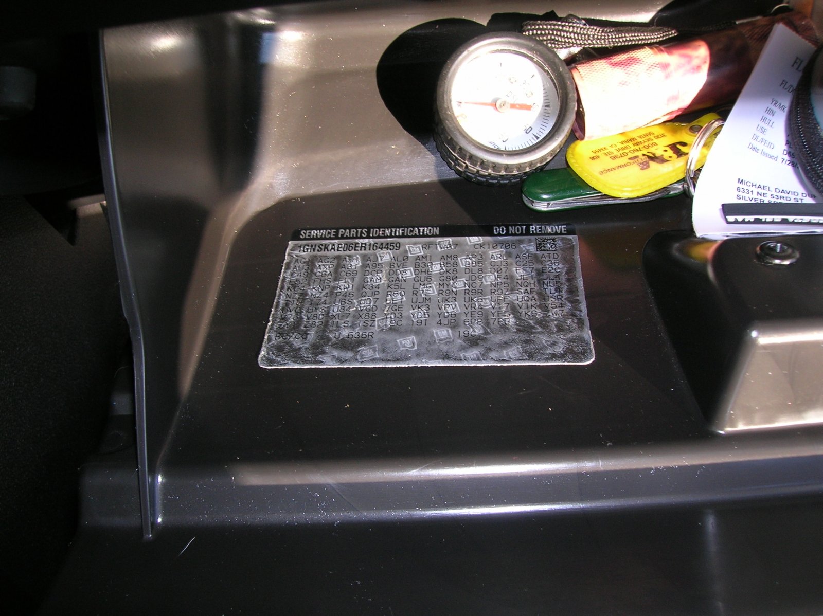

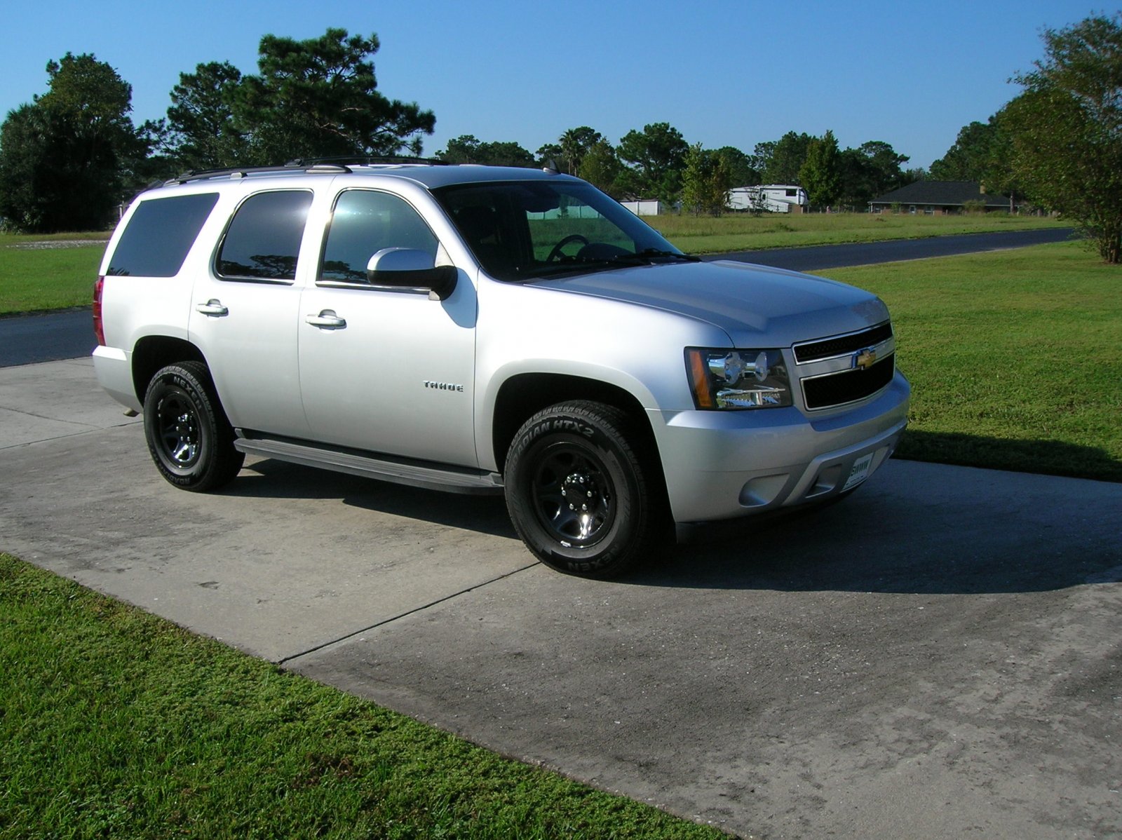

Howdy, boys:
Several months ago I bought a low mileage 2014 Tahoe. It was represented as an LS, and it may be. But I was looking at the glove box codes the other day and it has "VPV", which is the code for Kerr Industries. As I'm sure you know, Kerr does the police and emergency vehicle mods for GM there in Arlington. I called Kerr and they said they didn't know; they could not find a record on my VIN. (I understand that - it's 10-years old.) I can't find any spare wiring harnesses, it does not have rubber floor mats, no extra dome lights, no holes drilled in the roof, etc. It does seem to have a fairly stiff ride. It also has an "X88" build code (Chevrolet conversion) and an "NC7" (Federal Emissions override) - whatever those mean. The only other things I can say is, it was bought new by the U.S. Air Force, it is silver in color, and I love it. Oh, it came to me with stock cast aluminum wheels. However, they were suffering from a breakdown in the clear coat finish, so I put different wheels on it; the point being, it did not have steel wheels on it when I bought it.
I'm thinking if the air force bought it new, they probably got a bunch. Maybe they were used for base security, or assigned to a ranking officer? Is anyone familiar with this type air force Tahoe? If so, can you tell me why it went through Kerr Industries? Much obliged.
P.S.: It is 4X4.

What's the VIN?
If you don't want to share it with us, cut'n'paste your VIN in place of the Buick RoadMaster VIN.

ssv, for all 4X4, pursuit vehicles were 2wd

The 2007-2014 Chevolet Tahoe came in PPV (Police Pursuit Vehicle) and in 2wd only. If you opt'd for 4x4 you got the SSV (Special Service Vehicle). Kerr industries does the police package install for Chevrolet. If you vehicle had a spotlight, headlight flasher, provisioning for siren, siren speaker, corner led light holes then Kerr made that happen. As soon as the Tahoe rolls off the assembly line it goes about 5 minutes away to Kerr industries which is on property in Arlington Texas at the GM Plant. When we order our squad cars we have Kerr do the complete police equipment install. Most federal government orders have carpet and a few other options made specially for the feds. I know border patrol tahoes have their own lifted suspension and under engine bracing right from the factory. You will know its a federal ssv if it has a special top speed limiter at 99mph on the 2007-2014 SSV's. Hope this helps some.
L
Lil Timmy Shy
Aug 6, 2024
46
48
Thanks. That helps (I think). My SSV(?) has none of the above that I can see. However, it clearly has the production code indicating it went to Kerr for something. "What" is the question, and I guess I will never know..........

That was probably a recruiter or DOD vehicle. When you go above and beyond in armed forces and they don’t want to lose you, the perks rain down.
Someone probably finished out the tail end of their 20 or 30 year career in that vehicle. Great find and a really cool piece of history.
It’d be kinda cool to place a very small shield on the back to pay homage.
