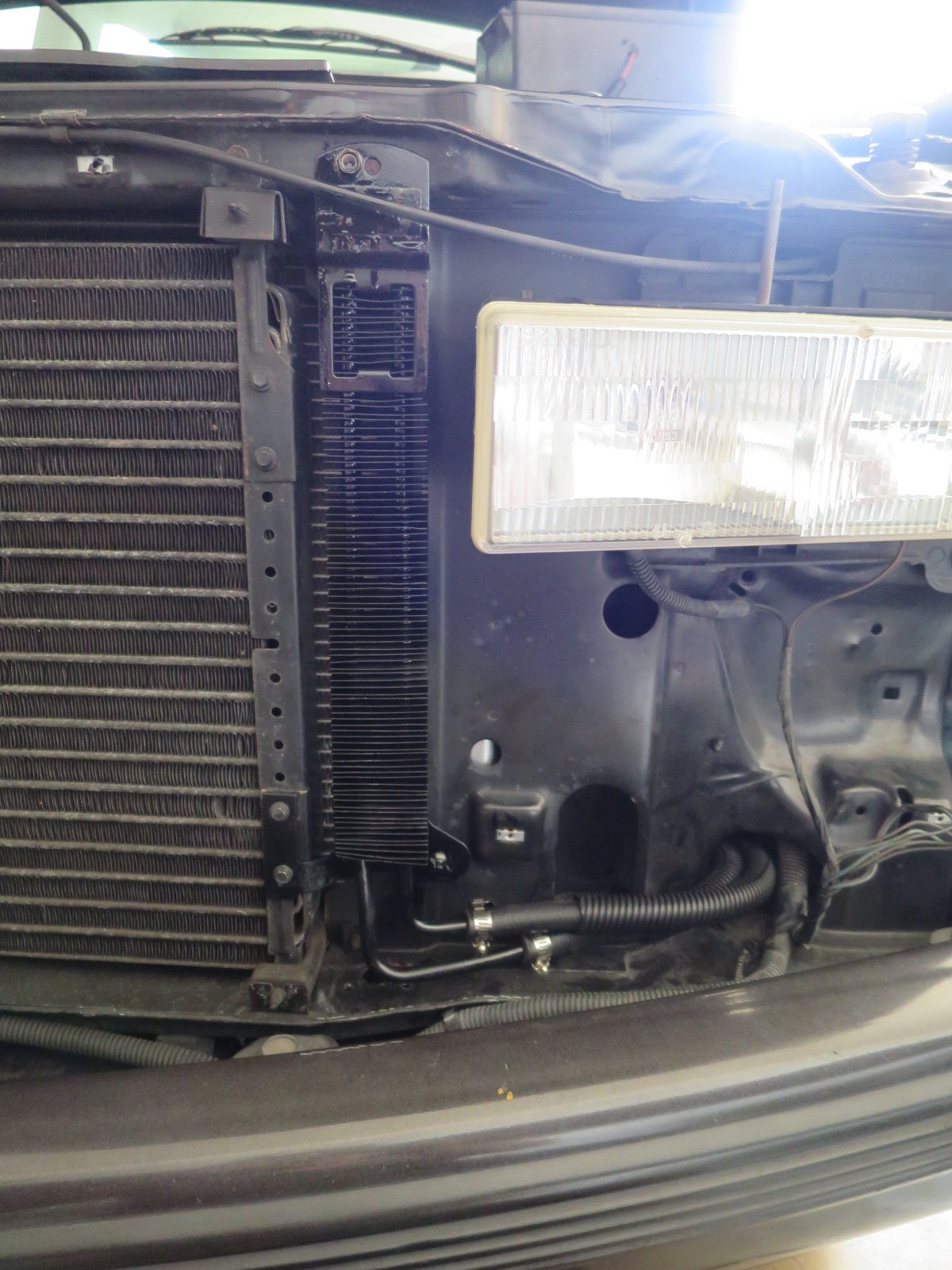

you should have a stock one already it's on the drivers side next to the radiator, just follow the power steering lines.

I thought yours was a nbs for some reason, you could probably retro fit a nbs one in there fairly easily
I looked at all the OBS pickups 2500, 3500 and they were all the same. I didn't think to look at the NBS. It's cheaper, almost identical size, but with the wrong hoses :)

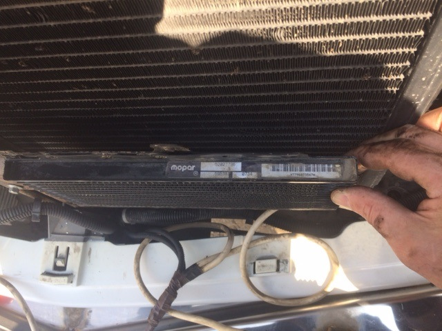

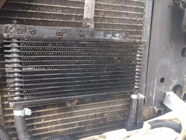

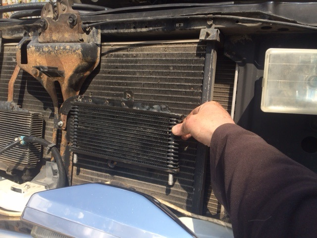

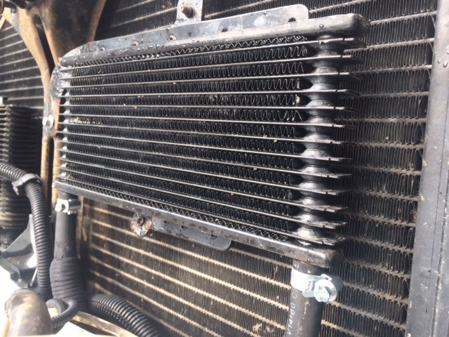

Still not plumbed in, but finally got it fitted.
Couldn't work out where it was supposed to go until I looked at a diagram in a 95 service manual. Cobbled a bracket together for the bottom, and I think I put the screw at the top in the wrong hole as it looks more pissed than it should be.
