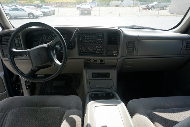

Mine is currently at the body shop for rust repair, but here's a picture I found of another. The door is missing. I've seen pictures of the dash with the radio and heater controls out and it appears there's a soiid plastic panel under the heater controls that prevents easy access. It looks like I might be able to remove the area of the console where the cassette deck is and reach up from there, but I figured that someone must have done this before and might know if that's possible or if there is an easier way.

You can try pulling the driver side knee bolster panel, see if you can get at them that way. Otherwise, the trim for the center console is just held in with a couple screws and clips. Doesn't take 5 min to pull out.

Well, in replacing the factory radio and redoing the bulbs in my HVAC system, I saw that there is actually a plastic cage that holds the radio and HVAC controls. It looks like it's held in with 4 screws, but that's deceptive. I took those 4 screws out to try and access the back of the power plugs on the dash, but no joy. The cage still seems like it's being held in by something. So, rather than chance breaking things, I think I'll just cut out the power port/lighter blank in the console interior and install the USB/3.5 mm plug there instead. I'm assuming it should be fairly easy using a hole saw.

That cage is held with pop rivets. Either 2 or 4--it's been awhile since I've been in there. If you change that plastic cage to the 03-06 style that will allow you to install a double din radio.

Actually, I was able to install a short chassis double din JVC without modifying anything. I just got an aftermarket dash bezel made specifically for that purpose. I also just ended up drilling out the cut-out in the console to install the 3.5mm/USB combo plug for the radio. Overall, a pretty easy install.
