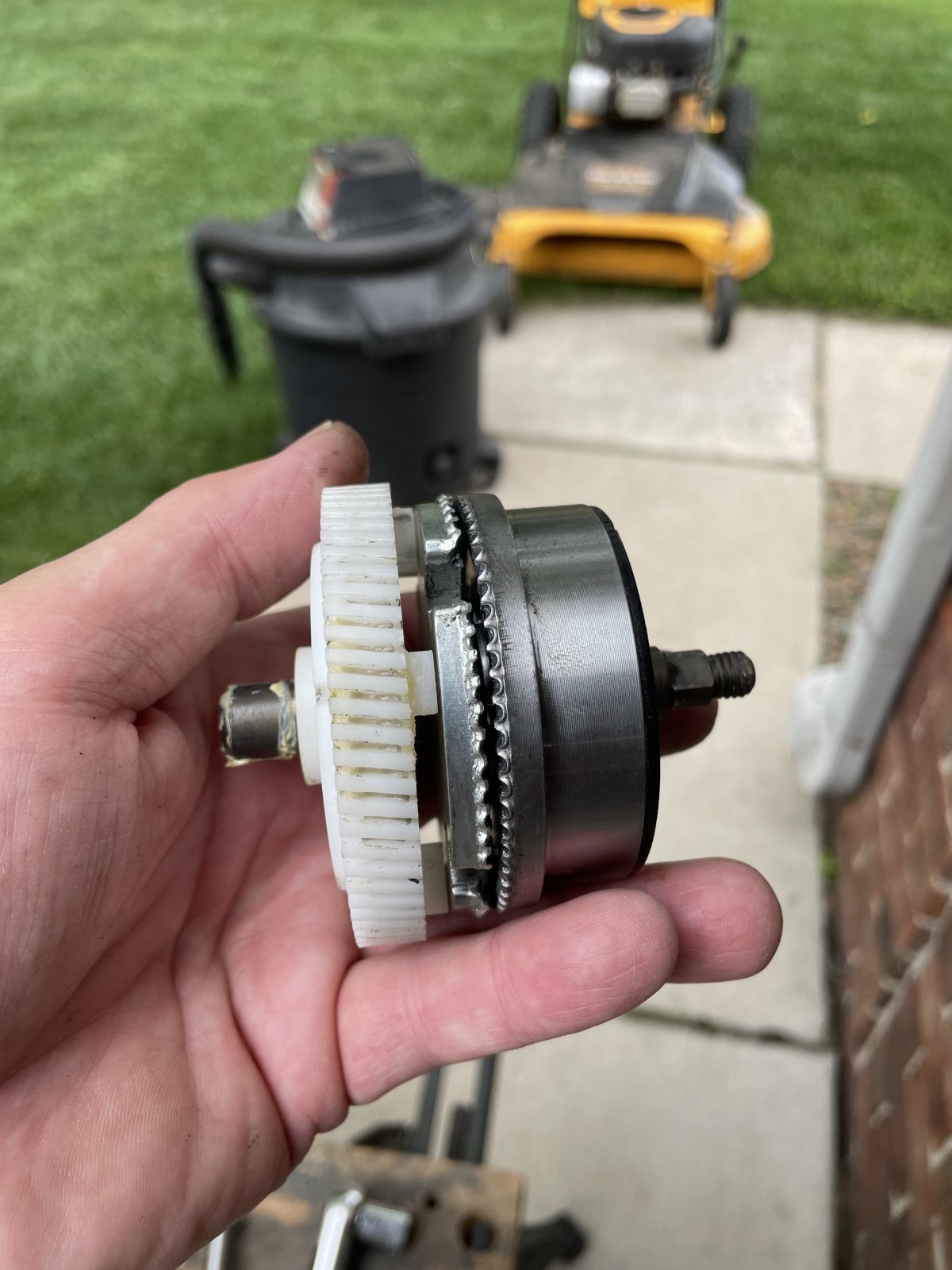

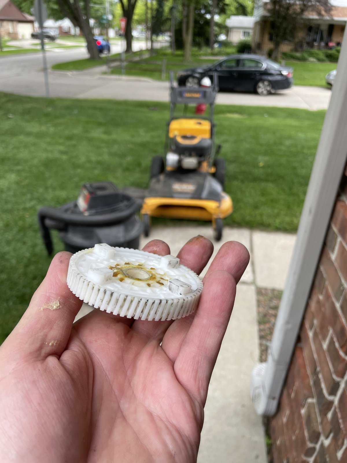

I did that but it didn’t fix it.
The nylon gears look good, no sign of wear.
