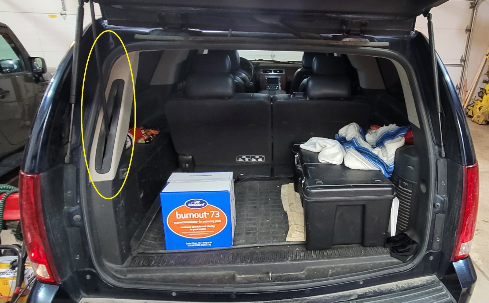

The lift/lower mechanism is the separate arm on the driver's side of the tailgate. Circled item pictured below. The struts are just your basic gas shocks. The arm does the actual lifting/closing.
I didn't save any of my searches, just went down a rabbit hole of Googling. The actuator/lock, the piece I replaced, must send some kind of signal to the lift motor to raise or lower the tailgate. Obviously, that wasn't happening. I do have a Tech 2, but I haven't played/learned with it much, and couldn't discern anything wrong digging into it.
So replacing the actuator/lock was an educated guess, hence my reluctance to spend $$$ on the Delco unit. But replacing it fixed the problem completely. Operates as good as new.
I will look but on the 2018 Suburban, I don't remember seeing that arm. The two struts are beefier and as said earlier, I believe there is a cork screw effect in the driver's side, left strut. Maybe, just maybe, that lock actuator does still send the signal for the left strut to push up or pull down the liftgate. Thanks for the info and the pic.
Yup, different system. My bad.
