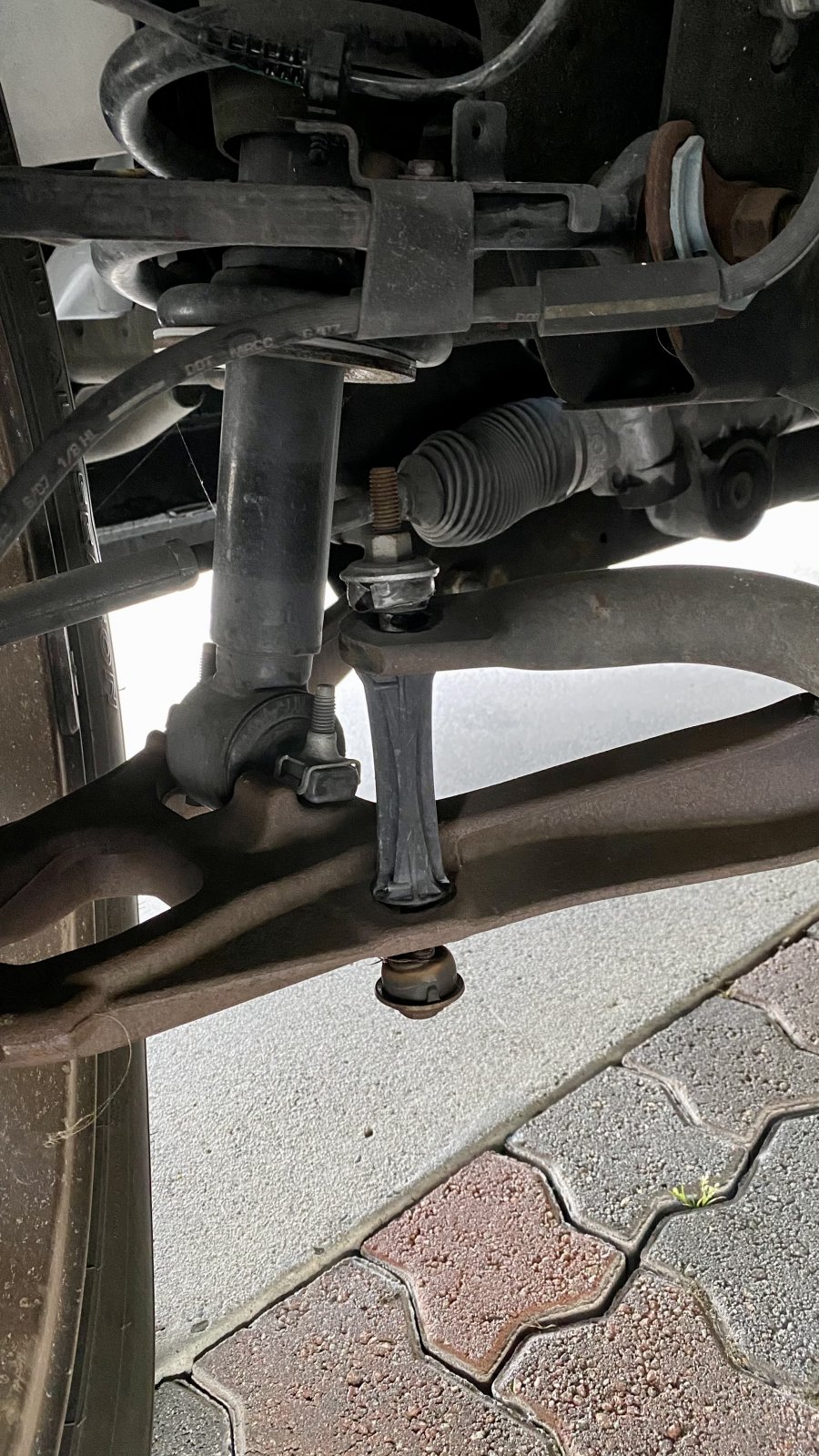

Take a look at your sway bar end links. If you’ve never replaced them, the bushings are probably falling apart. Easy to replace on your driveway.

Bingo! Thanks a ton! This is the problem. And on both sides too! I'll be replacing tomorrow. Saw a couple of videos and looks fairly straight forward.

Yup, sway bar bar links. Thanks. Replacing tomorrow.
