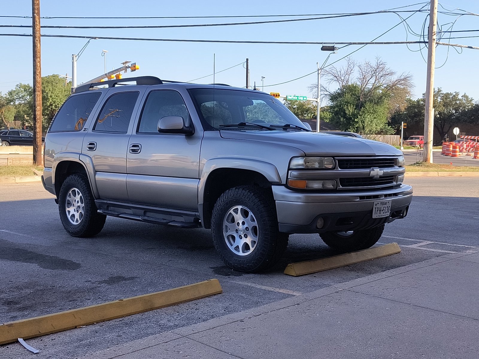

2002 Z-71 Tahoe, 225k miles.
Driving down a lot of dusty dirt roads, this code is common for the clogged evap solenoid, so I replaced it and reset the light.
2 days later, it's back. Upon searching for what's next, I just get a ton of vids "it's this, it's that, no you have to replace this" ect ect.
One clue that may help diagnosis, is that it does not have issues filling up, so I am not sure if this means the charcoal canister is probably ok, or whether it can still be the issue. It also does not smell like gas when idling, (I heard purge valve can cause this??)
The other part that I heard gets killed by dust is the fuel tank pressure sensor on top of the tank.
Anyway, instead of throwing money into a hole until the light goes away, does anyone with more experience with this have any advice on what the next thing to check or replace should be?

Nice truck BTW :)
