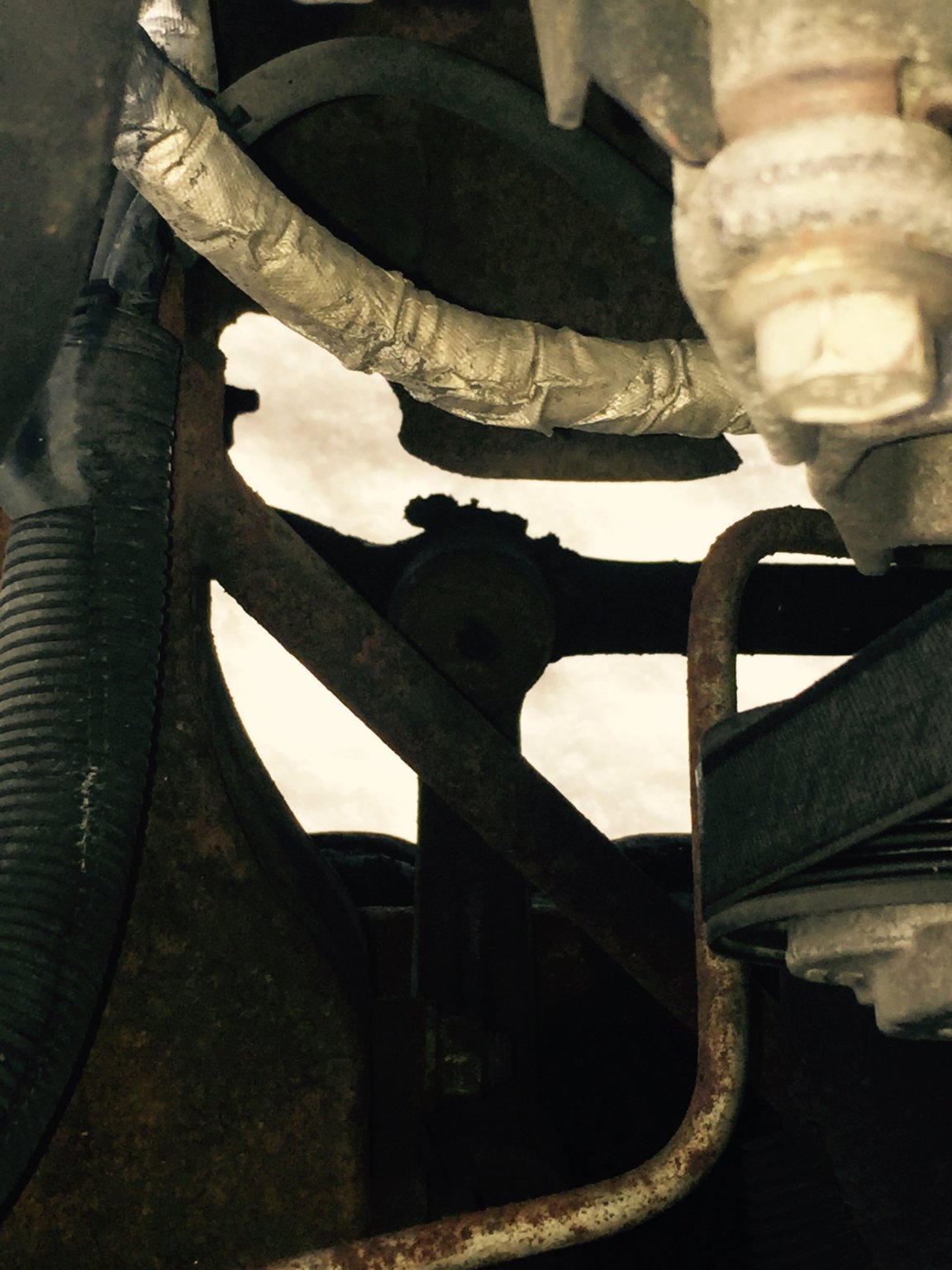

Ok I'll look into that, can you tell me what that is way at the bottom? It has some corrosion
