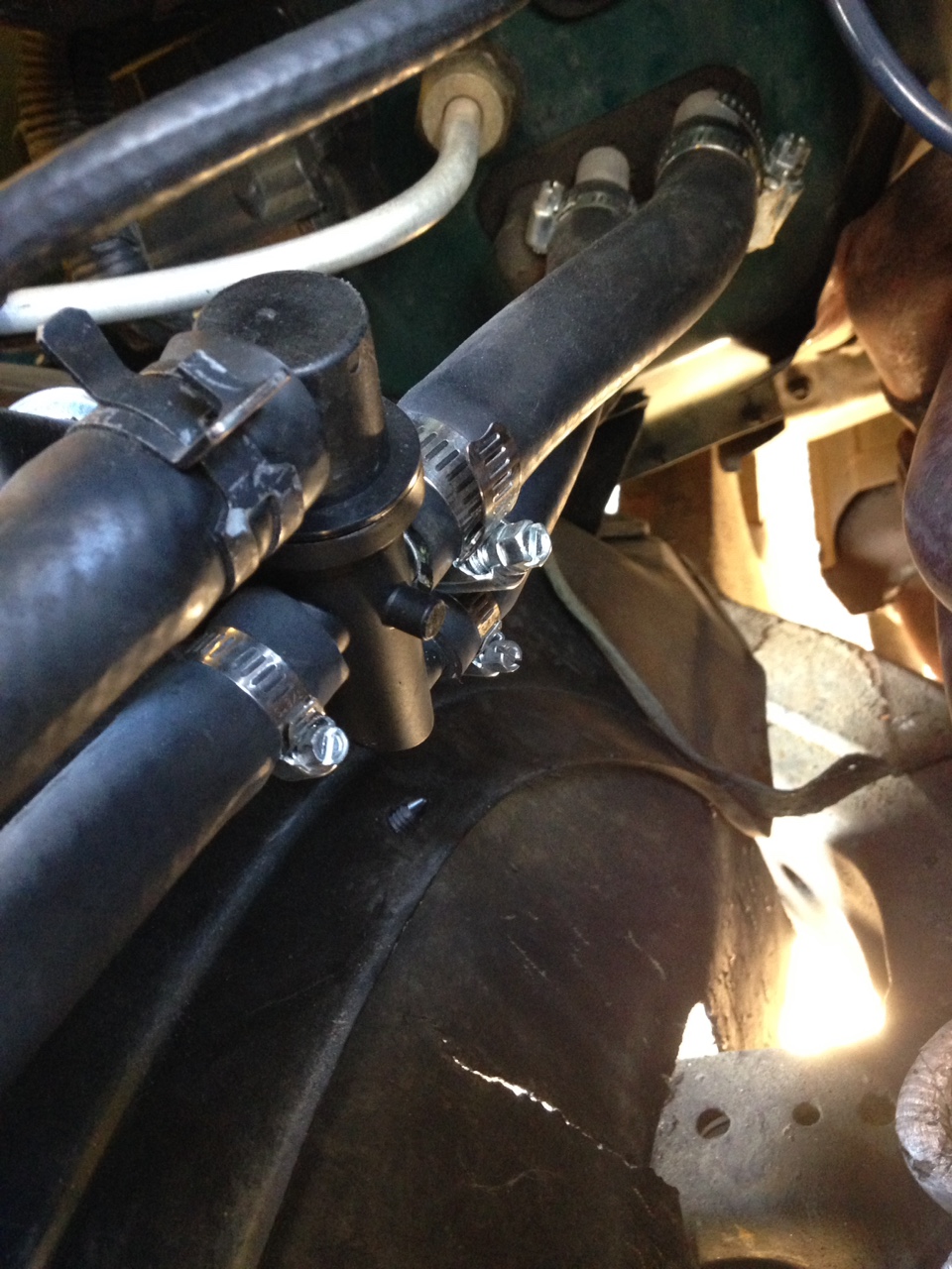

I'm getting flow through my heat control valve and the lines to and from my heater core, all lines are NOT clogged. I ran through all of them and then properly burped the system. All lines get hot.

Up and down stream of the heater valve are roughly the same temperature, they get to around 98 degrees (By lazer thermostat testing). hand feel they feel roughly the same temp aswell.
-The plunger on the heater valve is fully extended down
-The plunger does move freely with the ignition off, it does not move at all unless it is on max cool.

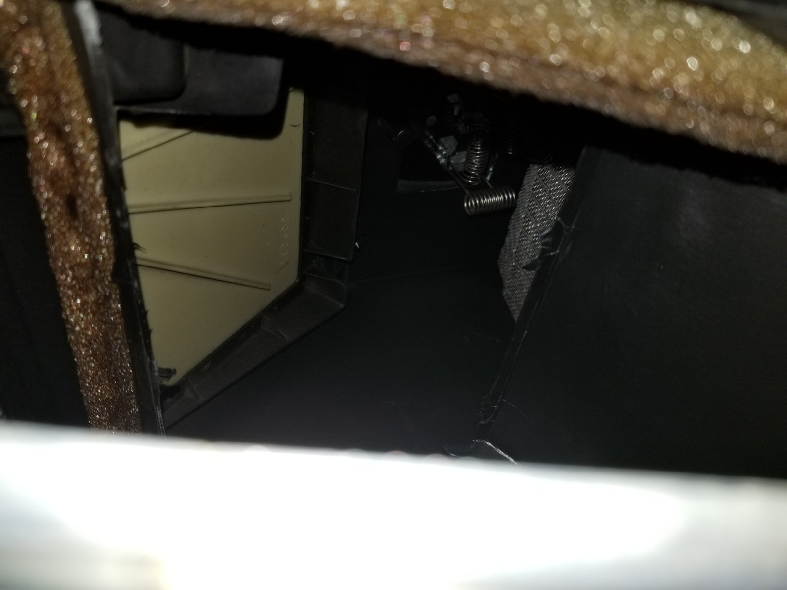

Just to make sure that I read this right...so you have the bottom cover removed and can feel the core. It's hot when the blower is off. As soon as the blower is turned on, the actual heater core surface temperature drops to ambient or thereabouts? Is that what is happening?
The only damper that brings in outside air is the recirculation, located above the blower.

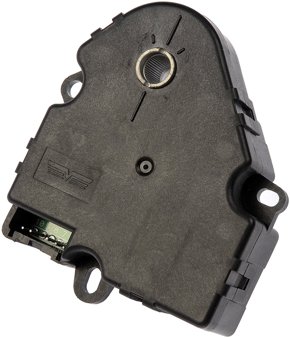

Can you verify that the temperature actuator is turning? The silver dial should rotate approximately 90-degrees from one end to the other.

Yes, i currently have the bottom cover removed exposing the heater core. When the blower is off, it begins to warm up. after I rev the engine for a minute or two it will get extremely hot, but once the blower is put on it cools it off completely within seconds (Keep in mind it is about 5 degrees here, but i still dont see how it could possibly cool it off THAT fast).

I will have to double check the actuator, i can remove the glove box and see it pretty easily. Do you have a diagram for where the notch on the actuator should be at each position?

I've never opened up the heater core portion of the box, so I don't know, but can you see the air door in it? I guess blowing 5-degree air over it would cool it down, but I would think that it needs the cover installed to warm the air?
I don't know which dial position corresponds to full cold and which is full hot, but it has to be one for each extreme. There should be small indicator lines in the plastic.
