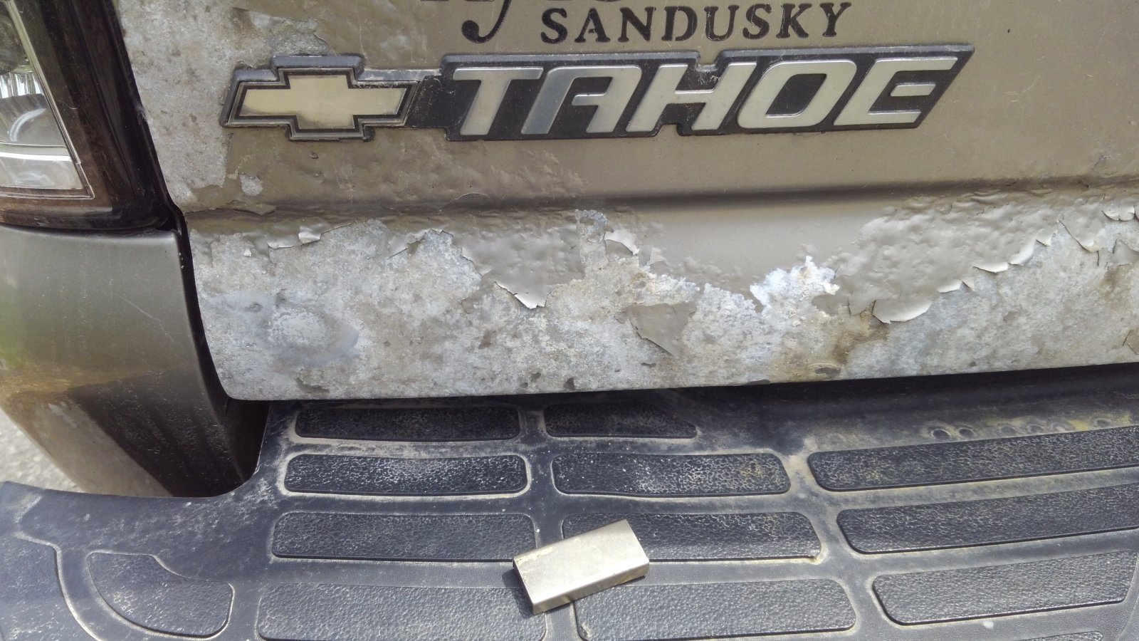

Uh, yea..... nice patina ( tail gate pic)
Doesn't look like the paint failed on it's own, but corrosion / salt damage.
But you know the whole truck, and what the rest of the lower body/ underside looks like.

Years ago I painted a '65 Triumph 650 to look like a rat bike!
Paint job looked like the paint was peeling and rusting.

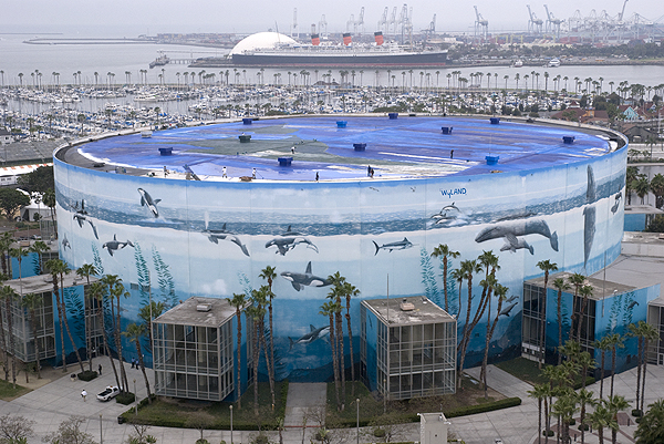

Murals are a different sort of technique.... Art on your living room wall is usually a "10 foot rule" to observe the work.
Some murals are a 100-300 foot rule. Too much detail & the detail looks like a blob from the distance.
I was Paint Coordinator / Background "ocean-water" airless painter, on this 7,500 gallons of paint, 145,000 squ. ft. piece.
( Wyland Whale Mural #33 Long Beach, Calif. 1992 )

Your tail gate will be like new due to stripping it down to all metal / bring it back up to finish coat.
( staying on topic)....
Yep. Using the proper primer to start would have helped avoid this issue.
I'll use a good epoxy after proper cleaning/sanding/etching and such.

That's what happens when the aluminum oxidizes, that's "rust", just like when metal oxidizes, it rusts. That's aluminum rust--it gets powder like.
Probably a sort of self-etching primer to start the 1st coat....
Hmmm..... I didn't think "boat corrosion" verses a steel panel.
Maybe attach a zinc to the body.. Ha..
I wonder what will start to happen to all those aluminum Fords??
They'll turn to dust.

Not sure about a zinc primer. Depends on how the 2 metals react. Zinc primers are great on steel though.

Opps you misunderstood..... The zink was a joke about boats using a zink to avoid electrolysis / anti aluminum decay......( or as tonyrods says, " Turning to dust" )
The self-etching primer is for metals like aluminum or titanium for bonding before primers.
