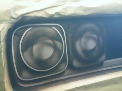

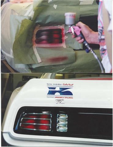

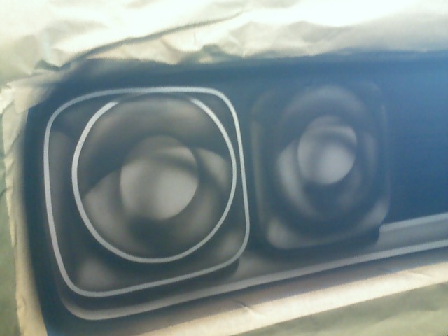

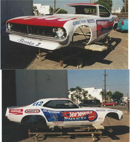

Jeff G.... As you probably know there are many tricks to achieve your painting finish.

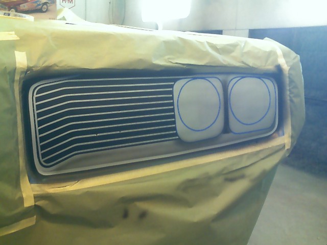

As you have access to a decal cutter, you could 'dye-cut' a word or letters you can then paint inside the space then remove the decal then brush the edges ( Or air brush).... ( Vintage "Tahoe?")
( On the Snake II body I painted the 'Coca Cola' & 'Wynns' logos easily by brushing inside the decal. Then I removed the decal.)

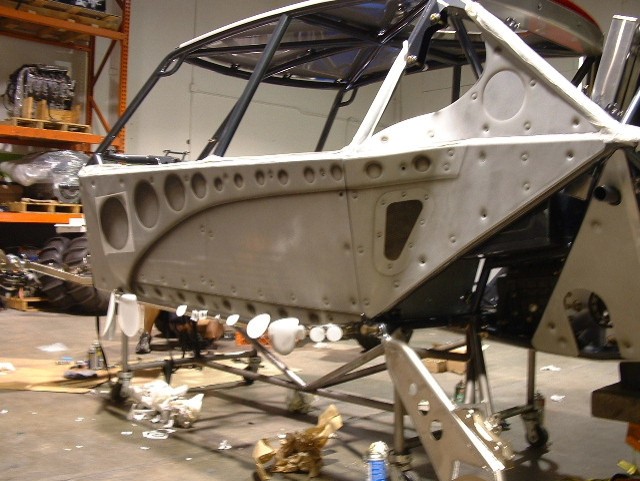

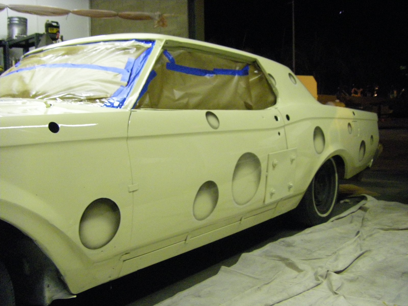

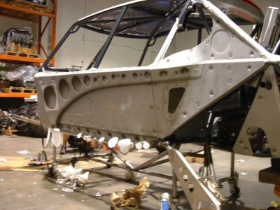

I used dye-cut 'circles' to guide me as I air brushed the " swiss cheese" holes on a demolition derby car. ( I learned, by watching my friend air brush an off road beast ( ALL of the buggy sides are completely smooth - all effects are air brushed!! All of it !! ( Rivets, paneling w/ holes & everything air brushed !! ) ... Notice the decal "circles" at bottom of buggy, as I used them to stick on during air brushing, inside/outside of fake holes for shading while spraying.
The buggy was air brushed with a flat paint, then the gloss finish made it "pop".
Talk to a good decal guy... He will know what decal material will handle a paint ( Or what kind of paint will safely cover over the material) Decal materials are processed differently. ( Unless your decals are only for your letters - then they are removed )
20170203_183946.jpg Cuda Tail 2 .jpg IMGP0514.JPG thumbnail_Airbrush holes 2.jpg

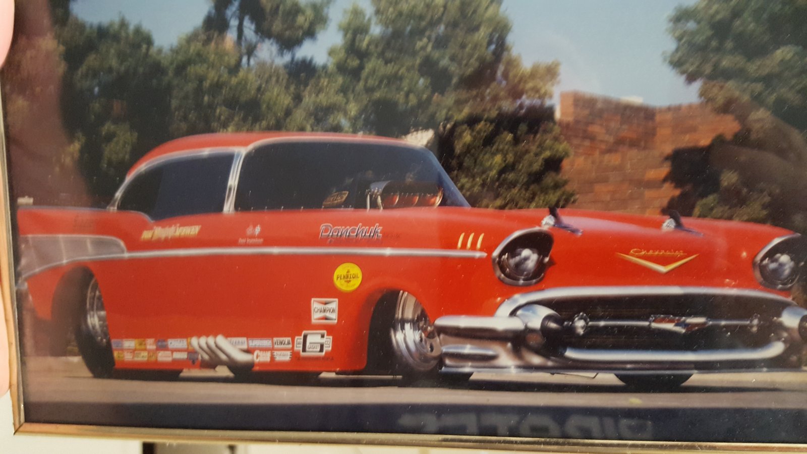

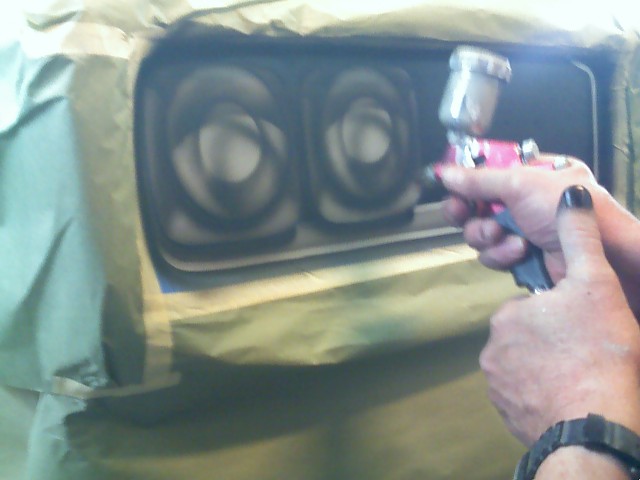

Yea, it's fun stuff !! I have a classic air brush ( from Coast Airbrush, Huntington Beach, Ca), and a wonderful Sata gravity feed airbrush ( same as on pic of 'Cuda tail light job)...
My airbrush friend?...... ( Google him).... Kenny Youngblood aka "Blood Did It". He taught me a lot. ( '57 - Mongoo$e .. ALL airbrush, inc, all chrome, lights, etc. )

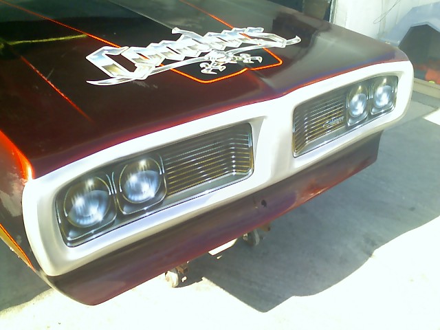

Being a close friend to "Bleeder" for almost 30 years, it is quite a treat to watch him do his magic!
I took photos & did the masking before airbrushing.
I was at his studio when Kenny received a call from the "PCG3 Group".. ( Pete Chapurie ) (sp?)
A custom car hot rod shop in L.A. When a rock band was getting a RED Ford coup built there, and they needed a "Youngblood stripe" design on it..... Kenny created the design, after asking the name of the unknown band........and the rest is history...
ZZ Top (Band logo, came from Kenny's stripe design).
