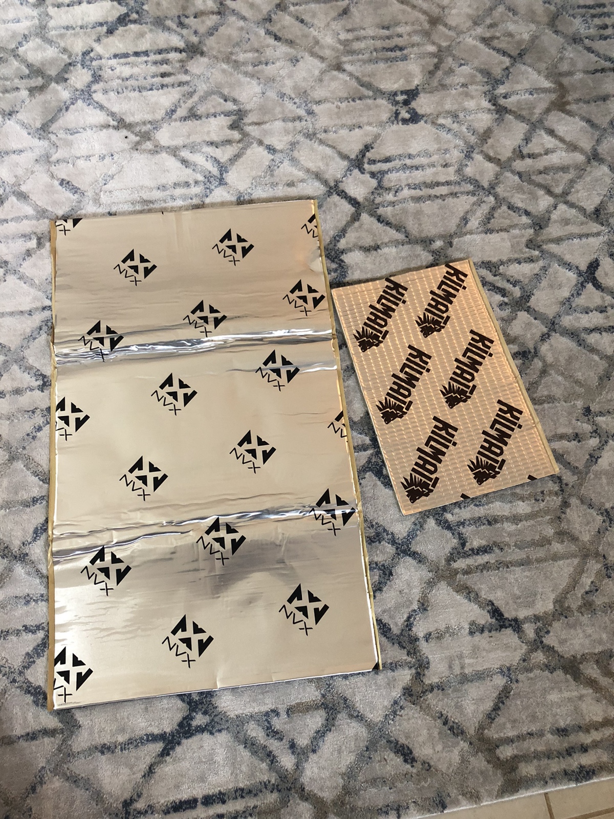

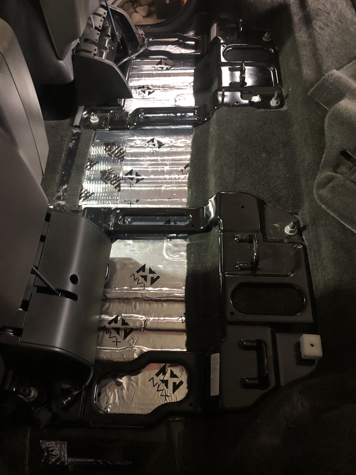

I had zero intentions of doing this but corona and a ton of old sound deadening material laying around lead me to it.
85% of all flooring behind the front seats is now covered in Kilmat or NVS butyl based sound deadening. The NVS is .87 mil thick vs. the .80 mill of Kilmat, the NVS has a much heavier feel to it. I used both just depending on how easy the area was to access, the only carpet that was fully removed was the center piece that goes under and between the rear captains chairs. This was my first time installing it on one of these and I didn’t want to risk pulling the carpet and fight myself trying to re install. Took just over 3 hours to do everything. I could probly cut an hour off that if I had to do it again.
Next up will be the rear cargo door and maybe the door panels if corona depression really sits in.
Kilmat is the smaller sheet and NVS the larger.

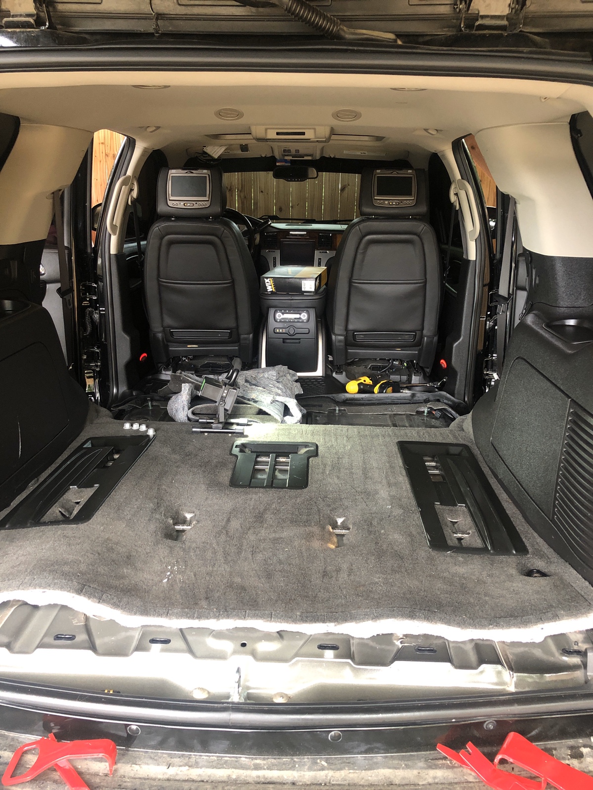

After my last post I immediately went outside and did the cargo door and driver side wheel well where the air pump is located.
Drove around and there might be a slight decrease in some of the deeper tones.

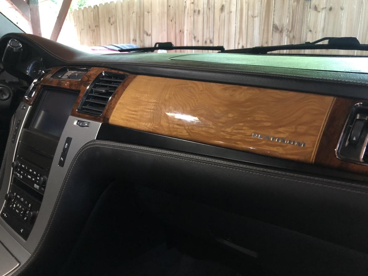

Also working on some viynl pieces. So far I’ve removed the plastidip on the window chrome accent pieces and replaced it with viynl. Still need to do the door guards and then the interior. I decided to go with a satin black for the interior pieces. Everything that’s silver in this pic will eventually be wrapped. Curious to see how it turns out.

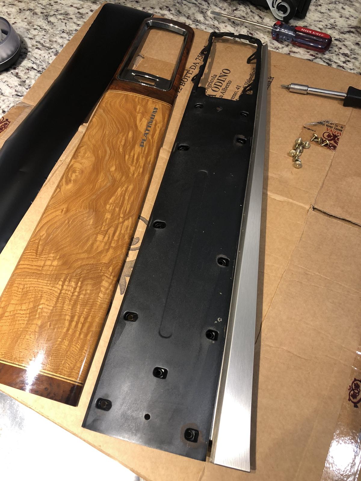

The satin black wrap showed up earlier than expected. Went ahead and got started earlier. Knocked out the first panel, removed the second, and quickly realized the film was a little small. Go figure.
Side note. Any model that has the silver vinyl like mine with ridges, they will still be noticeable with a wrap. I don’t mind them so no problem for me.

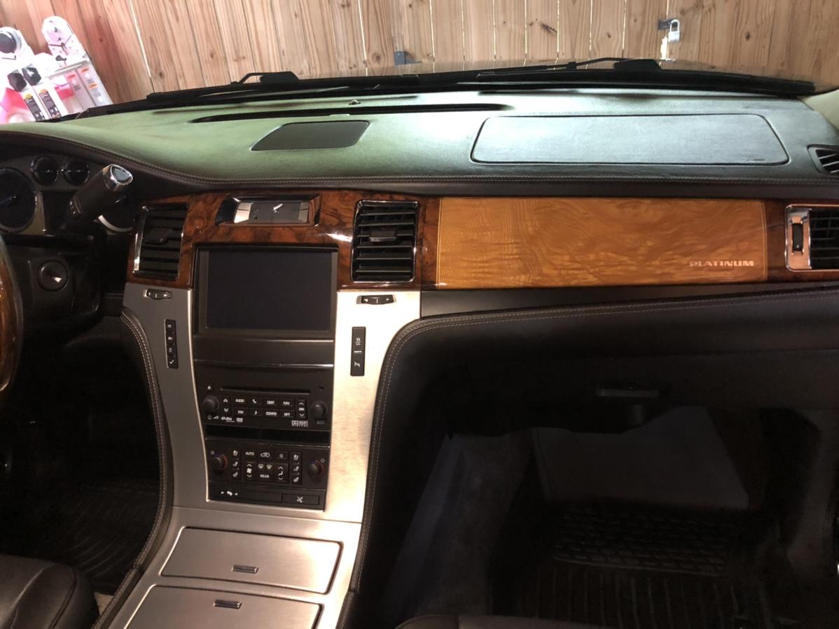

The vinyl on the interior dash is growing on me. Turns out I ordered a larger roll as well but they are shipping it separately. That was over 2 weeks ago when I first ordered. There are a couple section I didn’t realize were wrapped in the factory brushed aluminum, and likely the hardest ones for me to do. My skills will have to improve pretty quickly.
