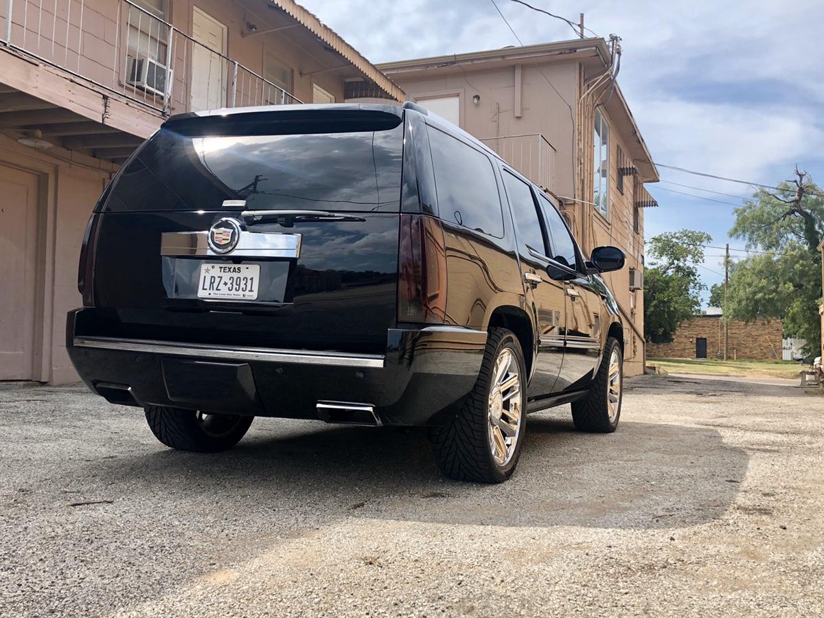

Thems purty
Thanks. Buddy of mine knocked them out of the park. It’s a titanium and glacier black mix.
The front coming in will be quite the welcoming to the neighborhood. Cold starts from day 1.

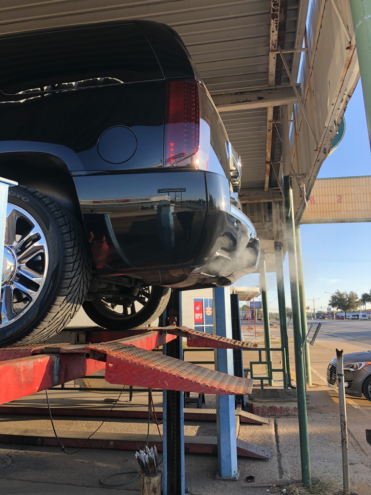

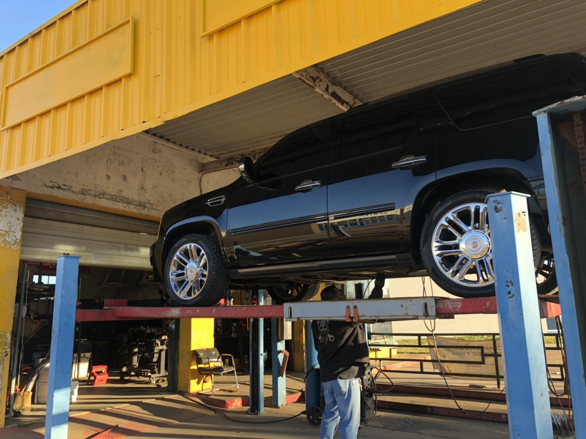

Headers are on and finally leak free from what I can tell. Shop that did the install ****** around and I gave up on it. Ended up taking it to my muffler guy to weld up.
Windshield is back to 35% again, wanted 20 but they didn’t have it in ceramic. Couldn’t pull the trigger on going to 15.
Had a couple issues with the black bear live tuning so I wasn’t able to get that done as hoped. Autocal should be here by the end of the week thankfully. V4 will drive you nuts with long tubes.

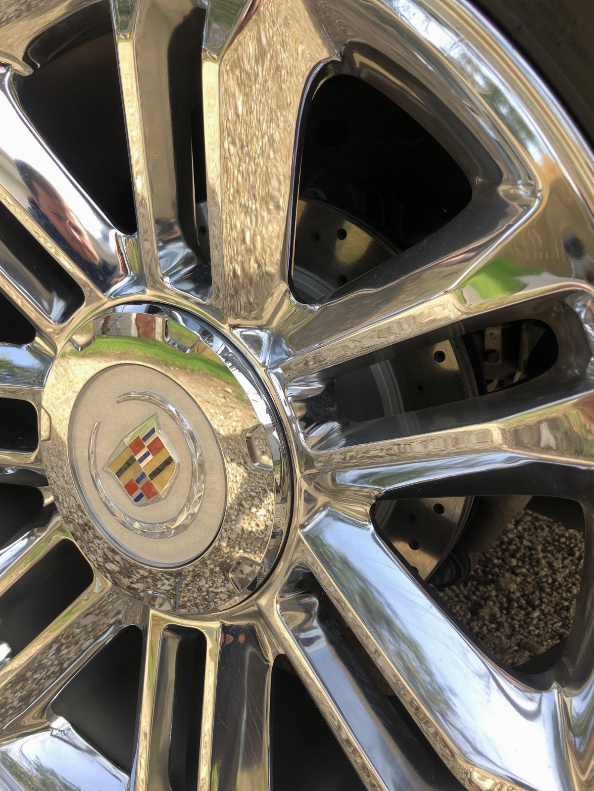

Swapped out the factory pads/rotors for R1 concepts drilled rotors and ceramic pads. No real difference in stopping power. As far as I know they were the original rotors. Just crossed the 164k mark.
Also got the tune back from BlackBear. Engine runs smoother at idle and pulls harder in the middle and upper RPM range. Shifting is close to factory when you are cruising around with slightly higher shift points. When you flat foot it you can really tell a difference in the shifts. Much firmer and no delay between gears. I’m happy so far.
Anyone have a parts list for the rear main seal? That’s next on the list as well as a sensor under the steering wheel, so tired of lights on the dash.

Looks good!
Did you bed in the new pads and rotors?

What’s involved in that? I had a shop do the install.
Just some quick stops. I just swapped the pads in my ‘03 Yukon to some powerstop ceramic carbon fiber pads and did 5 quick stops from 50-55 to about 20. Just barely shy of activating the abs. By the way, very happy with the pads! [emoji106]
Here is a quick search that gives you the basics...
How To Bed In Brake Pads | AutoAnything Resource Center
https://www.autoanything.com/resources/how-to-bed-in-brake-pads/
Basically you want to get the pads and rotors warmed up/hot and get some of the pad material to transfer onto the rotors evenly... keyword being EVENLY.
If you come to a complete stop during the process, like sitting at a red light, it will transfer more pad material onto the spot where your pads are sitting against the rotors and then you will have what many people refer to as "warped rotors".
Bedding them in should make a noticeable difference in performance.

Did you ever get your brakes bedded in and di it make any noticeable difference?
Do you notice any major difference in performance with the headers?
The rush hour traffic I deal with should do the same thing as the process you linked.
Brakes still feel soft though. There is a decent amount of creep in the peddle.
I’ve replaced pads on two previous vehicles and both of those it removed the creep and made them pretty firm. Not sure what the difference is here.
