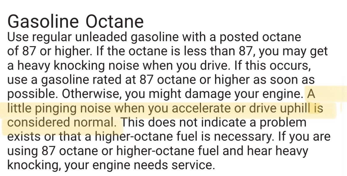

From the owners manual for a 2005 Yukon Denali
Guess GM expects it to do what you’re experiencing.
Might try a higher octane rating and see what happens.

...and somehow I missed that...thanks SO much for the help...I may try 93 octane at next fill up but honestly I've only heard the pinging 3 times in my ownership 1 month/650 miles and only when mashing the gas pedal from about 45/50 MPH getting on the expressway/highway...

No problem.
Looks like another case of RTFM to me. :emotions33:
