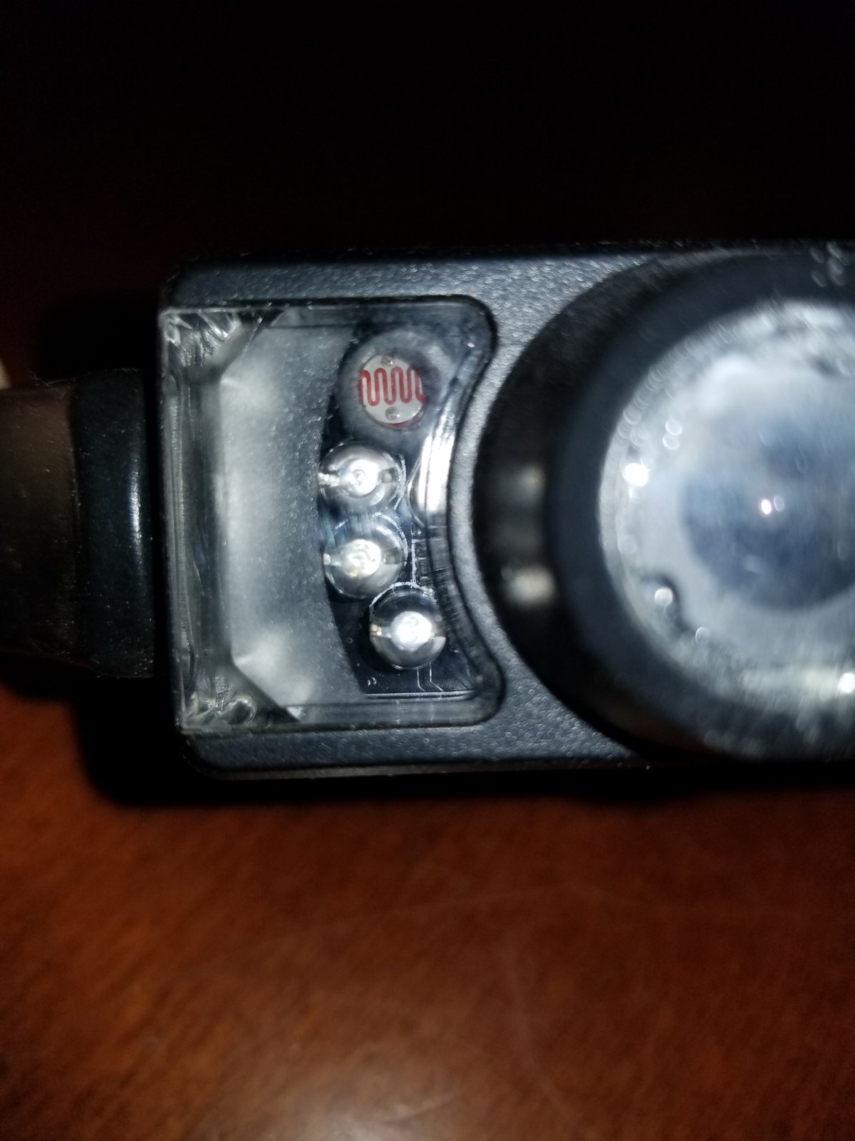

I thought about wiring it up that way, but the my only complaint is that the LED lights that are built in to the camera would always be on as long as the vehicle is on. Not really an "issue", just don't want the lights on at night for instance while driving down the road. I am not sure if it may prohibit a cop from seeing my license plate with 4 LED lights right now to it.

I think they are barely noticable,..but now you have me wondering,... Ill check it out at night.
Yeah, I don't think those are leds, they look like some kind of sensors or something. Just took a pic, maybe they are. The top is a sensor.
