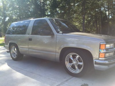

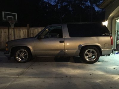

So far I have added 2" shackle out back and 2" belltech drop springs up front. I also added shock extenders and the ride did get better but once i lowered it another 2" it went back to a very stiff ride.
I spoke to fellow 2 wd owner and he is using Western Chassis DS2 shocks, so thats next.
I found that my pinion angle is 3 degrees off, should not be anymore than .5 degrees according to what i have read. I should be getting the shims and installing them today. I know that has something to do with the vibration im getting at 65 mph. I looked at my U joints and the rear one was new but when i took the drive shaft off the u joint was very stiff with a spot that it would take more force to move. I installed anew one and it did help a little with the vibration.
I also bought 235/55 Nitto 421s and got rid of the 255/50 Bridgestone's. They were the wrong weight rating for the truck and also too small IMO

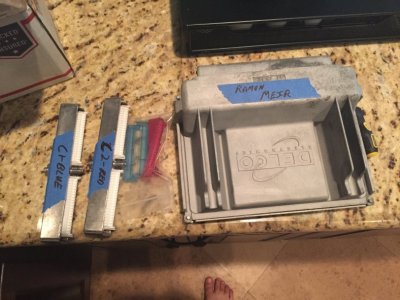

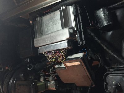

Small update to the ole hoe!
Did the Lextech PCM swap and went smooth as could be!!
And a pic with one of my helpers.
