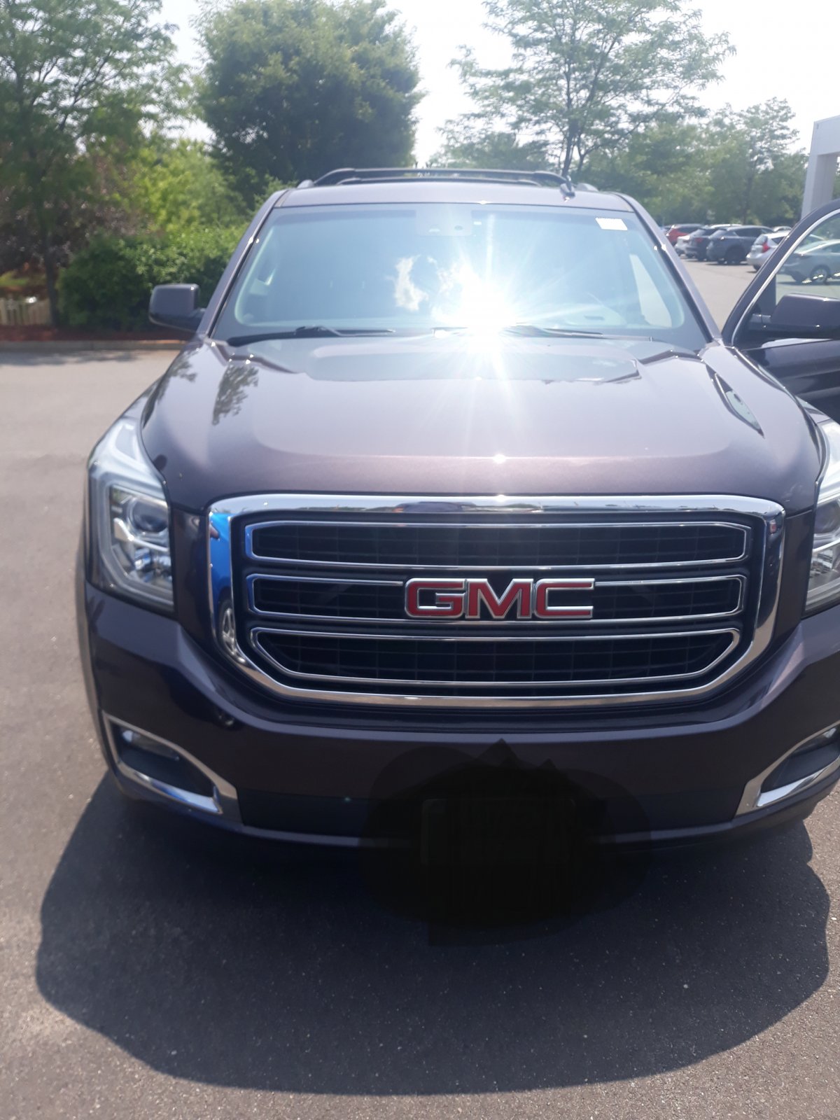

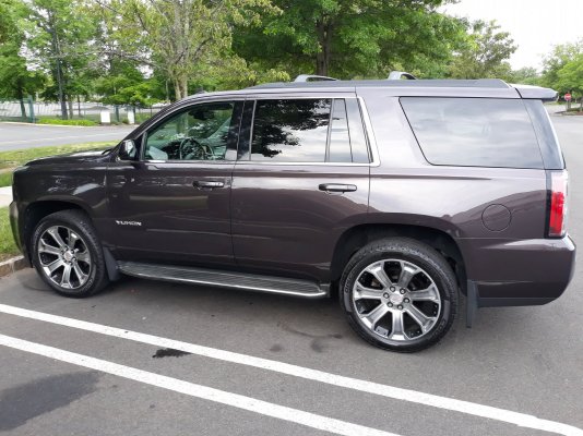

2015 with 97k on it. Good service records, but based on driving and trans temps, no transmission thermostat change happened so I expect no other precautionary measures were taken . Does anyone have the part and service bulletin numbers handy? Plan to change to a Denali grill and 20 inch rims. Hope she serves me as well as my 99 has and my 2009 did. Pardon my photo skills, I'll get better lol 20230625_200347.jpg20230619_122506.jpg

Looks to be in excellent condition and very well maintained. Love the color. Glad you have service records.
