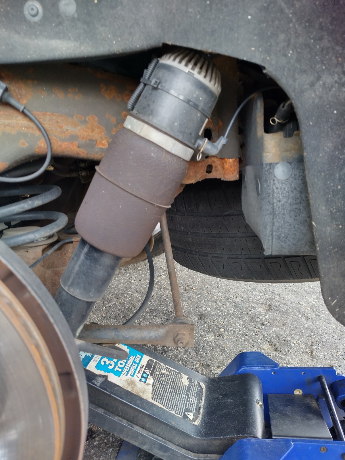

Finished 1st road trip of 1600 miles and only hiccup was a nail in my tire :( at top of sidewall 400 miles in. 1st shop in VA said they couldn't fix it due to location of the nail. Mapped a truck tire repair shop and dude said he'd patch with no guarantee. Had to put air every 12 hours but it held. Doing the speed limit was good on gas lol. Confused about my suspension though. Anyone know what this set up is? 20230928_205519.jpg20230928_205052.jpgIMG_20230925_132819_HDR.jpg

Finished 1st road trip of 1600 miles and only hiccup was a nail in my tire :( at top of sidewall 400 miles in. 1st shop in VA said they couldn't fix it due to location of the nail. Mapped a truck tire repair shop and dude said he'd patch with no guarantee. Had to put air every 12 hours but it held. Doing the speed limit was good on gas lol. Confused about my suspension though. Anyone know what this set up is? View attachment 410030View attachment 410031View attachment 410032
Those are some kind of Arnott replacements for rear auto level - they look just like the 2007-14 Autoride versions. SLEs did not get Magnaride, but some Arnott replacements work for both. Do you have a compressor in back? A lot of Arnotts look the same...
I'll check for it this weekend when I take the wheel back off. Replacement tire came in, covered by roadside assistance so I found out, and will get it mounted and balanced then. Thanks
