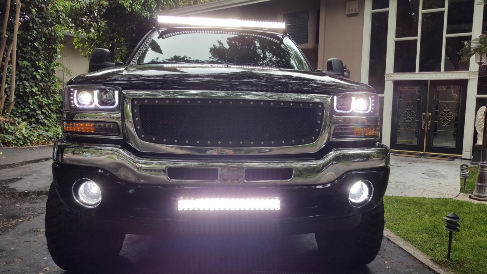

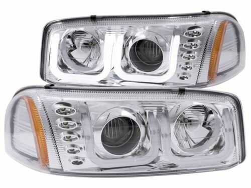

Looking at this photo, I think some nice black projectors would look nice with that paint job.
Perhaps something like this:
I'm thinking about getting a set for my truck, but in chrome.
i been looking at these more than once now. hmm, what brand are these. they do have a evil kind of look to them
