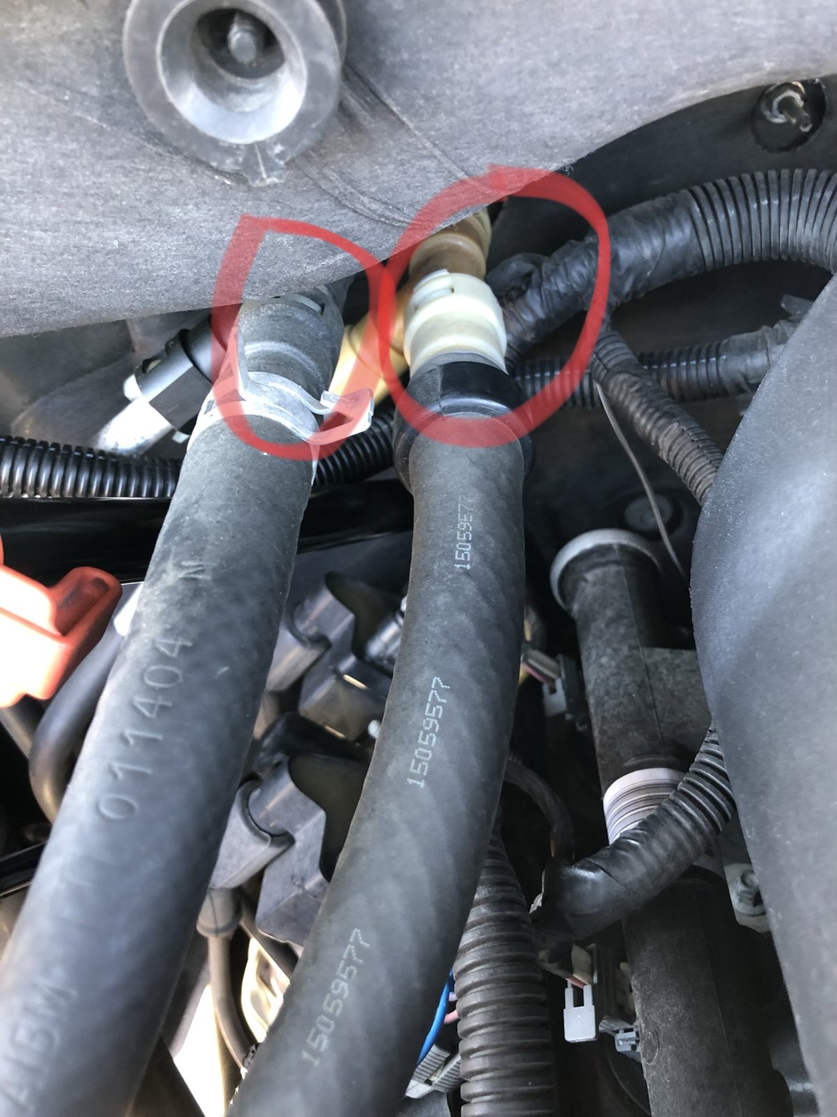

I have been looking on here and cannot seem to find a part number for the quick connect piece that attached to the heater hose (ill post a pic)
I have the T fittings - Dorman 800-414 and 800-413
While Im doing this replacement I want to replace the piece that attached to the T fitting and slides into the heater hose
I have read a lot that the part is Dorman 800-403 This part does not fit the T connection....not even close. The Gates quick-lok part # 28500 appears to but not sure if it will work.
I would appreciate any help and direction here....
Does anyone know if you buy the heater hoses if they come with the connection already attached? Either way I would like to pry out the old piece in the hoses I have and install new.
Appreciate any help

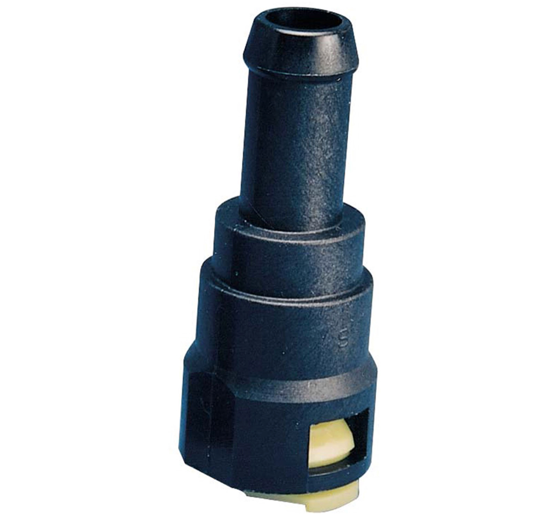

Quick sanity check: Are the fittings you used barbed?
Last time I dealt with those, they were smooth. Not great for holding pressure
The Gates fittings look like this. Everything buttoned up real nice. The right side(white plastic) had a different molded fitting in the hose, the black side uses a hose clamp.
